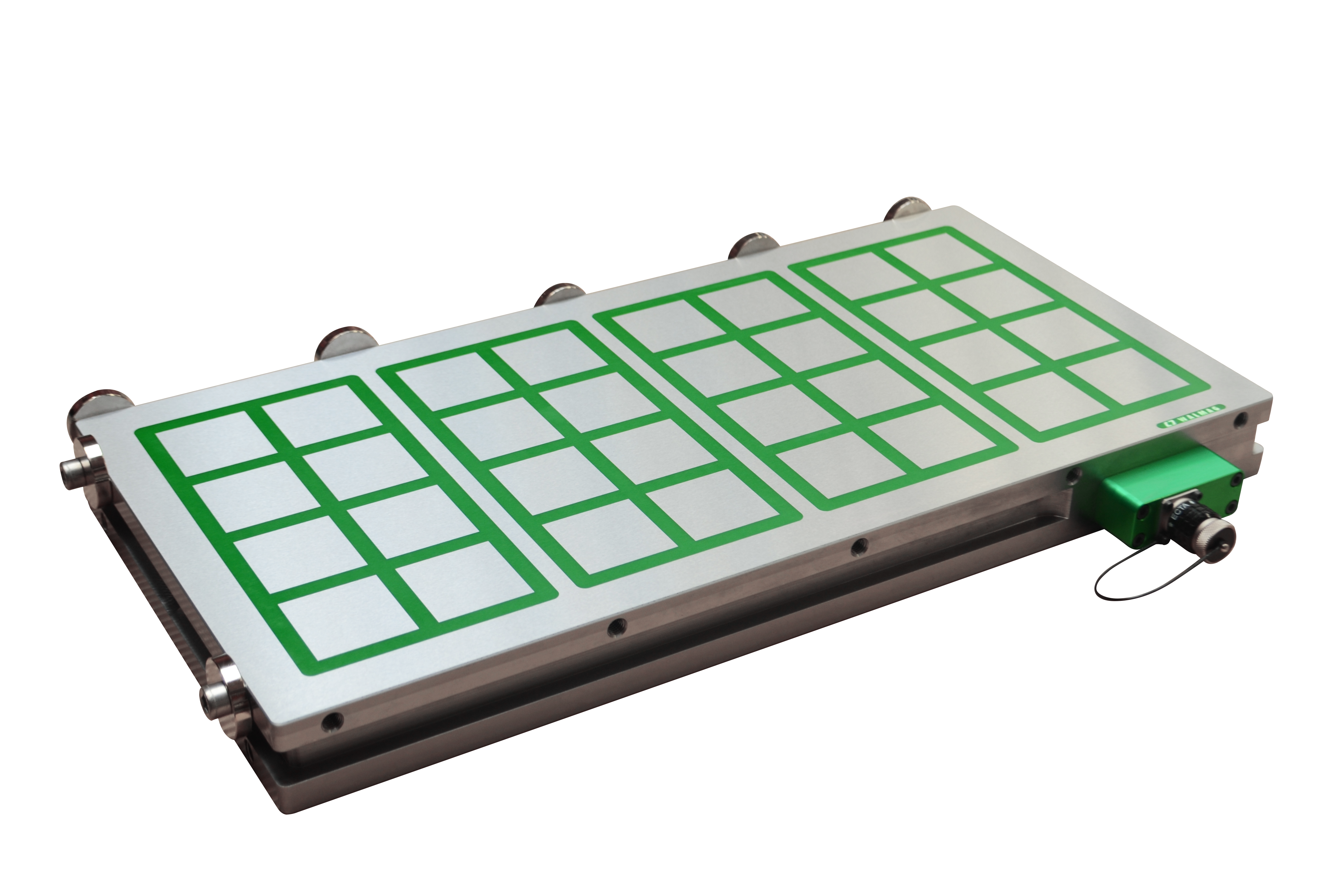

Interest that will, no doubt, be increased further with the Walmag Mastermill. An electromagnetic permanent magnet, Mastermill offers a flexible solution for a variety of workholding applications. The top face is produced from a homogenous single piece of steel so there is no chance of swarf or coolant ingress into the electronics of the chuck. Designed with a recess so the chuck can be clamped down onto the table of the machine tool. The chuck can also be drilled through to at designated points to allow it to be bolted directly to the worktable or to a pallet changing system with M12 bolts. Pole extensions can be placed on the surface, which is important if there is a long batch, or for five-sided machining operations using simultaneous 5-axis or 3+2 positional milling techniques.
The company’s Neomill Compact is a permanent magnetic chuck for milling operations. Ranging from 250 x 150 x 50 mm up to 600 x 300 x 60 mm (L x W x H) it features the strongest permanent magnetic field in the range with a holding force of 160 N/cm2. Although very rigid, remaining flat and stable under heavy machining loads, the Neomill Compact is designed to be light to handle and lower in construction to minimise the impact on the machine’s Z-axis travel. Again, the top face is a single piece of steel that is water-proof, and it can be pocketed by machining. Up to 10 mm of top face can be machined so raw material recesses can be created and any accidental damage can be removed to revive the plate, with a visible indicator to advice when the limit is being reached.

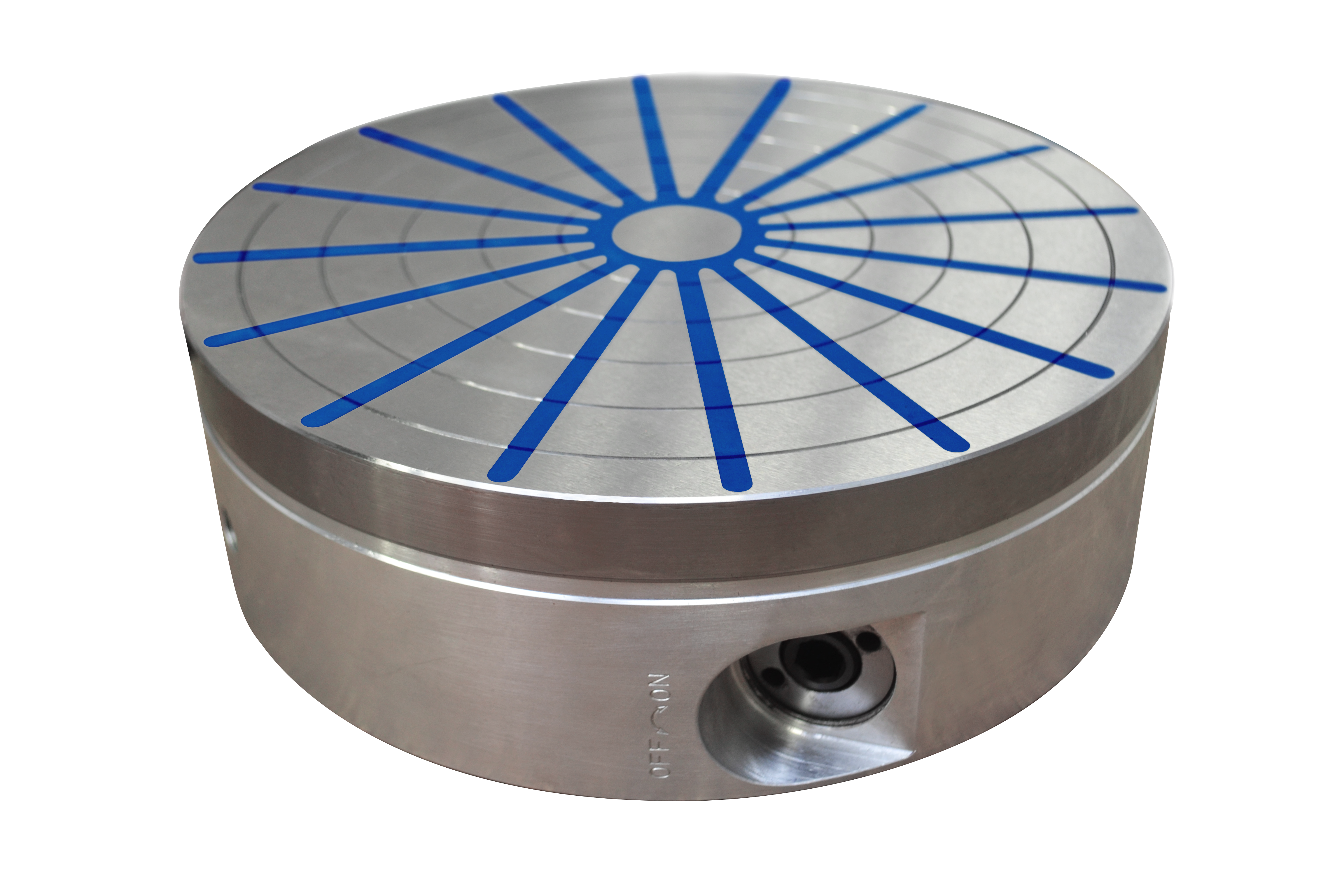

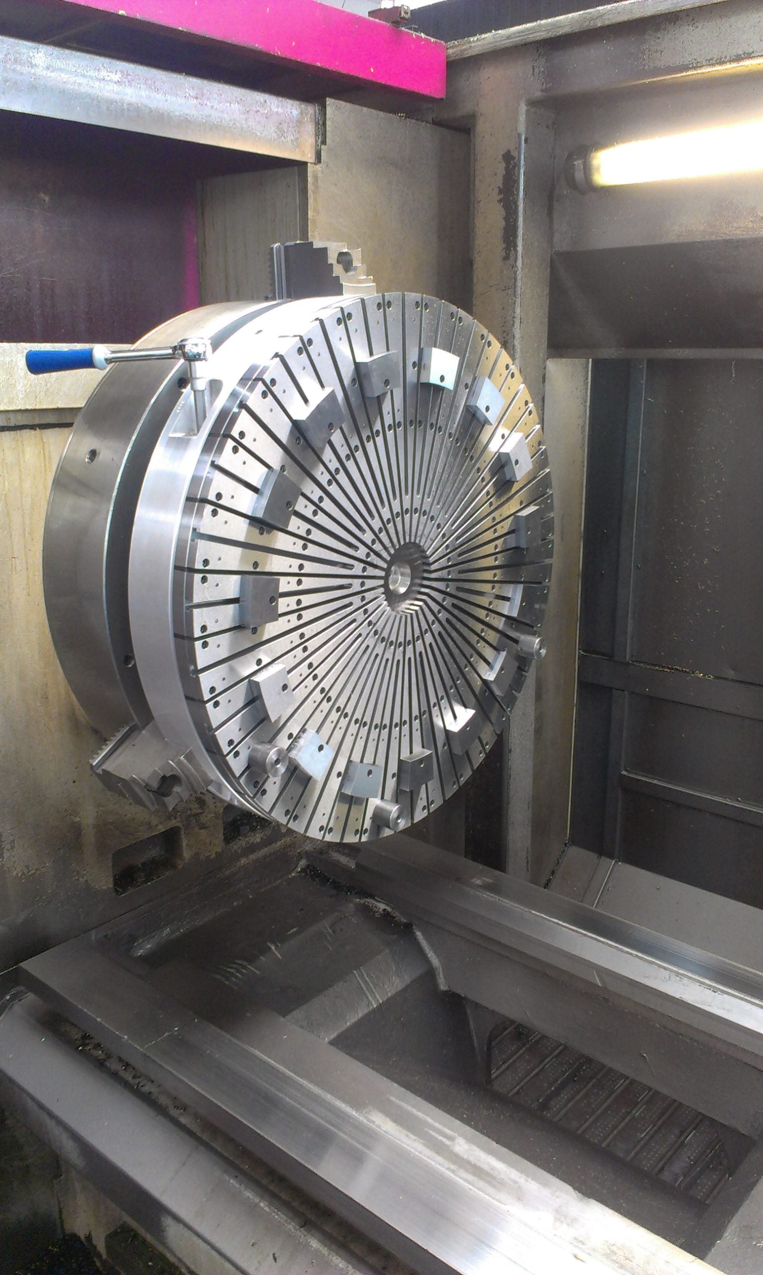

For turning applications the Neostar provides a magnetic solution and is available from 130 mm to 800 mm diameter. A robust electro-permanent magnetic chuck that is circular in design, milled from a single piece the top plate it has no lamellas and is fitted with radial poles using a double high energy Neodymium magnetic system. A 5 mm machinable top plate allows location recesses or spigots to be created or damage to be machined off. With a holding force of up to 140 N/cm2 it is said to be ideal for turning and grinding, within the same set up users can carry out ID, OD and top face work. And, as with all Walmag solutions, it achieves fast clamping with no deformation of the workpiece.
Produced with an aluminium body the Alustar range is lighter, and also features a bespoke worm gear activation system. This allows the chuck to vary the clamping force, so users can set up and true the workpiece using 10 to 20 per cent of the holding force before applying full clamping power when the part is set correctly. These chucks are available in diameters from 200 to 600 mm.
