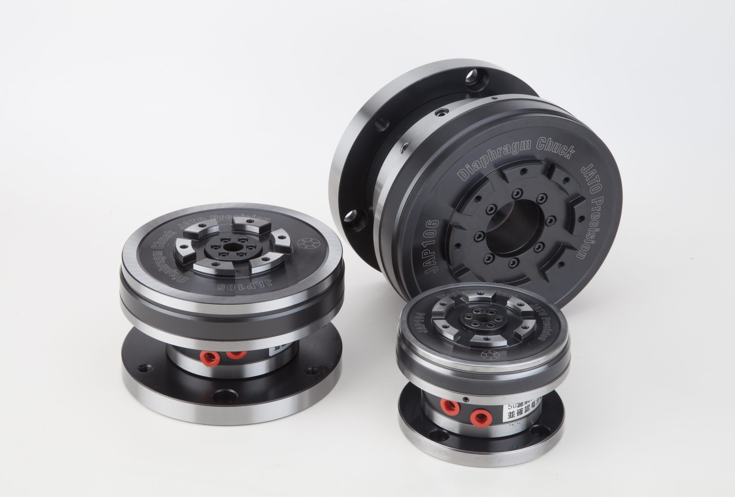

  • Why is a diaphragm chuck preferred over a standard three-jaw or pull-down chuck for gear turning?
    The two major advantages of a diaphragm chuck are accuracy and consistency of the clamping force. Since there are no sliding parts in the diaphragm chuck, the accuracy is directly related to the consistent deformation of the diaphragm. This chuck relies completely on the diaphragm for opening and closing of the jaws. In a standard chuck there is a compound tolerance accumulation between the wedge, master jaws, and the chuck body. The centring accuracy of the diaphragm chuck is very important to gear clamping. The diaphragm chuck maintains the concentric relationship between the pitch line of the tooth form and the machined centre bore. The diaphragm creates another great advantage in maintaining consistent clamping force. The absence of sliding parts means diaphragm chucks need no lubrication. Standard chucks gradually lose gripping force between lubrications. The grip force for standard chucks is constantly changing, creating varying dynamic conditions. Diaphragm chucks eliminate this problem by relying on the elasticity of the diaphragm.

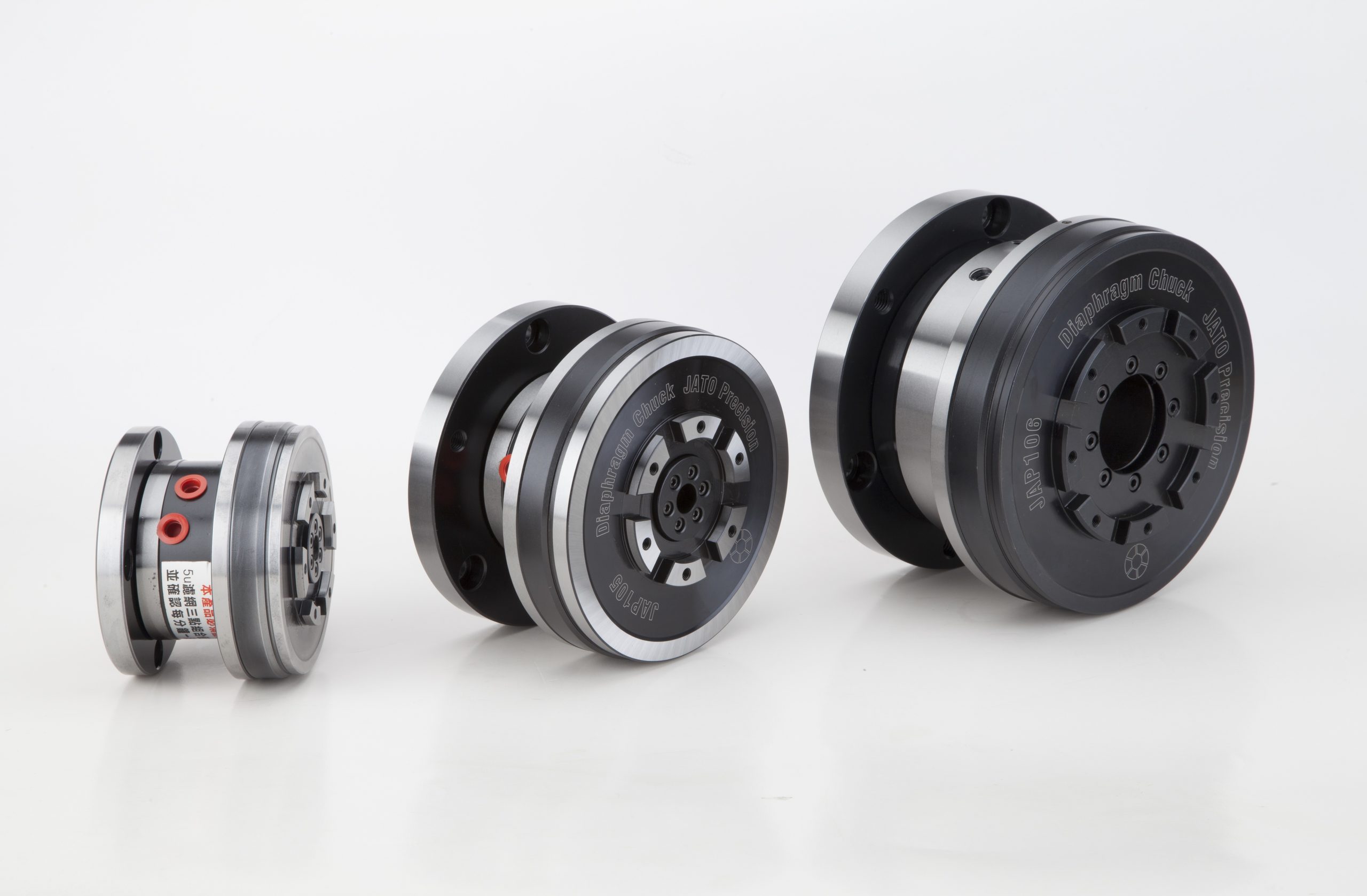

  • Why actuate the chuck with an external cylinder?
    Most diaphragm chucks are self-contained front actuated, using a pneumatic cylinder for opening the chuck and releasing the workpiece. Clamping is accomplished by the spring action of the diaphragm. Among the features of the diaphragm chuck are relatively low gripping force and very small jaw movement. When using an external cylinder, it is a simple matter to apply a slight extra pull on the diaphragm to increase the gripping force when, for example, turning very hard materials where high tool forces are applied against the workpiece. This additional gripping force is not possible when using a self-contained chuck.
