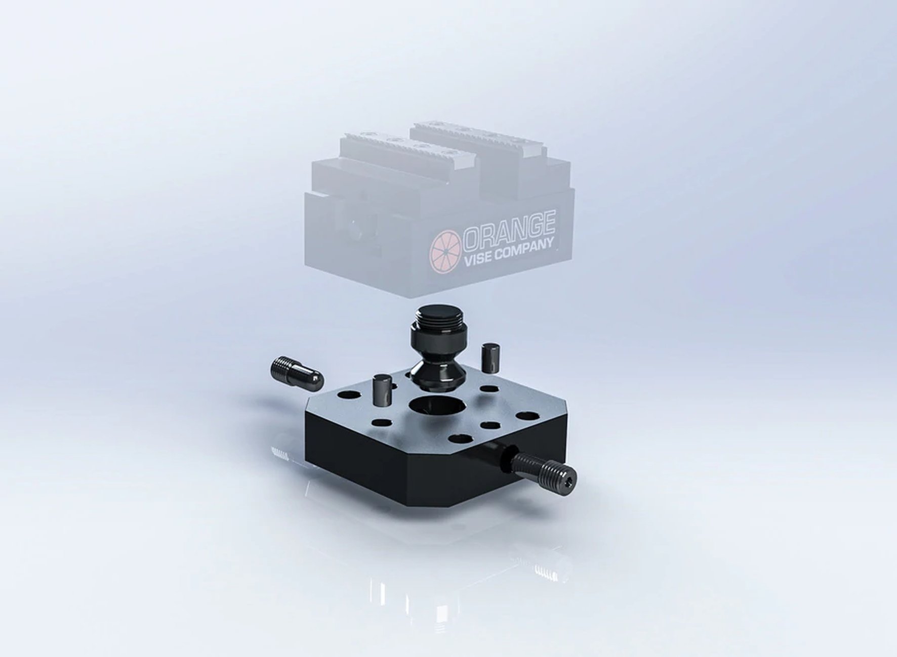

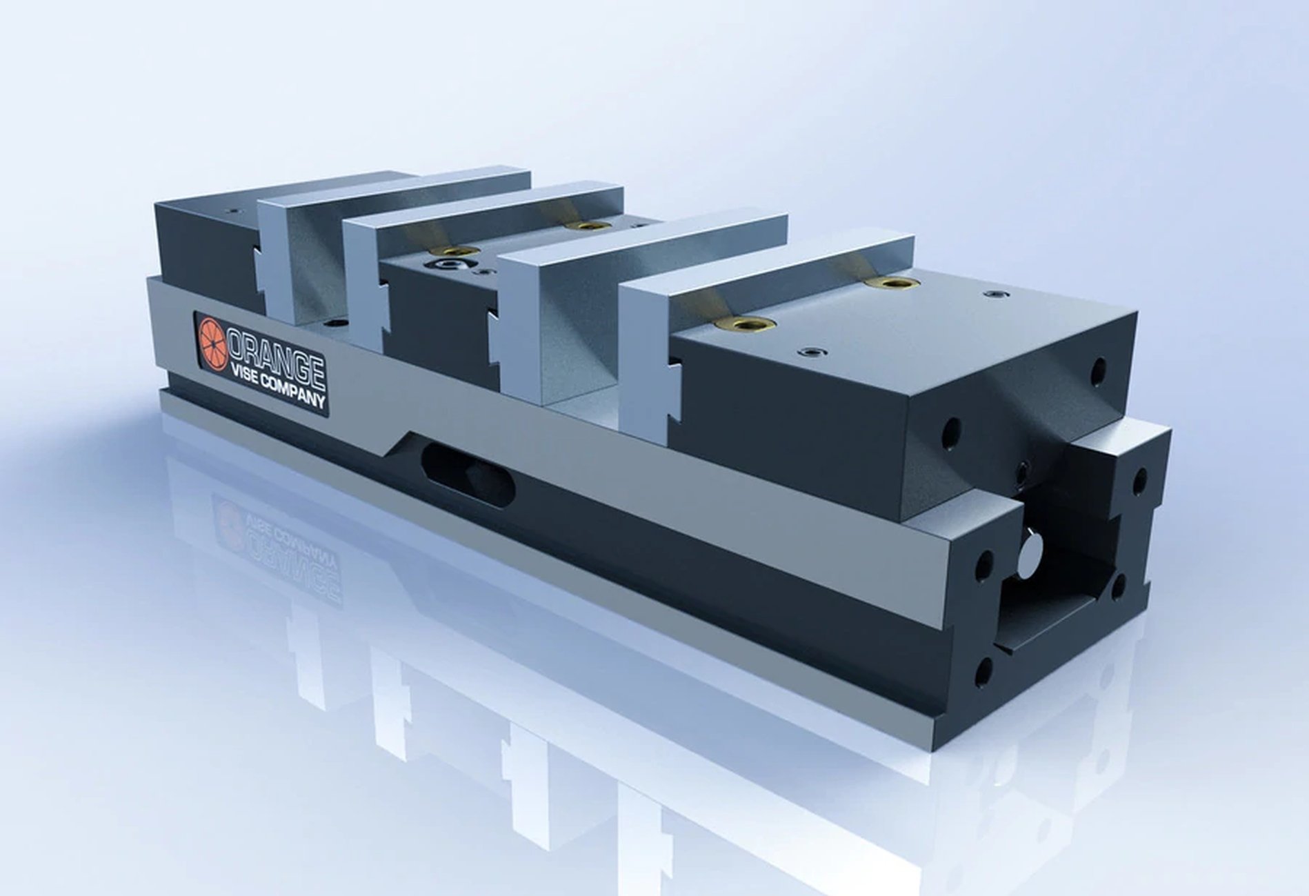

The ‘Quick Change’ concept is integrated in every machining vice design offered by Orange. These include 6 inch single and dual station vices in various lengths, and the Delta IV range in 4 by 6, 4 by 7.5 and 4 by 9 inch sizes. An integrated interface allows the vice body to be mounted to a subplate or tombstone in seconds, with +/- 12 micron repeatability using the optional Orange ball couplers and receivers. The carrier slide assembly can be removed or installed in seconds for cleaning and setup changeovers. Master jaws and jaw plates can also be removed or installed in seconds, with the same +/- 12 micron repeatability.
Supporting increased loading and unloading efficiency is the Twin Delta vice pallet, whereby a set of special master jaws can be fitted to the vice to allow an aluminium pallet to be quickly loaded or unloaded while the vice remains bolted to the worktable or machine bed. A vee form dovetail interface between the master jaws and the pallet provide a robust and accurate location that naturally self-centres to within 12 micron. The aluminium pallet can be adapted to any fixturing method, such as being machined with location pockets for workpieces. Using two pallets set for Op1 and Op2 would allow any machine shop to keep the machines spindles running much longer as the parts can be preset offline.

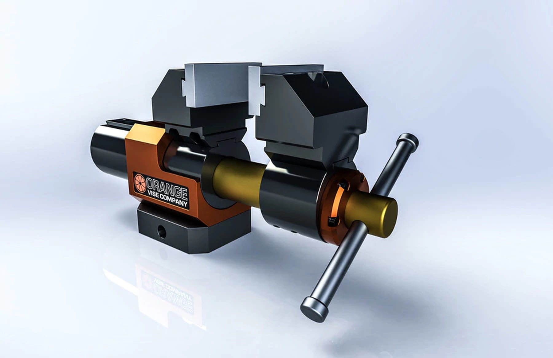

Orange’s latest bench vice is ideal for precision assembly applications, as Mark Jones states: “It should not be used as an anvil, but if your application calls for precision machined jaws formed to fit your parts, with the ability to gradually apply pressure without crushing or scratching the part, the Orange Bench vice is just what you need. See the video of this vice being manufactured and assembled at https://www.youtube.com/watch?v=V-HiX9q0nu8&feature=emb_logo”
This bench vice is designed to apply a linear clamping force based on the position of the handle after a workpiece is gripped. So, an eighth of a turn generates a holding force of 3.3 kN that doubles up 6.6 kN at a quarter turn and progresses all the way to a maximum force of just over 13 kN, limited by the axial load rating of the thrust bearing.

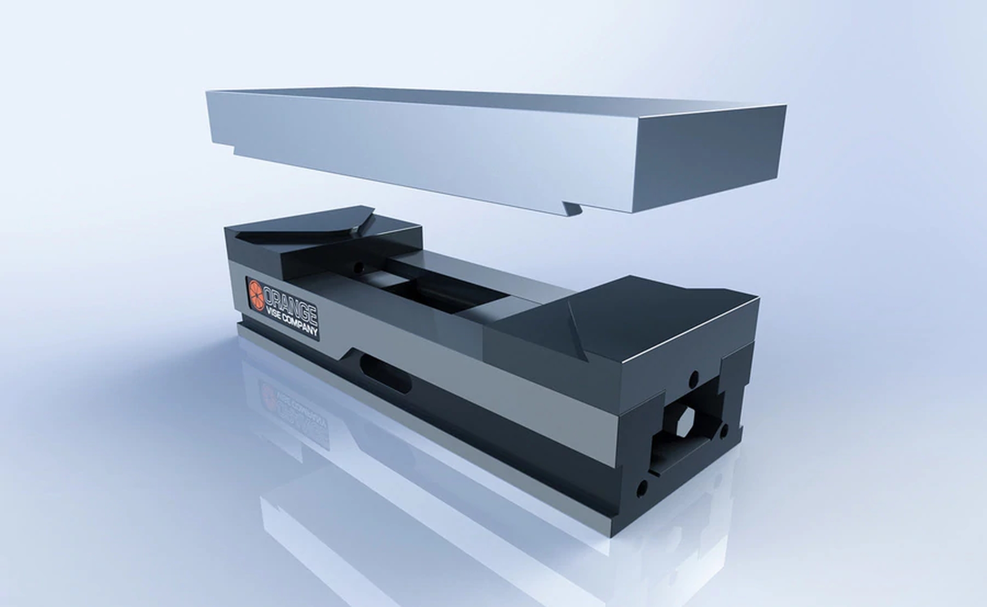

The bench vice uses the same dovetailed jaws as all Orange 3-axis CNC machining vices, making it fully compatible with the US made CARVEsmart quick-change vice jaw system also available from Leader. “CARVEsmart offers a complete dovetailed quick-change vice jaw system and provides a number of benefits. While conventional vices attach the jaws to the face of master jaws via cap screws, the CARVEsmart system uses master jaws with a female dovetail profile designed to accept vice jaws with a male dovetail profile.
“So, the jaws can be front-loaded or slid into the side of the master jaws, that are secured via clamping elements accessible at the top of the master jaws. With no face mounting cap screws to avoid the soft jaw extruded stock is fully machinable, making inexpensive cut to any length vice jaws,” says Mark Jones.

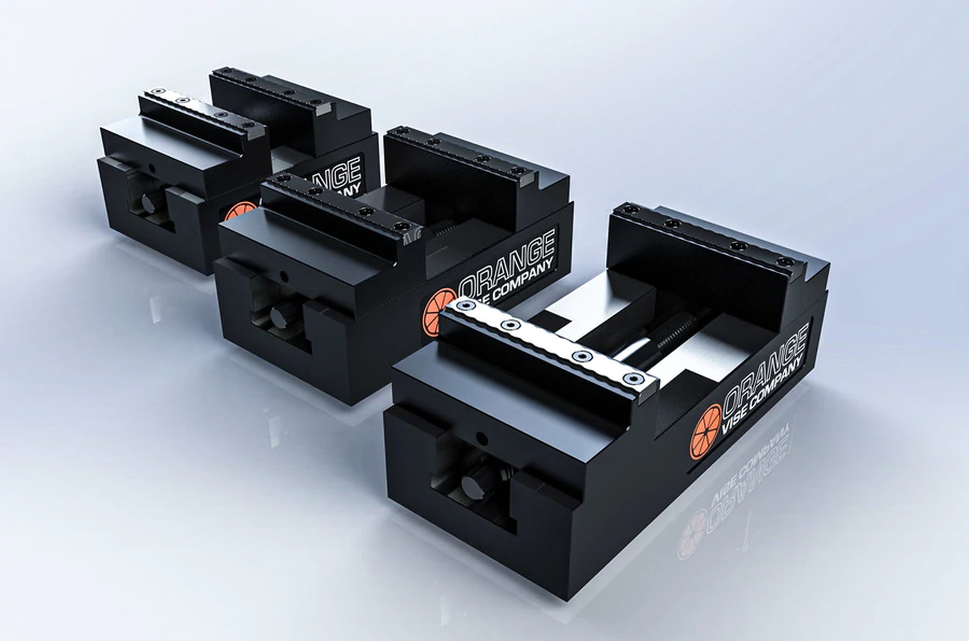

For multi-axis machining applications, the Orange Delta IV vices can be fitted with the Talon Grip jaws to allow Mitee-Bite low profile clamps and part stops to be used. These jaws are able to securely hold raw material or part finished components with as little as 1.5 mm of stock clamped, even during aggressive 4- and 5-axis machining operations.
Improving productivity even further, Orange vices are equipped as standard with the ability to use the company’s new Delta Zero ZPS (Zero Point System) baseplates which feature a Patent-pending, manually actuated zero-point design for +/- 5 micron repeatability. Made of hardened steel, ground on two faces the pallets come in two standard bolt hole patterns with custom patterns available as an option.

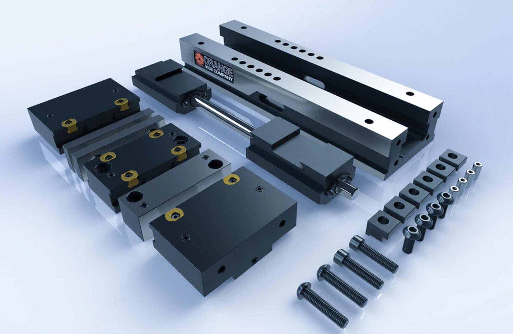

Mark Jones concludes: “Not only do Orange vices offer exceptional precision, flexibility and reliability across the whole range, they also support efficient machine shop operations. Using the Delta Zero ZPS vices can be very quickly exchanged within the working envelope, and each vice can be disassembled in just a couple of minutes for cleaning and maintenance, and quickly re-assembled for minimum downtime. Even the slide assembly can be rebuilt in under 5 minutes with off-the-shelf components and hardware.”
