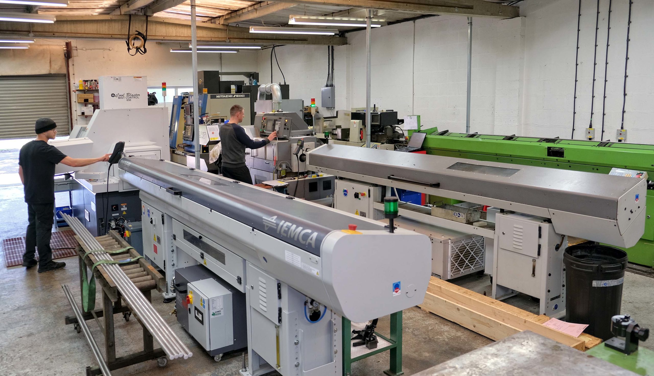

His current CNC capacity includes a vertical machining centre and two fixed-head lathes, all pre-owned, and three Citizen Cincom sliding-head lathes also purchased second-hand due to financial constraints during the start-up phase. His stated aim is to gravitate towards using more of the latter machines to produce complex, small to medium diameter, high added value components, as this is where he sees a profitable future.

Having seen the benefits of more modern sliding-head turning technology, he was keen to harness it for the production of components larger than 16 mm diameter. Accordingly in January 2022 he bought a two-year-old Citizen Cincom L20-VIIILFV, again on the open market, and achieved another step change in productivity.

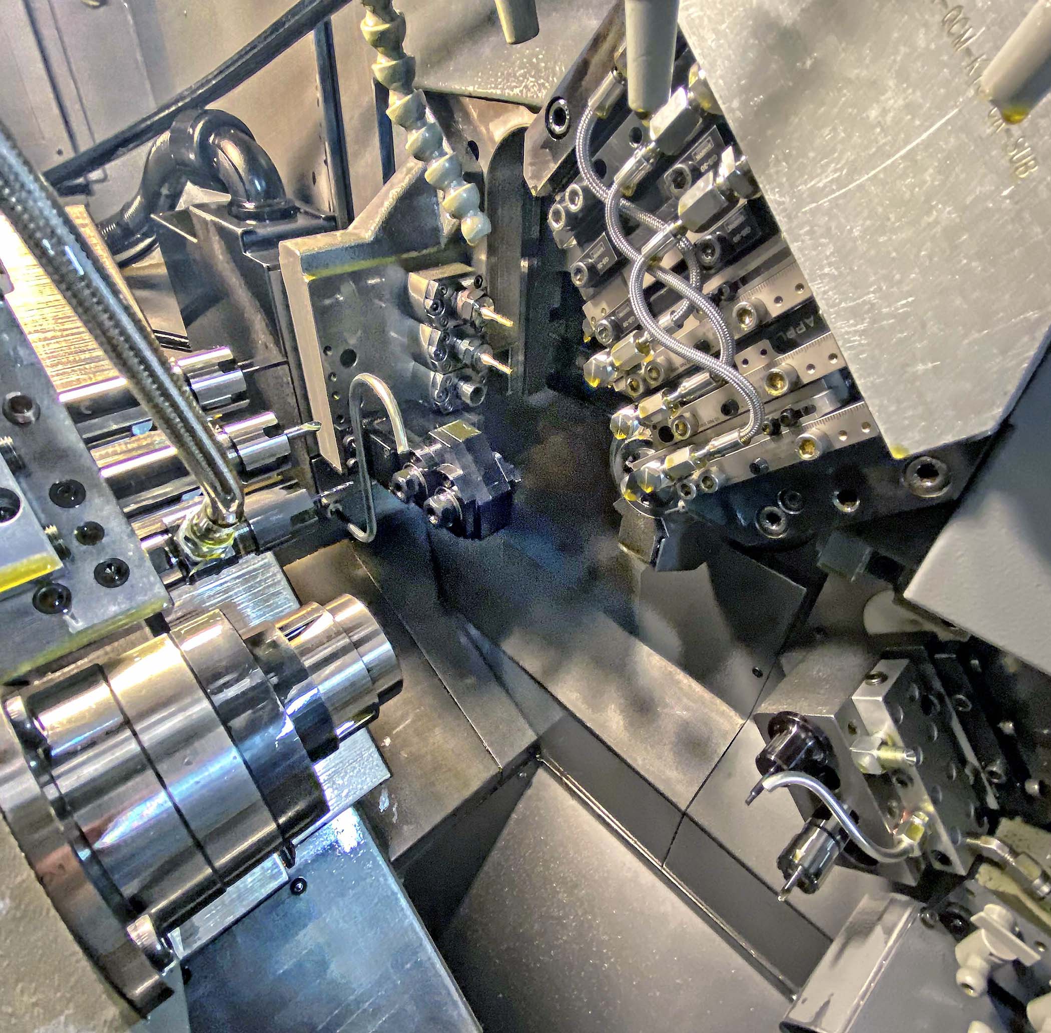

The L20-VIIILFV has even faster and more powerful spindles and live tooling than the previous two Cincoms installed in the Westbury factory. It also has integral driven tools for reverse end working and an uncluttered working area to provide more space to facilitate cutter exchange at up to 37 tool positions. After installation, the machine immediately started taking sub-20 mm diameter workload off the fixed-head lathes, freeing them to produce larger parts. Across a wide spread of components from 1 mm to 1 inch diameter, the L20-VIIILFV is executing some extremely fine work involving, for example, a 0.3 mm slitting saw and profile boring of a pre-drilled, 1.5 mm diameter hole.

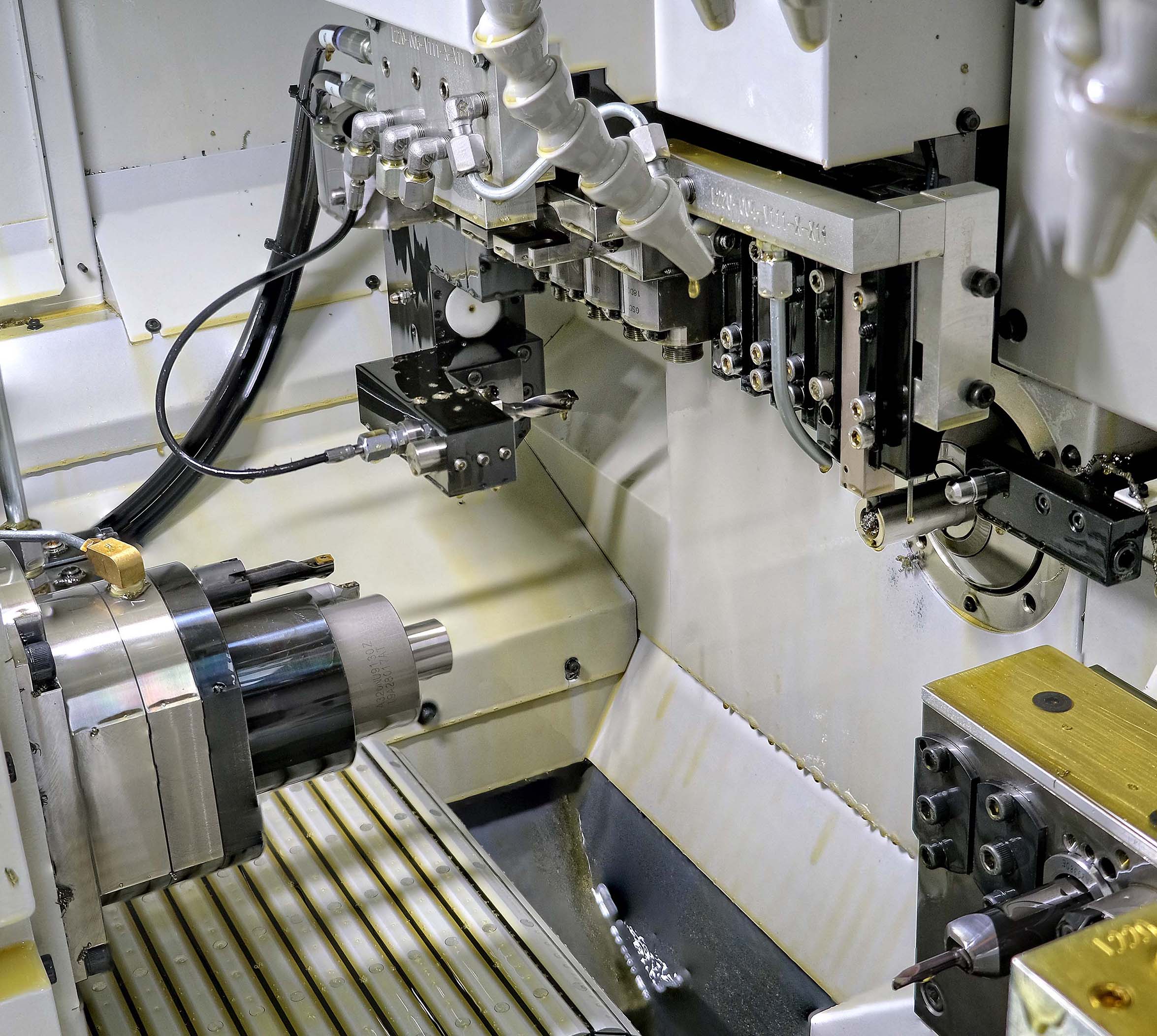

There are generally two impediments to lights-out production, according to Mr Pearce, namely component dimensions drifting out of tolerance and swarf build-up in the machining area requiring operator attendance to remove it. The latest lathe avoids both problems and therefore frequently runs unmanned overnight. The first issue is addressed by the presence of thermal compensation sensors around the machine and the second by Citizen’s LFV (low frequency vibration) technology running in the operating system of the Mitsubishi control.
Mr Pearce explained, “Sliding-head lathes when used with the guide bush in place have an inherent drawback. It is not really feasible to rough and then finish turn a part, as the smaller diameter of the roughed section when drawn back into the guide bush would cause vibration and impair the finishing pass.
“It is therefore necessary to turn to size in one operation, but that tends to produce long, stringy swarf when machining certain malleable materials. The LFV software prevents this from happening by lifting the tool tip away from the surface of the material periodically for a few microseconds.
“The frequency of the oscillation can be adjusted in the part program to control the size of the much shorter chips, added to which the LFV function can be turned off by G-code when it is more expedient, i.e. slightly quicker, to cut without it.
“Overall, productivity is increased by enabling reliable unattended operation, eliminating the need to include axis shuffles in programs to shake swarf off components, especially from grooves, and avoiding the need to stop the machine to clear swarf.”
The job on the lathe when it was photographed, a tubular Duplex stainless steel weld collar for the oil and gas industry, is a good example of how the benefits of LFV can be utilised. The high strength material has a tendency to work harden as it is being machined, the impact of which can be reduced by taking deep cuts to remove the work-hardened layer from the previous pass.
The problem is that taking deep cuts in such tough, ductile materials inhibits chip breaking and normally results in a bird’s nest of swarf wrapping itself around the component and tool, to the detriment of both and perhaps even rendering them useless. LFV prevents this from happening, so every part produced is perfect and tools last longer. In the case of the weld collar, LFV is switched on for facing the bar and turning a chamfer, then to maintain a high production rate it is switched off for simultaneously boring and turning the OD.

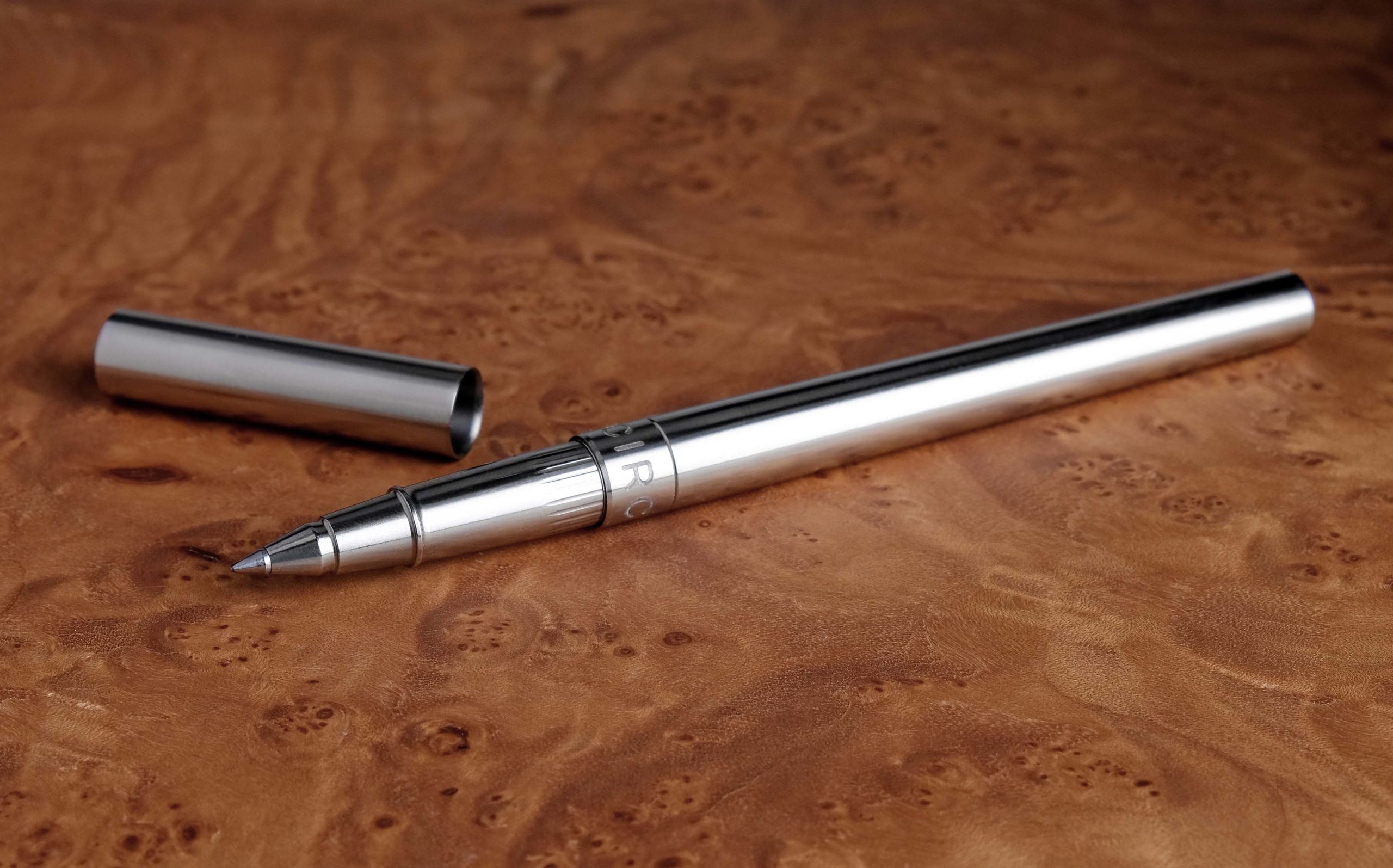

Combined with the availability of high-pressure coolant on the L20-VIIILFV, the chipping function will also prove useful in the production in one hit of CIRC’s single proprietary product, a ballpoint pen housing and cap turned from Nitronic 60 stainless steel alloy. The use of carbide tooling and neat cutting oil in its production gives each individually-numbered writing instrument a beautiful micro-planished surface.
Mr Pearce concluded, “The three Cincoms are the bedrock of our subcontract machining service. All feature main and sub spindles, full length bar feeds and a multitude of tools for driven cross working, end face milling and off-centre drilling.
“They enable us to offer economical done-in-one manufacture, without the need for secondary operations. This in turn allows us to run our machines unmanned, so we can offer competitive prices and hence fantastic value to our clients.
