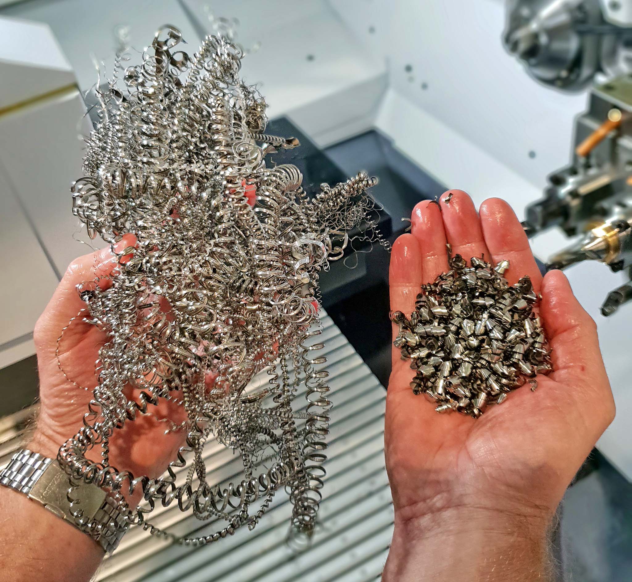

Citizen Machinery’s ground-breaking LFV (low frequency vibration) chip-breaking software (https://cmj.citizen.co.jp/english/product/lfv), which forms part of the operating system in the controls on some of the manufacturer’s sliding and fixed head mill-turn centres, will feature strongly at MACH 2022 as this year marks the fifth anniversary of the technology’s launch. The principle of operation is distinct from, and superior to, pecking macros programmed into individual machining cycles.
The patented system is gradually being rolled out across the company’s Cincom sliding head lathes, initially on the main spindle and more recently also on the sub spindle. To enable this, the construction of the machine models is systematically being strengthened to withstand the rigours of the momentary air cutting that creates the chip-breaking effect. There will be five Cincom machines on show at MACH 2022 equipped with LFV. A pair of Citizen’s Miyano fixed head lathes also benefits from the technology, one of which will also be exhibited.
The chip-breaking functionality can be switched on and off by G-code during a cycle, when deemed expedient, as if it were part of the program. The size of the actual chips can also be predetermined, as close control is maintained over the relationship between spindle speed and LFV oscillation of the tool by tens of microns, which has the effect of repeatedly retracting the tool tip clear of the workpiece. Coolant is able to penetrate the cut more efficiently, so tool life is extended and surface finish is improved.
Stringy swarf is therefore a thing of the past, even when machining difficult to chip materials like stainless steel, aluminium, copper and plastics. The need for manual swarf clearance is avoided, raising productivity and unattended running time, while the risk of damaging the workpiece and tool is removed. Futhermore, depth of cut may be increased substantially, raising productivity.

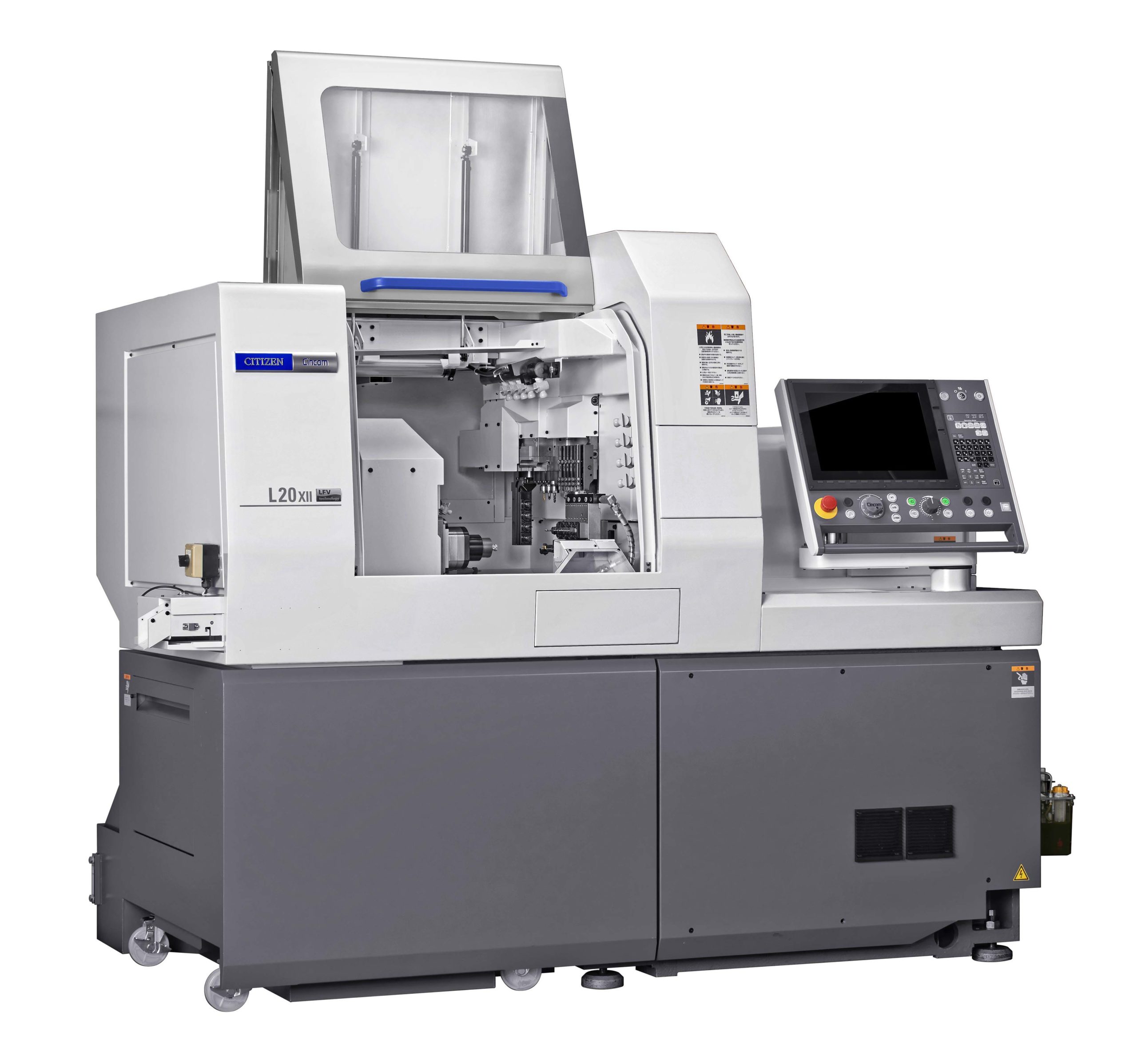

Debut of the new L20-XIIB5LFV sliding head lathe
The Cincom L20, Citizen’s best-selling sliding head lathe, has been upgraded to simultaneous 5-axis control via the improved, super-fast M850VM CNC with 15″ touchscreen. The new L20-XIIB5LFV allows multi-axis programming for superimposed machining with up to three tools in cut at the same time. It makes the machining of complex parts faster and easier and improves process stability.
The machine has a B-axis whose swivel range has been increased to 110 degrees, allowing more complex machining to higher accuracy at the main spindle, while the number of turning tools has been raised to six. Other improvements include a larger pitch between adjacent tools on the opposing and back tool posts to facilitate setting and reduce set-up time, a higher specification sub-spindle for improved productivity and the ability for LFV to be used when reverse-end machining.

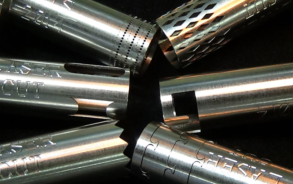

L32X sliding head lathe exhibited for the first time with laser cutting
Launched in mid-2019, the Cincom 8-axis L32‐XLFV will be on show for the first time at a MACH exhibition, without the optional LFV software but with the addition of high-speed, in-cycle laser cutting. The technology, which was originally developed for efficient production of apertures in thin-wall stents, is capable of fulfilling a wide variety of additional operations when machining tubular stock, or bar after it has been drilled longitudinally.
The development provides the option of in-cycle production of burr-free holes as small as 0.2 mm diameter and features such as spiral cuts with a 0.025 mm kerf. Consistent and accurate radii of less than 0.1 mm in the corners of slots can be achieved without risk of tool wear or breakage and at a far faster rate than is achievable by a separate EDM process. The non-contact, deflection-free, swarfless machining unit, deployed in the gang tool post, greatly expands freedom of design in the medical, electronics and many other industries.

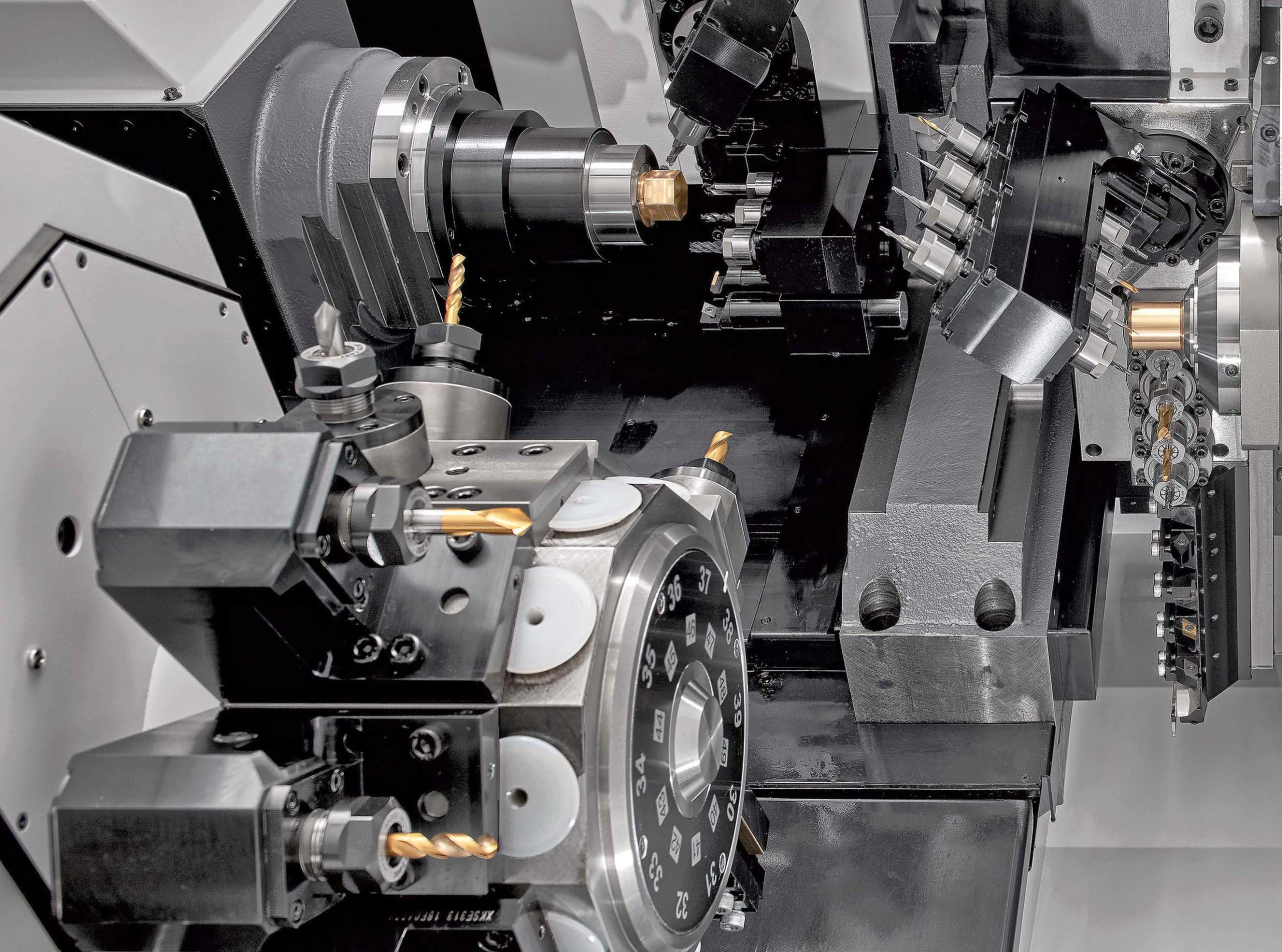

Although already shown elsewhere, for example at EMO 2021 in Milan, the new flagship series-5 M32-VIIILFV sliding head lathe with Mitsubishi M850W control will occupy a prominent position on the Citizen stand. The 10-axis machine has undergone a fundamental makeover and is considerably more robust than its predecessor, with larger and more rigid ballscrews and a bed that is 500 kg heavier, bringing the total installed weight to 4.3 tonnes.
The 10-station turret, which runs on hardened box ways, incorporates a new tooling system employing a single, heavier duty, 2.2 kW drive to an increased number of live cutters. Only the selected tool rotates – a world first for Citizen. The gang tool post has been equipped with 1.5 times faster live tools powered by a 2.2 kW motor, as well as a programmable, 9,000 rpm B-axis to enable simultaneous machining in five CNC axes rather than four; while the back tool post with Y-axis now has adjustable-angle tooling. Both features enable production of more complex parts, with three tools in cut at the same time.

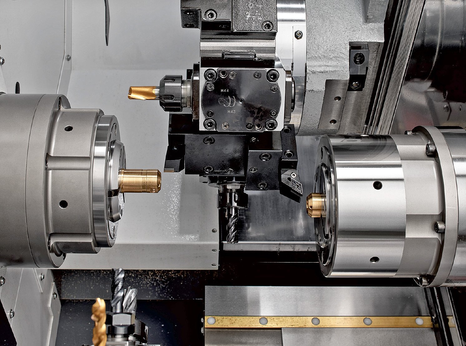

New Miyano BNE65MYY fixed head lathe with Mitsubishi 5-axis CNC for superimposed machining
Complex components up to 65 mm diameter may be turned and milled from bar on the new Miyano BNE65-MYY 10-axis fixed head lathe. Equipped with two Y-axis turrets, one positioned above and the other below the centreline of the twin-opposed spindles, considerable flexibility is provided for balancing front and back working cycles. The 8-tonne machine was introduced in the autumn of 2020 and is therefore making a first appearance at a MACH show.
Two-axis movement of the sub spindle facilitates superimposed machining under the control of a Mitsubishi M830W. Tooling on both faces of the top turret can simultaneously cut front-end features on bar stock and reverse-end features on a parted-off component. With the lower turret also working at the main spindle performing pinch turning, milling or drilling, for example, or perhaps OD turning while axial drilling is in progress above, three tools may be in cut at the same time.
