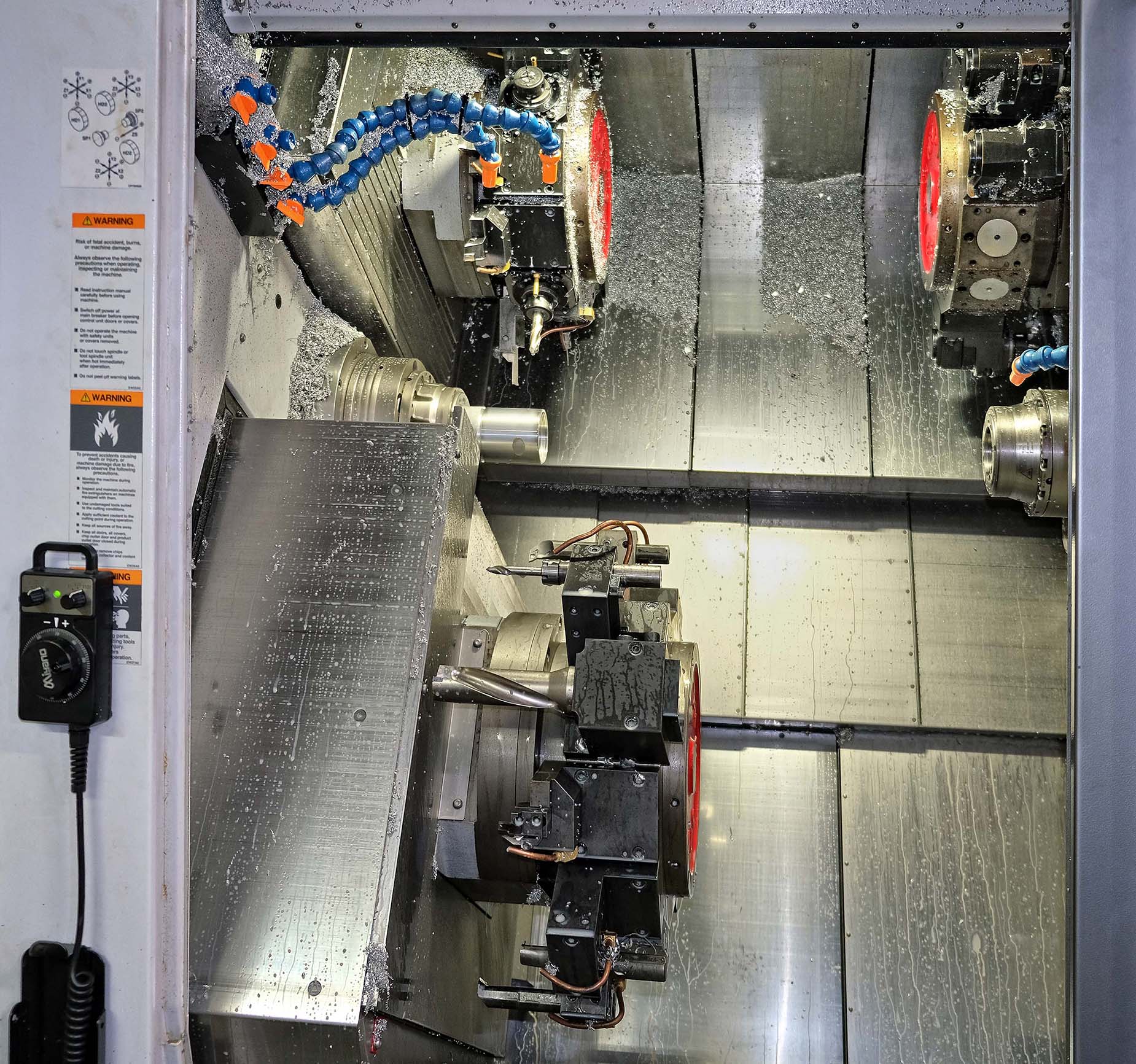

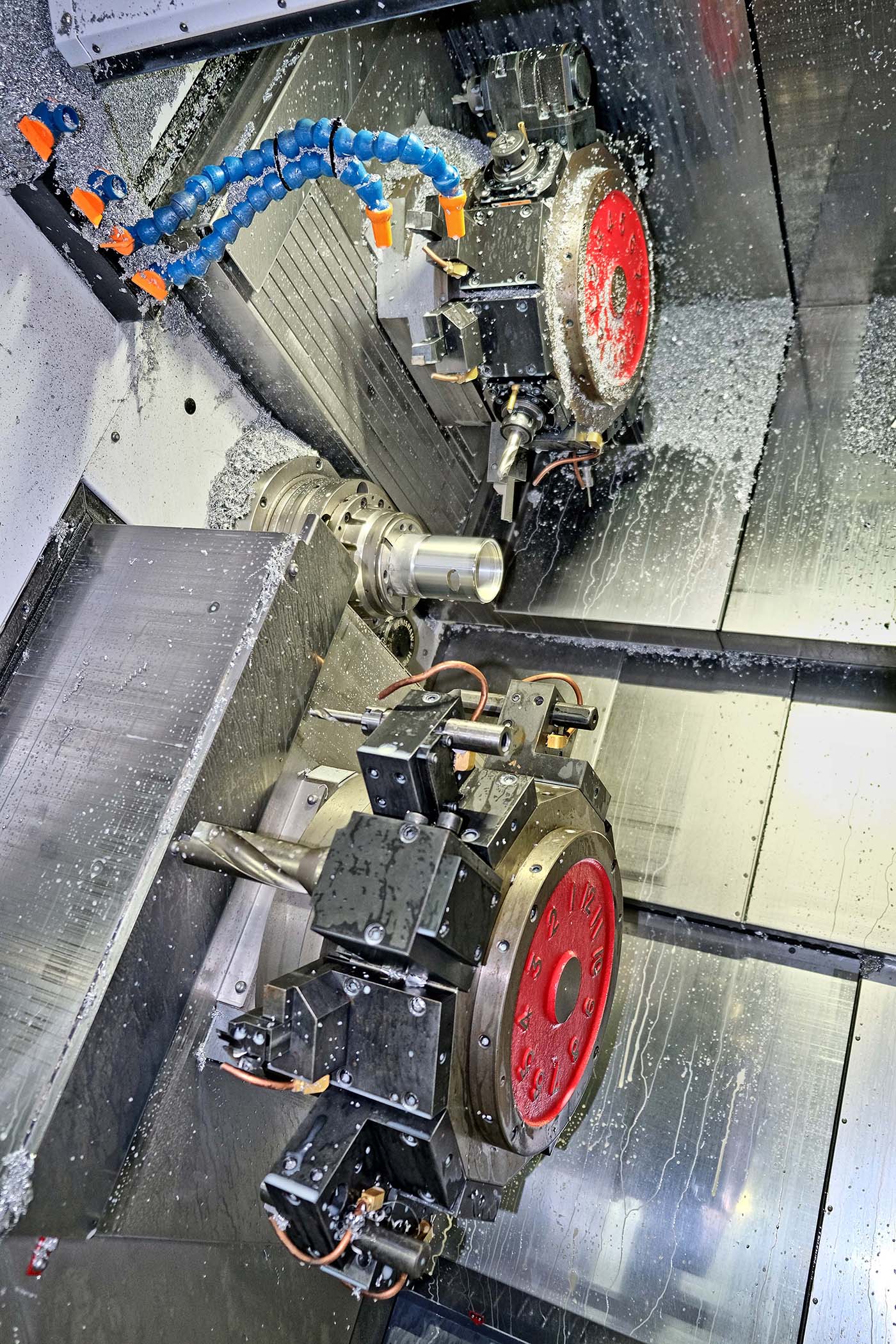

He explained that the two turrets positioned above the spindle centreline, each with 12 live stations, are dedicated to working at the main and counter spindles respectively. The third turret is located below and has unrestricted travel to operate at either spindle to provide flexibility for balancing front and reverse end machining. Three tools can be in cut simultaneously to achieve very high levels of machining efficiency.

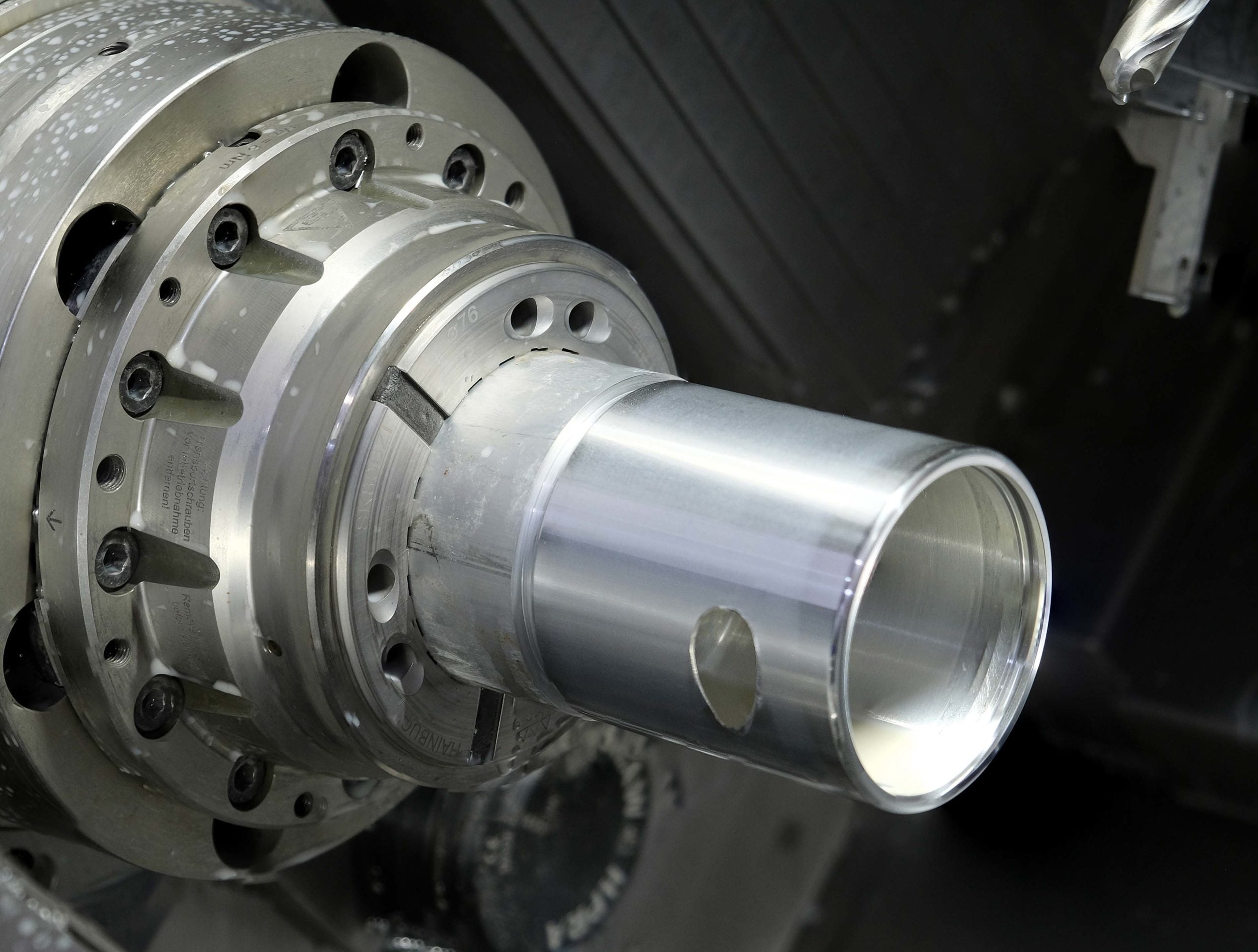

In the case of the oil-air separator body, it is now possible to machine five from bar in 30 minutes whereas before, with an operator loading billets manually into the chuck of an ABX-64SYY, it took at least 45 minutes to achieve the same output. In other words, productivity has been boosted by more than 50 percent. A further benefit to Andair is that the two 64 mm bar lathes can now be devoted to the collet work for which they were originally intended.

In the case of another component, in fact the first part that was made on the ABX-64 THY, all three turrets had almost an identical amount of work to perform. Cycle time is 2 minutes 15 seconds including parting-off and the component comes off finished, whereas previously the cycle was 4 minutes, plus there was a need for a second operation, requiring extra time for both metalcutting and inter-machine handling.
