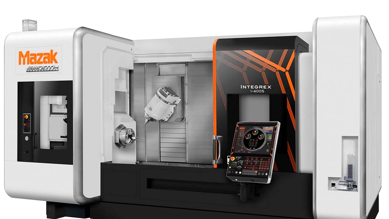

Of the 20 machines on display, the stand-out is likely to be the INTEGREX i-400S machining centre, part of Mazak’s flagship INTEGREX range, which is equipped with Mazak’s SmoothX CNC. The i-400S is ideally suited to range of industry sectors including aerospace and automotive due to its new function, SMOOTH Gear Cutting software, which combines advanced Multi-Tasking machining and Mazak’s latest developments in gear manufacturing processes, including SMOOTH Gear Skiving, SMOOTH Gear Milling and SMOOTH Gear Hobbing. The software allows the operator to develop complex gear machining programs easily by entering the gear data via a user-friendly dialogue on the CNC, further reducing set-up times.
The i-400S also features Mazak’s new Smooth Spindle Analytics, which provides instant spindle vibration analysis and feedback that can be quickly accessed via the control panel on the shop floor – increasing both accuracy and productivity whilst improving machine uptime and enabling full component traceability.
