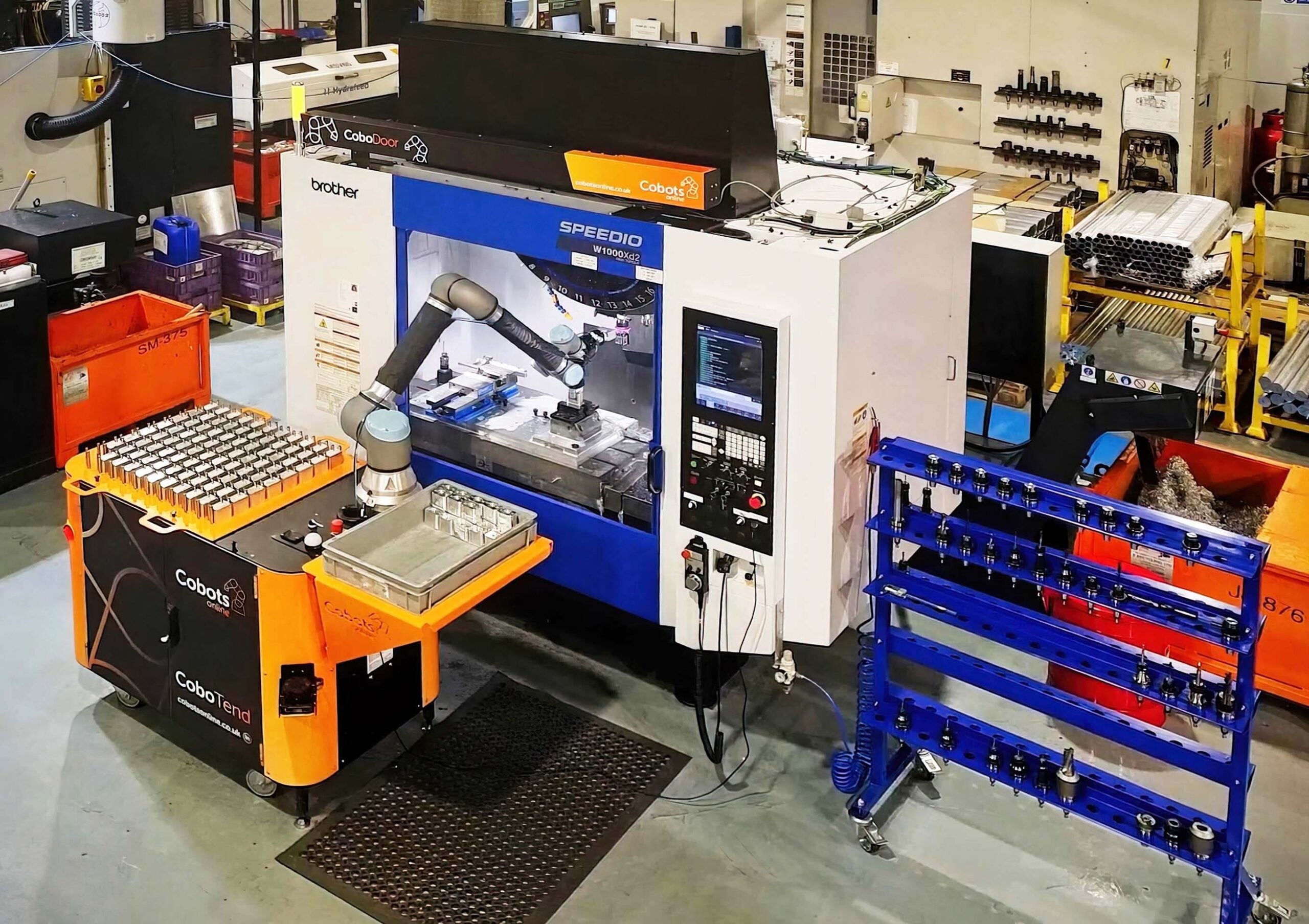

The Speedio’s one-metre table has enabled the company to take on larger components and improve throughput, particularly when combined with the machine’s wide range of machining capabilities. Despite its large working envelope, the Speedio with its compact footprint fitted neatly into ALM’s 14,000 sq ft facility, where space utilisation is important.
The machine has been integrated seamlessly into a densely populated shop floor, supporting a high output of components and efficient material handling using pallet trucks. The company’s ability to manufacture tooling in-house has significantly enhanced responsiveness to customer demand by reducing reliance on third-party suppliers.

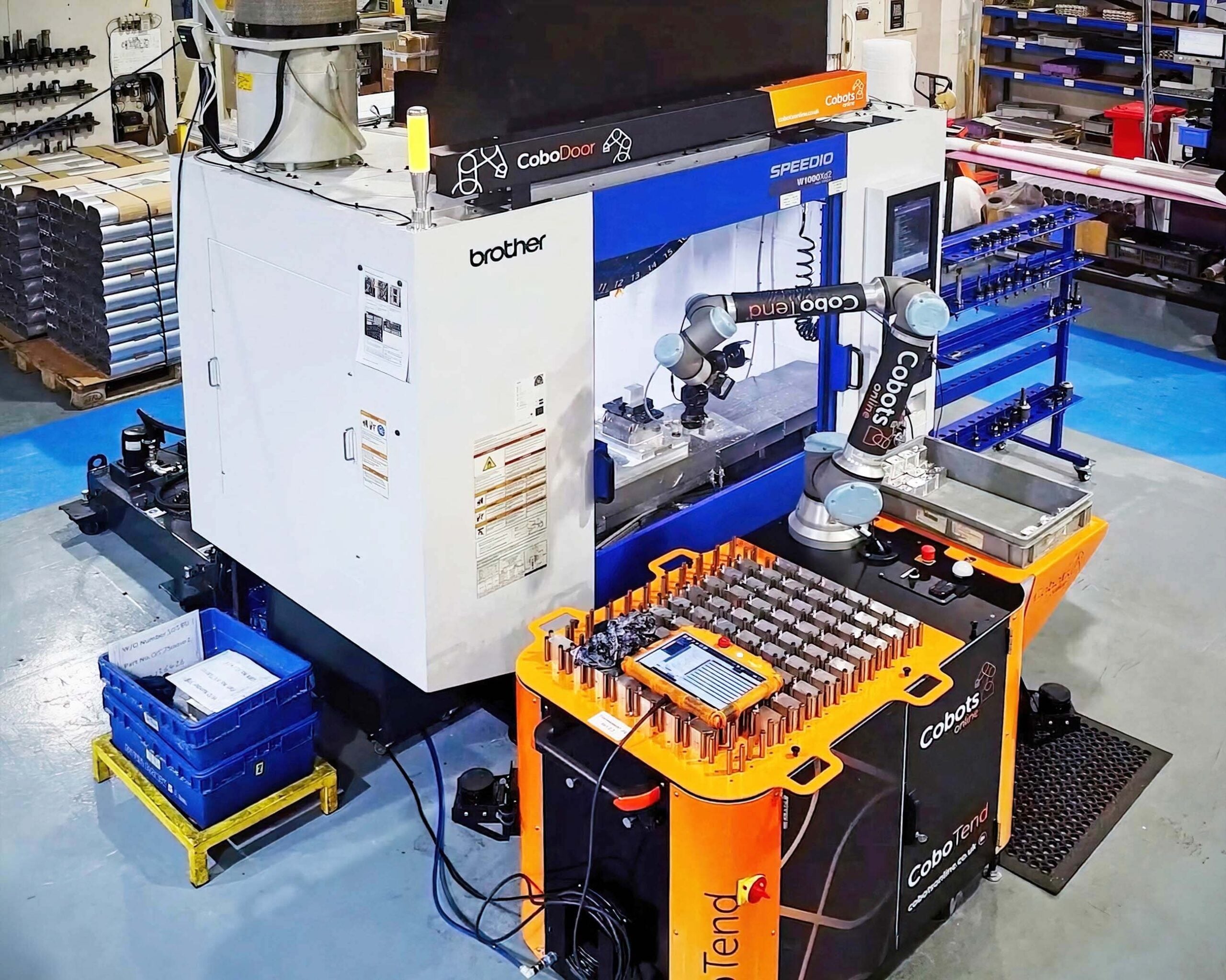

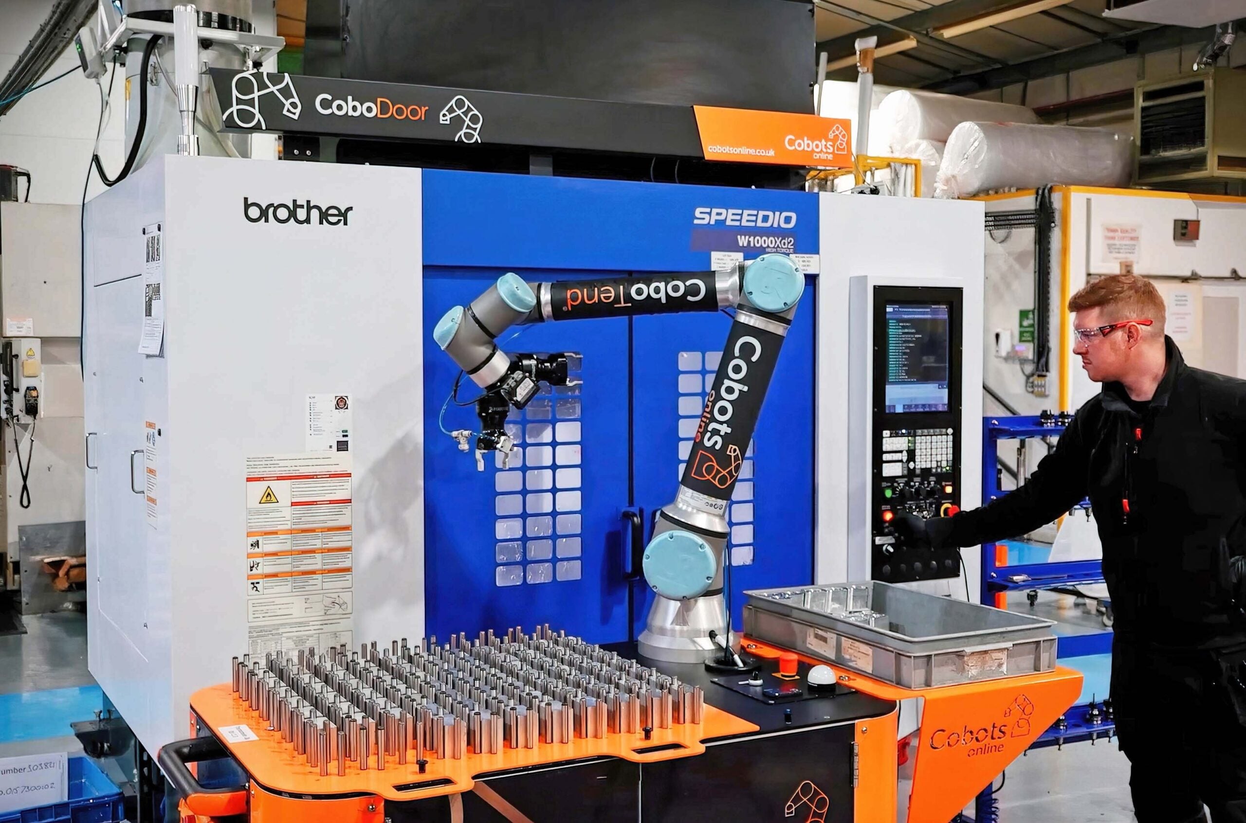

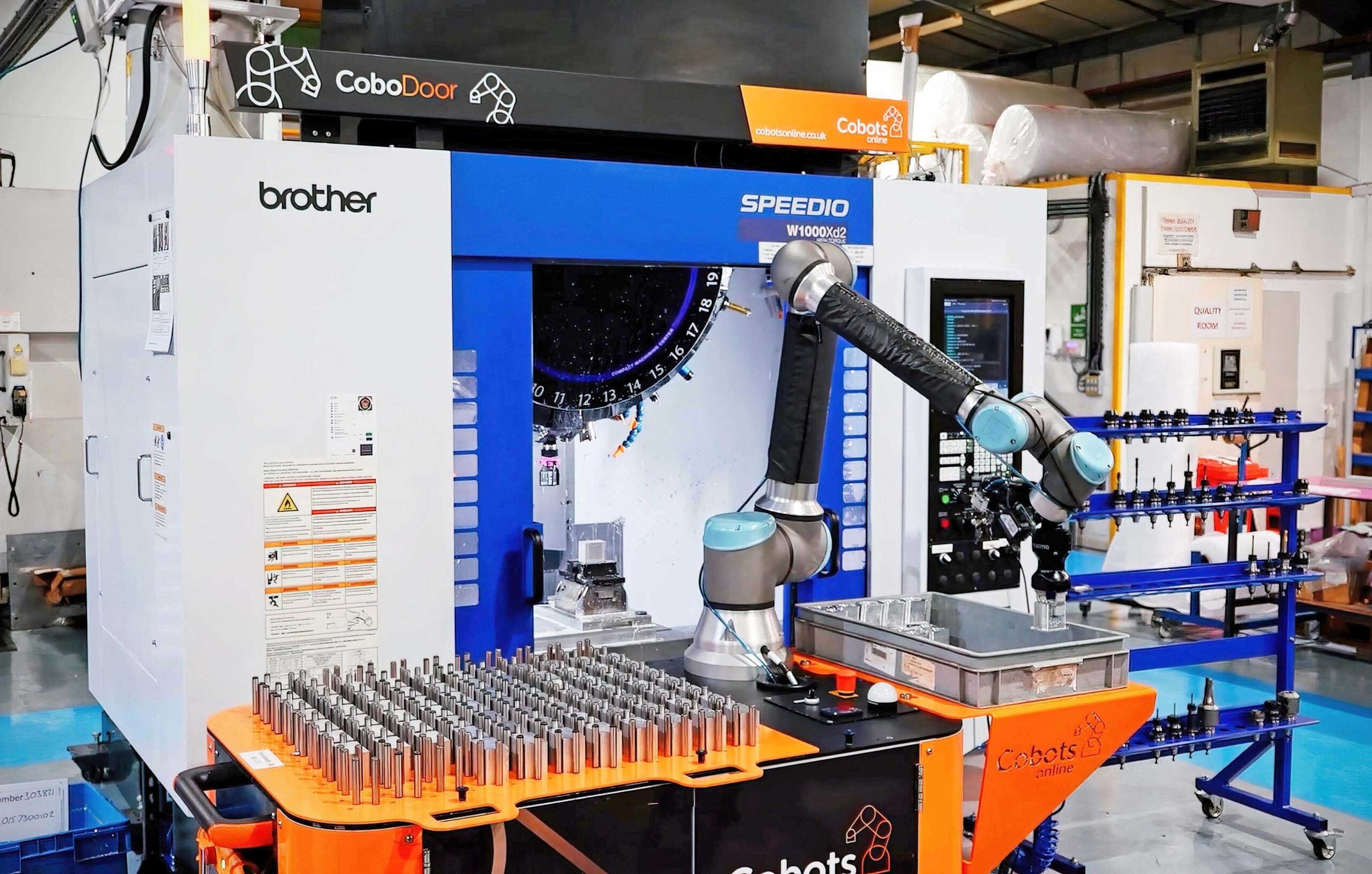

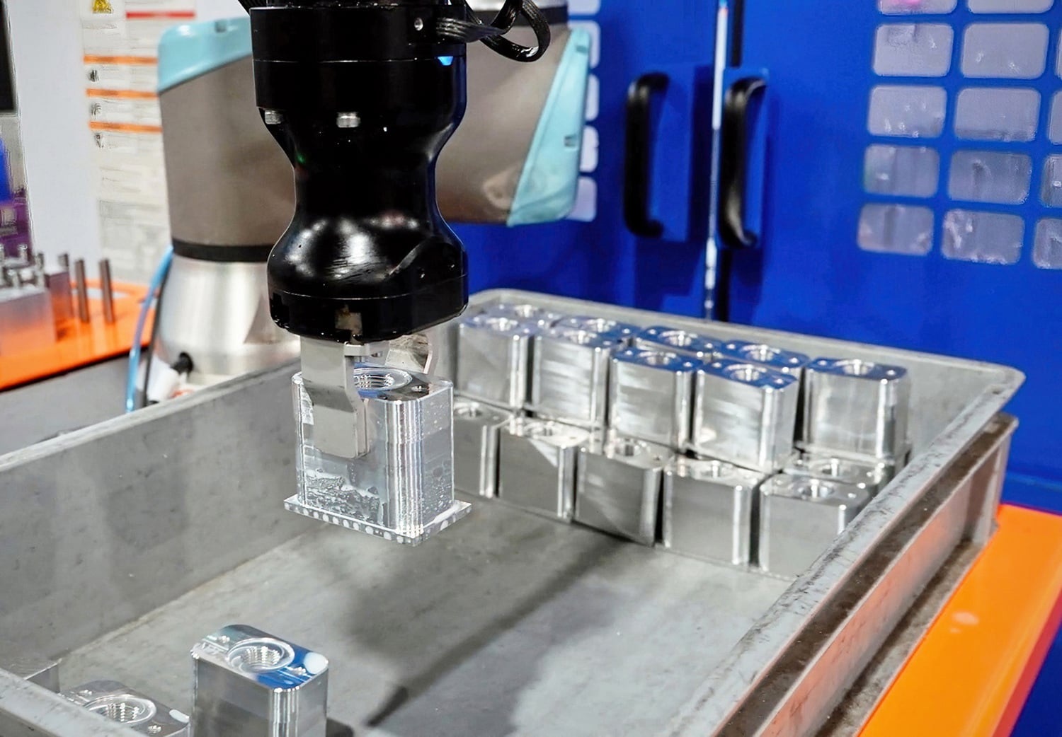

A key differentiator of ALM’s operation is the use of its own collaborative robots, branded Cobots Online. The Speedio is paired with one of the mobile cobots developed in-house, joining a population of seven such cobots deployed across the factory floor. The systems are designed for rapid deployment, with the ability to be moved between machines and set up within minutes.
Featuring quick-change tooling, integrated hydraulics, and simple connectivity via a 13-amp supply, ethernet connection to the machine and an air supply, the cobots can be easily repositioned or removed entirely if manual machining is required. All operators are trained to program and use the systems, eliminating the need for dedicated automation specialists.
The integration of cobot automation with the Speedio has delivered a step-change in productivity: “It’s massive really, giving us 24/7 flexibility,” said Mr Thompson. “We don’t need to ask our staff to work all over the weekends. We have someone come in on Saturday morning and then later in the afternoon and the machine runs unattended all day.”
