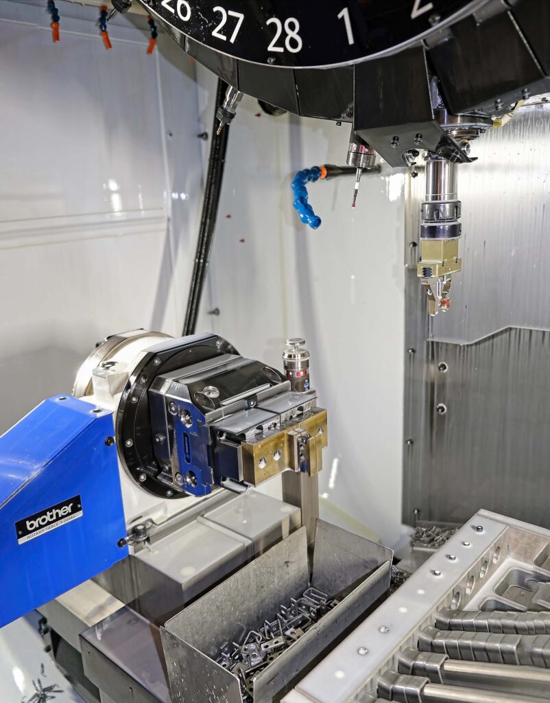

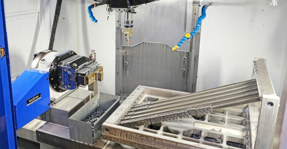

In partnership with Whitehouse Machine Tools, Westley Engineering implemented an automated, single-operation process on each Speedio. The new production route features custom-built fixtures with nine inclined bars, each capable of holding about 36 clips. This high-density arrangement enables over 300 parts to be machined per cycle, significantly more than the flat fixtures used previously.
Cycle times have been reduced to between two and three minutes per clip, depending on the variant. For example, the Inconel version requires additional milling on the outer arms, whereas the steel variants do not. Typical batch size ranges from 5,000 to 10,000 units.
Before deployment, the process was validated at Whitehouse Machine Tools’ Kenilworth technical centre. Its applications engineers wrote the machine programs, assisted with fixture setup and provided on-site training, all offered as part of the supplier’s lifetime service and support.

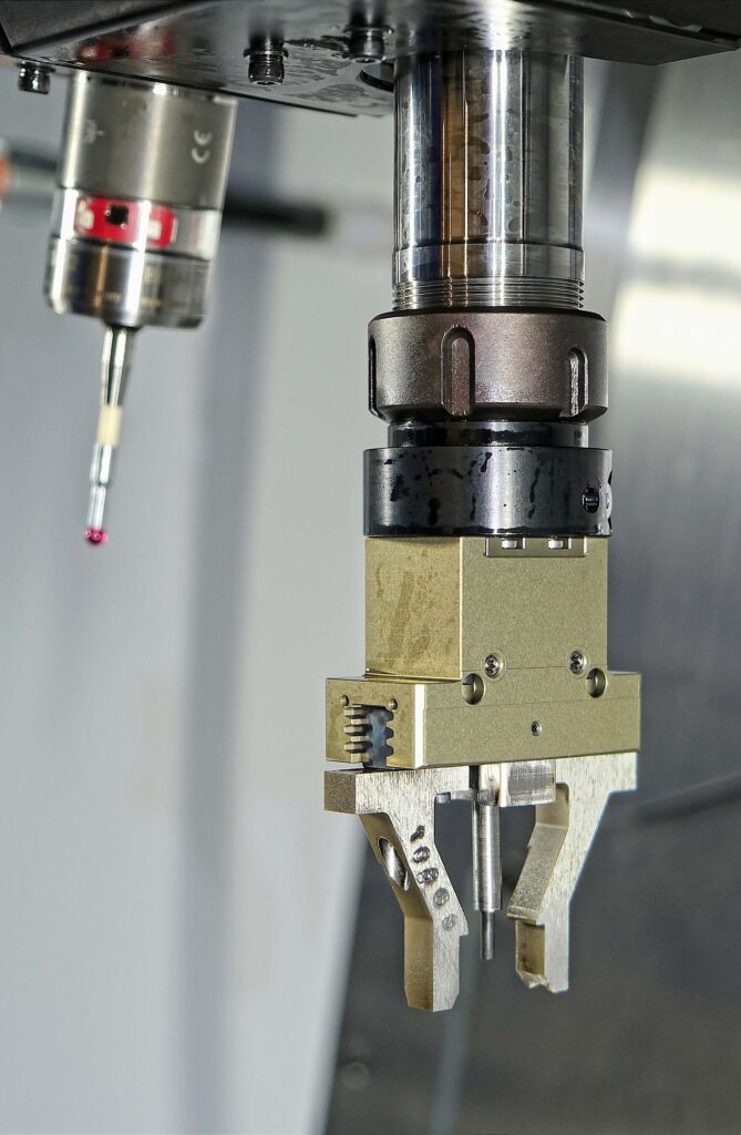

A coolant-actuated gripper, housed in one of the Speedio’s 28 turret positions, picks up each clip from the inclined bars. After verifying the workpiece position using sensors, the gripper transfers the part to a Schunk hydraulic vice mounted on a rotary axis.
The component is then machined – drilled, countersunk and in some cases milled – before being dropped into a container for post-processing. All clips undergo 100 percent inspection, including after heat treatment, followed by fettling as needed to correct any distortion.
