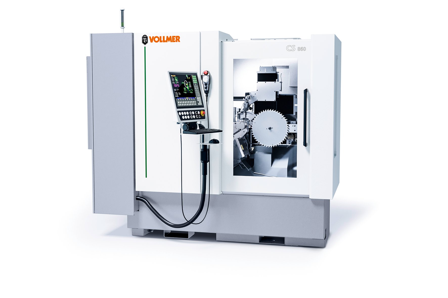

Working for VOLLMER for 24 years and spending over 14 years in product management, Thomas Wenger has incredible industry experience in the circular saw marketplace. With the new CSF860 side grinding machine and the CS860 face and top grinding machine both making their worldwide exhibition premiere at the GrindingHub exhibition in May, we speak to Thomas about the arrival of the two new machines.
Discussing the concept behind the two new machines that will supersede the CHD 270 and CHF 270 saw blade processing machines, Thomas says: “The CHD and CHF machines were based on a completely different construction to our new technology. The CHF side grinding machine was designed in 2000 and the CHD face and top grinding machine was designed in 2004-05 – we continually evolved these machines, but we reached the limit of what could be achieved with the existing construction and this was reflected in the machines at the end. Now, with new drives and software technology on a new foundation – we can add new features for our customers.”
“We identified our development goals and we started to design the CS and CSF machines. So, the base, the housing and many other elements are completely different to before, but components that have proven their stability and accuracy over many years remain. We have designed both new machines with the same kinematics, housing, structure and polymer concrete base, so we can have a modular foundation. This makes it easier for us internally to streamline production and reduce lead times. It also makes the machine easier for the operator to handle as there is greater synergy between the CS and CSF machines. This creates uniformity with regard to loading, setting-up, the view and ergonomics and also the programming.”
“This uniformity of technology was our target, adopting the same CNC, operating philosophy and also the latest drive technology. In the past, we used some servo motors with standard synchronous motors. Now, all motors, grinding spindles and axes are servo driven. We have seven motors on the CSF side grinder and eight on the CS face and top grinder, this includes linear CNC axes plus 3 CNC grinding spindles on the face/topper and two CNC grinding spindles on the side grinder. The servo-driven grinding spindles provide a higher quality saw blade and we can now conduct different in-feed and cutting speed rates on each tooth. This improves the surface quality of the cutting edge and brings more flexibility into the grinding process. Customers can now do whatever they wish.”
Expanding on the servo motors, Thomas says: “Previously, standard motors had power and encoder cables, by evolving to the OCT (one cable technology) hyperface technology there is just one cable. This means there are fewer cables and switches, reduced power consumption and it is easier to change a single cable – something that reduces the future service costs for the customer.”
New features that fulfil the four foundation blocks
With any new concept, the experts at VOLLMER aim to achieve four key delivery parameters for customers. These are increased flexibility, productivity, reliability and quality. Alluding to this, Thomas adds: “We met the goals by creating more stable processes in the new machines to provide better grinding results at the cutting edge. This was the fundamental reason for the new CNC control, motors, new features for oscillation, grinding and cutting speeds.”
“Looking at flexibility, one important thing is the integration of an additional axis, the R2 axis. This cross-axis at the saw carrier makes it possible to grind saws with a flange. Flexibility was previously limited because saws were manually set. Now, this is completely flexible as you can mix saws with different flange heights and even mix saws with and without flanges.”
“Flange saws are very prominent in the wood industry and this will make it much more flexible to accept different types of saw blades. Previously, a customer would need 10-15 minutes to undertake this reset/change-up. Of course, some customers only undertake this saw type change once a day, but others repeat this a few times a day. It’s now done immediately, saving the customer time.”
“We also have a new ‘centre brake’ feature. In the past, we would put the saw carrier on the machine and the saw blade would rotate on the flange. When processing coated or strobe saw blades, the carrier could leave scratches on the blade – so we created a carrier that rotates with the blade. In the end, there is a centre brake and clamping plate on the gullet that opens when we push the tooth to the next grinding position. If it is left closed, there will be scratches in the gullet area, if you open the clamp and push the next tooth – you need to hold the saw blade somewhere. This is why we use the rotating flange together with the centre brake, so we can open the clamp and push the tooth to the next position. This eliminates scratches at the centre or around the gullet area at the end of the process.”

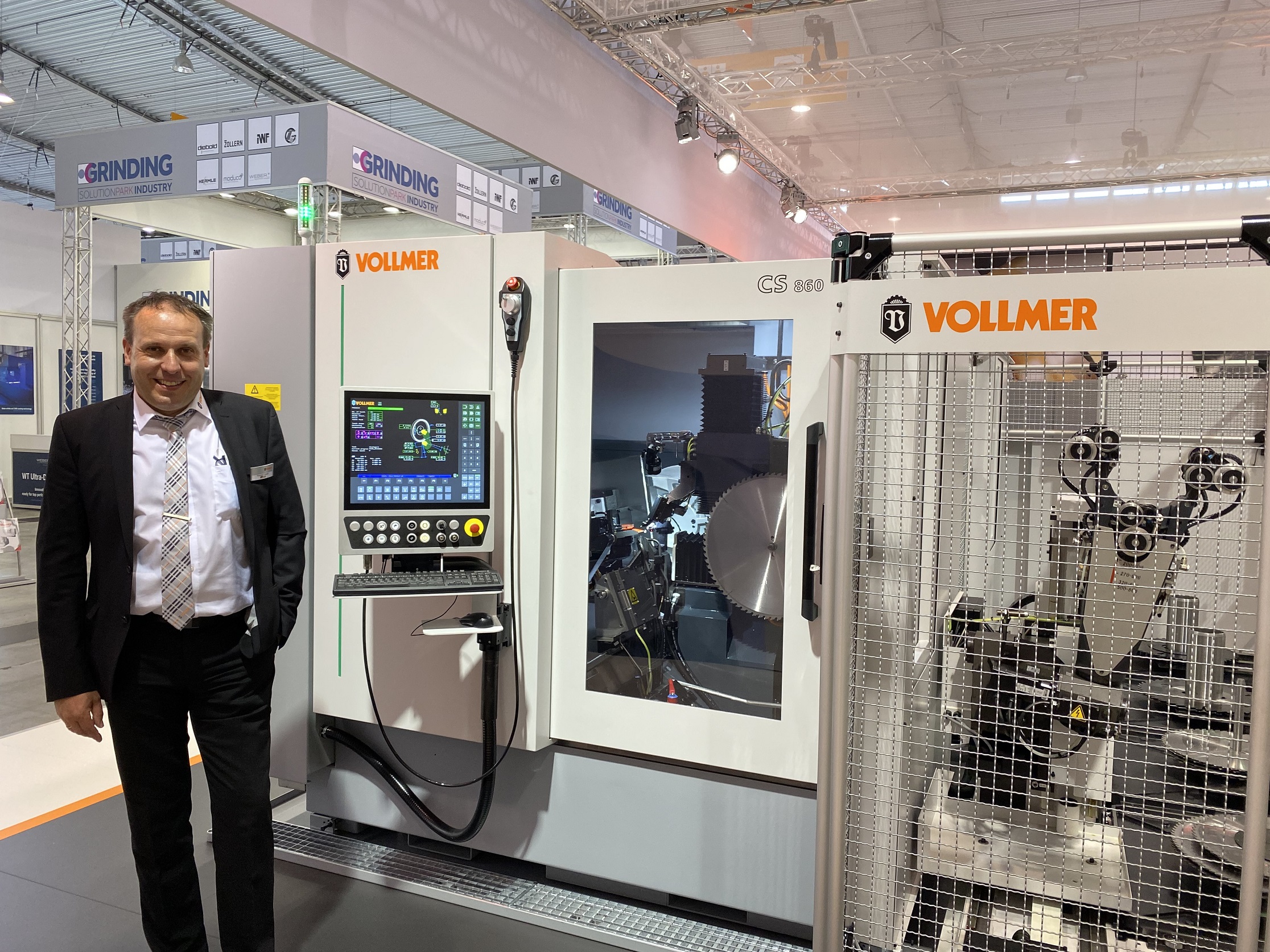

With Thomas already emphasising how software is reducing data input requirements, ‘air-cutting’ times and manual measuring processes – the software cannot undertake such tasks without the supporting hardware. And here, Thomas acknowledges the ingenuity of the new measuring technology: “The stable production processes are derived from three measuring devices. First, we have the Renishaw MP250 measuring probe repeatable to 1µm. It has high-end 3D precision unnecessary on machine tools that only require single point contact. We use the Renishaw MP250, as its spherical system provides remarkable accuracy regardless of contact point direction and we need this as our face and top grinders, measure all around the tooth.”
“The second system is the brand new measuring cube for the grinding wheels. It has an absolute fixed point and it gives absolute knowledge of the grinding wheel position. If there is a temperature fluctuation in the machine or spindle, this fixed point will compensate for all other parameters. It is very stable and fast. We can measure the grinding wheels whilst the machine changes the saw blades. In the past, it was necessary to compensate the grinding wheel by measuring the tooth – this was unproductive time. Integrating this process increases grinding stability whilst reducing unproductive time.”
“This grinding wheel measurement is pre-programmable, but the manufacturer generally knows they need to recalibrate the wheel every 5 or 10 saw blades. The customer can define the measuring point, whether it be by the number of teeth or saw blades processed. Furthermore, the customer is not losing production time – a concern in the past. As an example, the wheel measuring process takes 20 to 25 seconds and it can be undertaken simultaneously with the saw blade changeover takes 25 to 30 seconds when using a double gripper system or roughly 50 seconds with the single gripper system. This effectively enables every saw blade to be measured to a precision level of roughly 2µm to guarantee process stability without losing production time.”
“We have now added our third measurement device to the new side grinder – our acoustic sensor that was on the CHD machine. This promotes very fast setups by combining technologies. With the Renishaw probe, we probe the raw and finished tooth, with the measuring cube we measure the grinding wheel and with the acoustic sensor, we are bringing everything together by checking the tooth with the wheel. The wheel senses the tooth and the acoustic sensor knows if we have the right in-feed – making all three measuring devices work together.”
To achieve such precision demands a robust foundation as Thomas says: “VOLLMER is the only manufacturer that uses a concrete polymer base. Very few competitors use a cast iron base; most build machines by constructing steel machined components. Our polymer concrete foundation makes our machines different from our competitors – it puts our quality and precision on a completely different level.”
