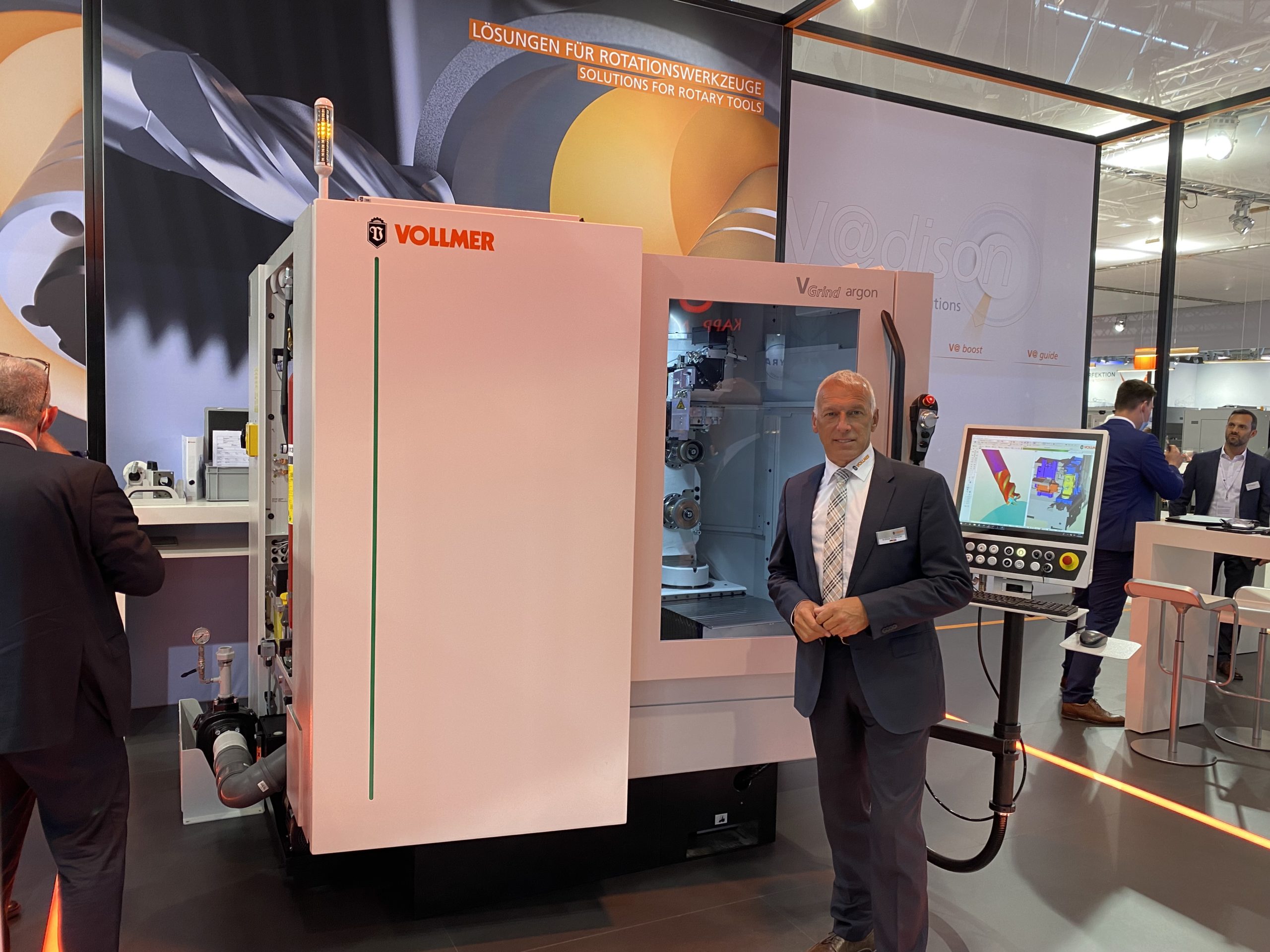

Alluding to the new neon machine, Andreas says: “We have listened to the market and asked what their minimum requirements are from a machine – and this is where we have created two new machines, the neon and the argon. The neon machine is a machine without the loading system and the wheel changer. This means that the operator has to load the tool manually and then hit the start button. The neon machine retains the two spindle configuration with the fixed bearings torwards the front as this is a concept that we will never leave, as it is extremely accurate and reduces warm-up cycles. The neon machine also retains the polymer concrete base as this guarantees thermal stability and minimises growth to provide accuracy and repeatability that leads the industry.”
“We have put some options into the neon machine. It has an additional measuring probe for the grinding wheels and software incorporated for a measuring probe, it has an A-axis with SK50, the multi-level two-spindle configuration, linear glass scales and a range of other options that have enabled us to create a package price that delivers a cost-efficient solution for tool manufacturers and re-grinding workshops. The neon has a limited number of options, but this package without automation has been created to meet the needs of extensive customer feedback that we have received.”
