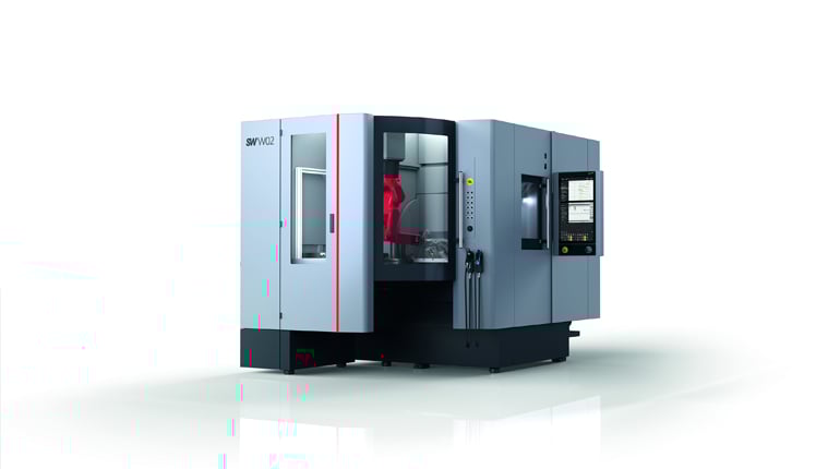

Manufacturing cells with a supply of workpieces for one shift are used in many applications for machining complex workpieces – from the automotive industry to medicine and precision engineering. Many automation solutions in the past have been 2-part systems that required a good deal of time and effort to integrate into the process chain. To prevent this in the future, Schwäbische Werkzeugmaschinen GmbH (SW) – expert in challenging, workpiece-specific manufacturing systems for metalworking – has released two new manufacturing cells designed for plug-and-play-capa

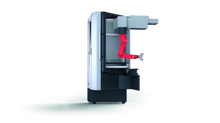

ble manufacturing cells that significantly shorten customer commissioning time: The systems consist of the proven machine tool BA 222 or BA W02-22 together with a newly developed loading module with integrated 6-axis robot and vertical pallet storage for blanks and finished parts.The module enables loading and unloading of the machining center in parallel to machining time and is completely flanged onto the basic machine in the SW plant. The machine, robot and workpiece storage are designed as a crane hook solution to meet specific customer needs. Overhead robot mounting allows more freedom of motion. The workpiece storage is set off to the side, thus also allowing for manual loading of tools into the machine while requiring very little space. A manufacturing cell with loading module is also planned for the machining center model BA 322.

SW therefore developed a loading module for the BA 222 and BA W02-22 machining centers with integrated robot and workpiece storage that eliminates these problems: The module is flanged onto the basic machine and completely set up before it leaves SW. "In this context flanged on means that the components are mechanically connected, the coolant return and swarf return to the swarf conveyor are set up and the electrical installation is performed," points out Armleder. The two components – loading module and machine tool – combine to form an independent manufacturing cell together with a supply of workpieces for one shift. The cell is delivered as a plug-and-play-capable complete system, resulting in especially short commissioning times for customers.

The loading module is designed so that the machine, robot and workpiece storage are arranged as a crane hook solution to meet specific customer needs. "SW machine tools feature a patented monoblock construction that is critical for the stability and accuracy of the machining center. This design shape makes overhead mounting of the robot very advantageous," continues Armleder. Since the robot can also be flexibly configured for specific projects, there is more freedom of movement and space for other technologies. For example other processes can be integrated, including reclamping, labeling or scanning. The loading module is fitted with standard aluminum support profiles for this purpose for fast and universal use holding these additional devices.
The powerful 7-kg robot is suitable for workpieces up to 100 x 100 x 50 mm in dimension with a weight of up to 1.0 kg and makes it possible to use multiple grippers and move the pallets. In addition to loading and unloading in parallel to machining time with an integrated 6-axis robot, the system also makes it possible to perform this step manually. This is helpful for example with small batch sizes. It is also possible to exchange the workpiece supply in parallel to system production time. The design of the loading module with the workpiece storage set off slightly to the side also makes it possible to use the manufacturing cell under difficult conditions. "This design features a special arc-shaped robot loading door and allows for nearly unrestricted access for all setup tasks at the loading station," explains Armleder. "We created a special solution for this so that swarf and coolant can be reliably diverted from the entire robot area into the swarf conveyor."
