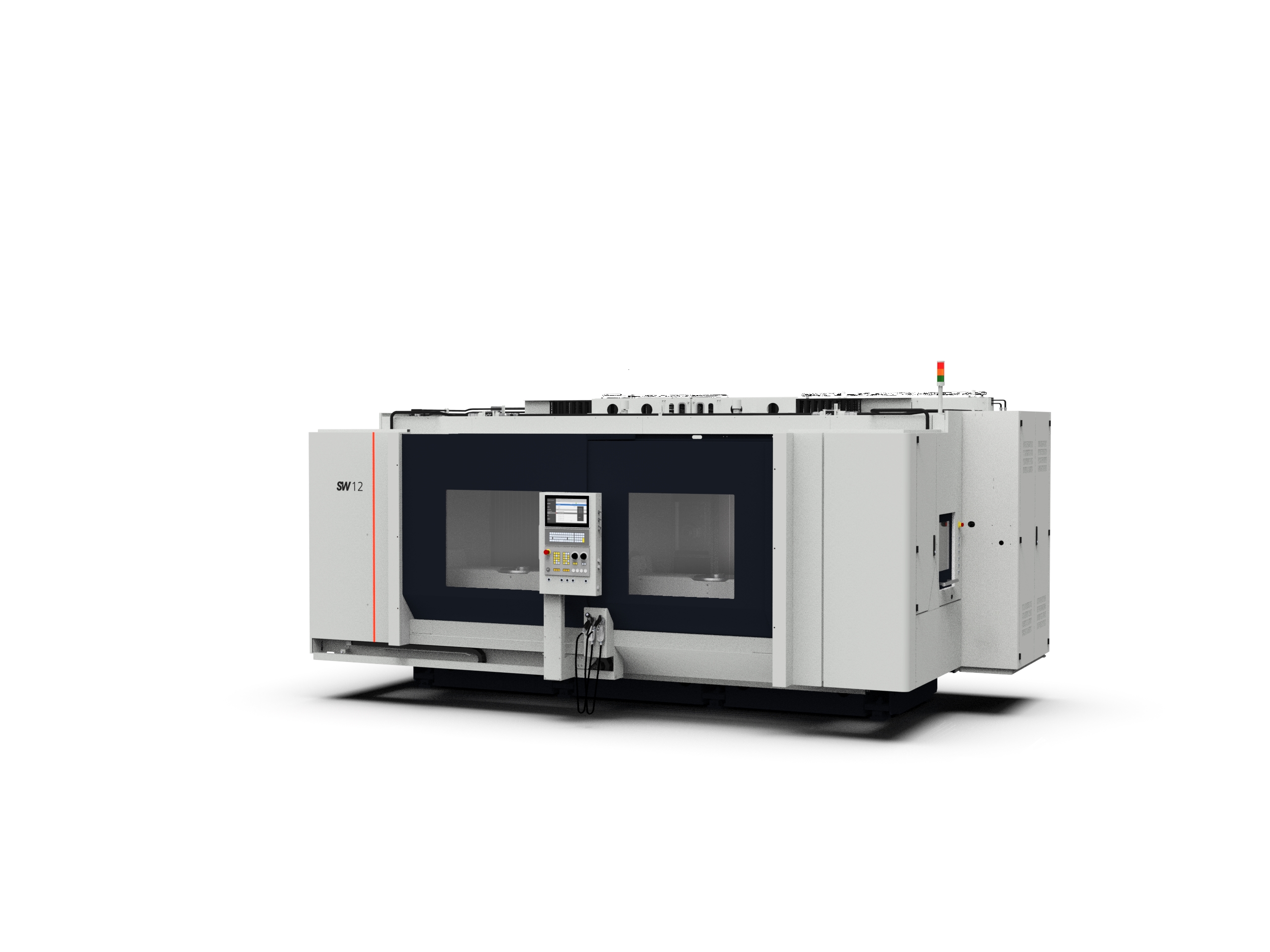

SW’s booth at the trade fair offers not only solutions for small batch sizes: with the BF 12-21D, the company is also presenting a new machine tool for high production volumes. As part of SW’s BF series, the system is specifically designed for the fast machining of frame and structural components. “In automotive engineering, we are seeing a clear trend toward the use of aluminum die-cast parts in vehicle body construction,” explains Kreuzberger. “These parts require less manufacturing precision than, for example, gearbox or stator housings. With the BF 12-21D, we offer an economical and dynamic machine concept for precisely these applications.”
The BF machine series differs from other SW machines in its structural design: to fit the specific market conditions, it features a hybrid axis configuration, utilizing a linear drive for the X-axis, i while the Y- and Z-axes are driven by ball screws. SW also relies on proven twin-spindle technology to easily meet high productivity requirements: with two three-axis units and one spindle per working area, the BF 12-21D can replace two conventional single-spindle machines – and achieve higher output with a smaller footprint. When components are changed in one working area, the second spindle in the other working area can be used to achieve even higher productivity.
