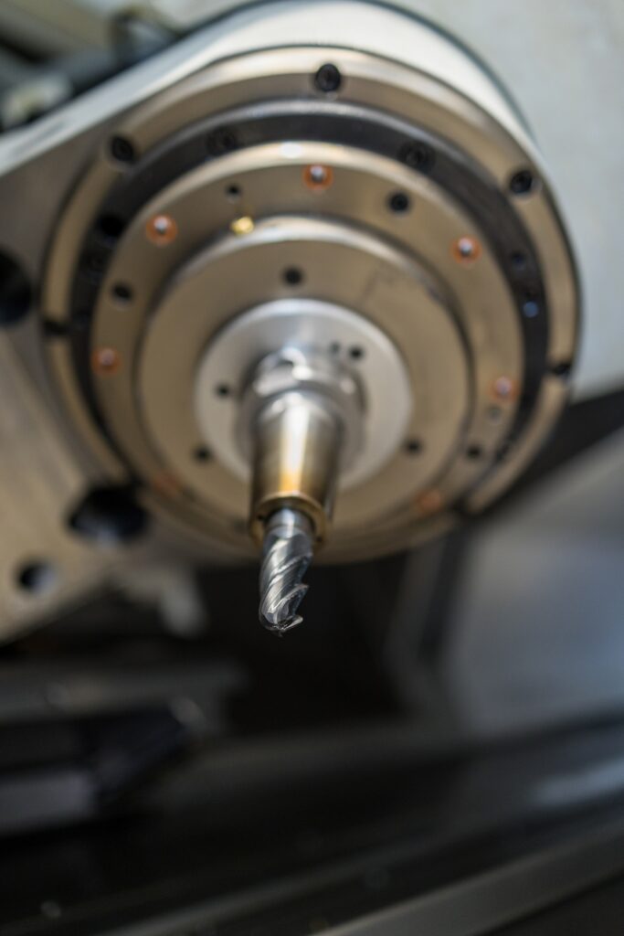

Sofian Regaz is primarily responsible for product management and sales of Starrag tools. “Here in Rorschacherberg, we have spent many years developing and grinding carbide milling cutters for aircraft and turbine components made from difficult-to-machine materials such as titanium, Inconel or high-alloy steels.”

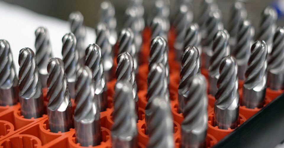

Though Starrag offers a small range of standard tools, over 90% of the company’s tools are custom-made products. These tools are tailored to specific machining processes that fully embrace the component, the machine, the material, and other considerations. “It makes a huge difference whether I adapt my NC program to a catalogue milling cutter or design the tool in terms of the cutting edge length, corner radius, flank angle and coating. This enables us to deliver the optimum machining process. Our customers enjoy great success with this,” says Sofian Regaz.

The tool business has experienced tremendous growth in recent years. This success is not solely due to stories like the Honeywell contract. The expanded product range has also played a significant role in this. While Starrag used to produce only end mills, torus mills, and conical ball nose mills, today the company also grinds cylindrical and barrel ball nose mills, lollipop mills, barrel cutters, and chamfer milling cutters. Additionally, there is a range of high-feed, plunge, and various form milling cutters that can be applied to turbine blade roots.
