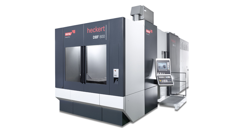

“For instance,” says Lee Scott, Starrag UK’s Director for Sales and Applications, “by adopting single set-up working on a Heckert 800 Athletic horizontal machining centre with DBF head (the DBF 800 machine), one company has slashed machining times on control valves from 20 hours to just 4.5 hours – achieving a 95% reduction in overall processing times and a 77% cut in cycle times.”
Complemented by a six-pallet linear storage system and 320-tool storage, the DBF 800 with its 45 kW/1,700 Nm torque/3,500 revs/min DBF head, runs unmanned and undertakes a non-stop routine of face milling using a 125 mm diameter cutter at a feed rate of 5,000 mm/min, end milling using a 50 mm diameter tool, solid drilling (70 mm diameter tool) then turning with 89 mm diameter tooling and a 300 mm diameter external turning tool.
The use of the DBF head ensures high process integrity and, of course, by undertaking complete machining in one set-up, the set-up not only reduces overall production times but it also obviates workpiece inaccuracies due to no re-clamping.

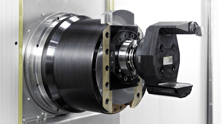

The DBF spindle head comprises a faceplate with integrated work spindle and CNC radial facing slide. For turning on a fixed workpiece, the rotating turning tool – which has an axial runout of just five/six microns – can be radially adjusted by +/- 35 mm. In addition to external, internal and face turning, the head also permits conical and contour turning courtesy of the radial facing slide’s NC axis.
For milling and drilling, the work spindle is arranged in its central position.

The DBF 630 has X, Y and Z axes travels of 1,070 mm, 870 mm and 1,200 mm, respectively, feed ranges of up to 60,000 mm/min and, as standard, HSK-A 100 toolholder (optionally SK 50) in the 45 kW work/DBF spindle. The DBF 800 has similar feeds, toolholder and spindle ratings but larger X, Y and Z capacities of 1,320 mm by 1,070 mm by 1,300 mm.
Both DBF machines also feature five-axis trunnion capability with an option also for turning, to enable access to all features including compound angle holes – thus turning, milling, boring, drilling and thread generation in a single set-up.

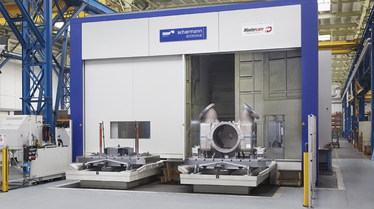

Roland Wozny, Product Sales Manager, highlights how the use of D?rries vertical turning machines and Scharmann four-axis Ecoforce horizontal machining centres in sophisticated manufacturing systems/cells where the welding of Inconel cladding (where machine rigidity – as available on these machines as well as the new Heckert DBF models – is paramount) is integrated into the production process and “is a development that is on the horizon”.
In the meantime, he points out how the D?rries Contumat double- and single-column, respectively, vertical turning lathes and Scharmann machining centres are already being used to great advantage in the production of oil and gas parts.
“Expansive machining capacities and torque ratings are available on these machines – on Dörries VCE models, tables up to 2,650 mm diameter for workpieces weighing 25,000 kgs, combined with 70 Nm torque on the main drive; on Dörries VC machines, tables up to 10,000 mm and torque ratings up to 833 Nm; and on the Ecoforce models, up to 4,500 mm in the X axis combined with 64 kW/4,000 Nm spindles.
“Utilising such capabilities, users are particularly already taking advantage of the ability to combine boring, milling, drilling and turning operations (even in the horizontal plane on the Ecoforce machining centres) in a single set-up by using, for example, live spindles, auxiliary heads and a wide selection of tooling (via automatic head/toolchangers).”
He adds: “The next major step of integrating into closed-loop production systems the welding process – of the Inconel cladding that is used to ‘protect’ parts that may spend 15-20 years in water – will see, for instance, Ecoforce machining centres being used to pre-machine components which are then sent for welding, then washing/cleaning before being returned to the Ecoforce for finish-machining as an integrated process. Manufacturing times are reduced from weeks to days.”
