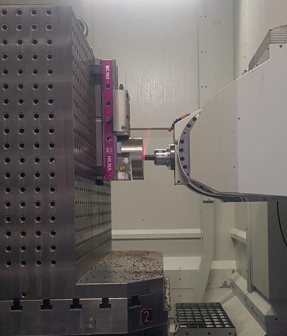

Starrag has eight machines in-situ at the AMRC and the accompanying Nuclear AMRC, and it was on the STC 1250 machining centre that two live machining demonstrations using a variety of Kennametal tooling wowed the audience.

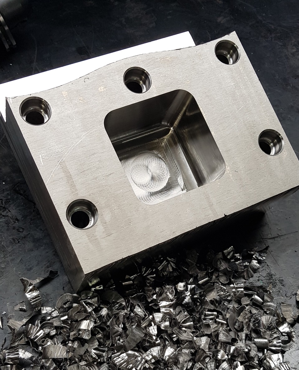

The first, on Inconel 718, saw a KCRA 63 mm diameter cutter with KYS30 ceramic for face milling taking 2 mm depths of cut at 5,052 revs/min and at 2,425 mm/min; followed by profile milling using a 32 mm KIPR end mill at 8,000 revs/min and 1,680 mm/min.
Next was plunge and pocket milling, plus heavy five-axis profile cutting (using the new HARVI Ultra 8X cutter at 65 m/min and 0.15 mm per tooth and 80 mm depth of cut and 10/25 mm width of cut) on titanium 6AL4V: using a 60 mm diameter flat bottom drill applied at 45 m/min and 0.12 per tooth; a 25 mm diameter HARVI 1 (four- flute) solid carbide end mill at 70 m/min and 0.12 per tooth; and a HARVI 2 (five-flute) 20 mm diameter solid carbide end mill to finish a pocket in a single pass at 110 m/min and 0.1 per tooth.
