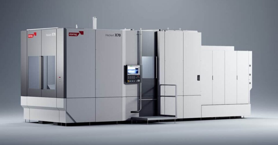

Starrag has now launched the Heckert X70, a versatile new 5-axis machining centre designed to deliver exceptional precision and productivity within a compact footprint. Building on the exceptional features of the acclaimed Heckert HEC X5 series, the Heckert X70 incorporates a swivel unit on the workpiece side, facilitating high-dynamic 5-axis machining from a single clamping position.
Receiving its world premiere at the EMO show in September on Stand C35 in Hall 12, the Heckert X70 offers impressive technical specifications with X, Y and Z axis travel of 1200 by 1100 by 1200 mm. The compact machine requires 18% less installation space than its predecessor, the Heckert HEC 630 X5. It accommodates workpieces with a core contour diameter of 960 mm and a maximum height of 800 mm, supporting a loading mass of up to 1000 kg, demonstrating no change to the working area. Within its robust and spacious dimensions of 8,150 mm by 3,700 mm, the Heckert X70 offers exceptional space utilisation without compromising performance.

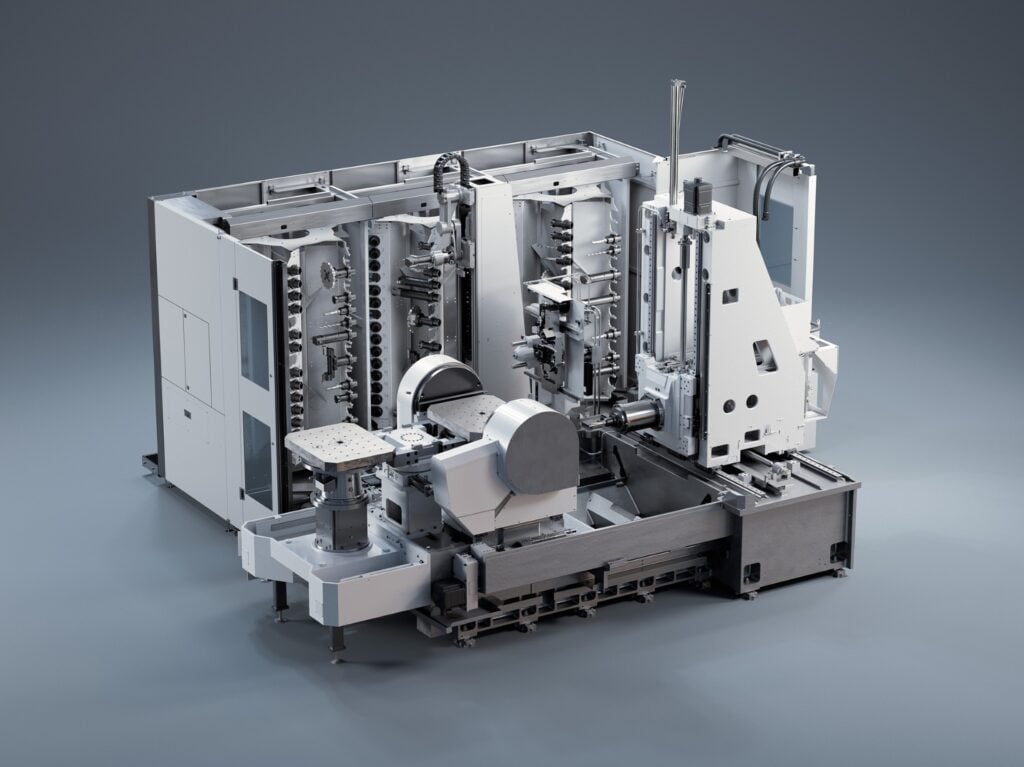

Efficient chip management is accomplished through a thermo-symmetric design and steep-angled fixed plates, complemented by an internal coolant supply operating at up to 80 bar pressures. This system ensures effective cooling and chip evacuation, with an additional flushing capability of up to 280 litres per minute for applications involving high chip volumes.
The Heckert X70 can be integrated with Starrag’s comprehensive automation solutions, including Fastems FPT round pallet store systems, different linear storage systems, or robotic cells, catering to various production requirements from small to large batch sizes. The Fastems FPT system provides an economical entry into production automation, enabling workpiece changes for small and medium batch sizes. In contrast, linear storage systems offer maximum flexibility for production processes with integrated master control for effective task planning and distribution.
The new Heckert X70 is based on the comparable four-axis Heckert H-series machine envelope. Instead of the NC rotary table installed in the Heckert H-series, the new Heckert X-series models feature a robust rotary/tilt table – an in-house development that is also manufactured at the Starrag plant in Chemnitz. Not only does the tilting unit have two equally sized bearings, but also a thermally stable design. This means that the machines can complete five-sided, highly dynamic machining of complex components.
