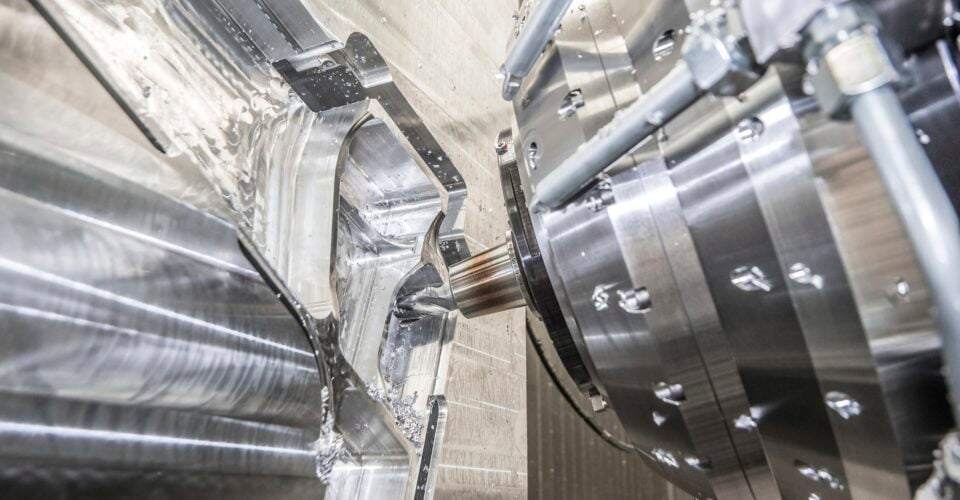

Even after 25 years, the technology behind it still amazes. The drive head contains a highly dynamic, 3-axis kinematic system, which, unlike conventional fork heads, swivels via articulated kinematics and thus enables rapid, precise tool movements. The mechanics are based on three Z-modules that ensure linear movements – free of contact rings and rotary couplings, which increases rigidity, reduces wear and ensures consistently high precision.
First military, then civilian
The Sprint Z3 was introduced as the central element of the new ECOSPEED series – a high-performance machine series for the fast cutting of large aluminium components. Originally developed for military structural parts, the parallel kinematics concept quickly became established in civil aviation as well. Today, this 3-axis machine is the global standard for machining complex aircraft structures.

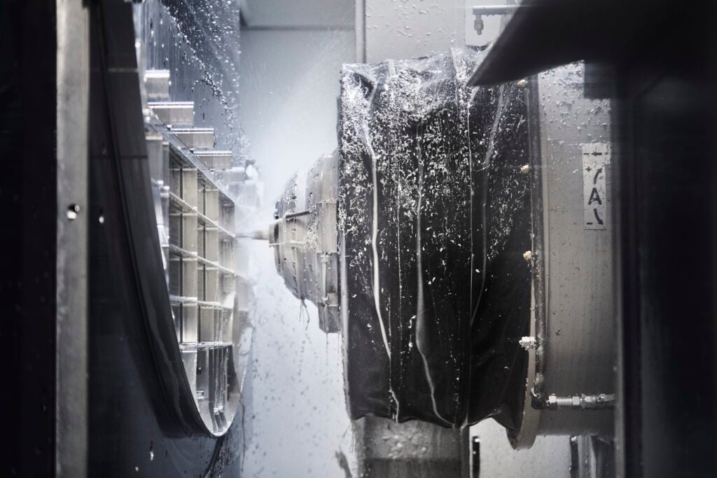

Fast machining of A350 wing ribs
The example of Korea Aerospace Industries (KAI) shows just how efficient this connection is. The company operates one of the world’s largest interlinked ECOSPEED lines – with nine machines, four set-up stations, two transfer carts and around 90 pallets. The machining times for the wing ribs of the Airbus A350 have been reduced to around a fifth of those for earlier conventional aircraft. The availability of the line is around 97% – proof of the high efficiency and reliability of the system.
