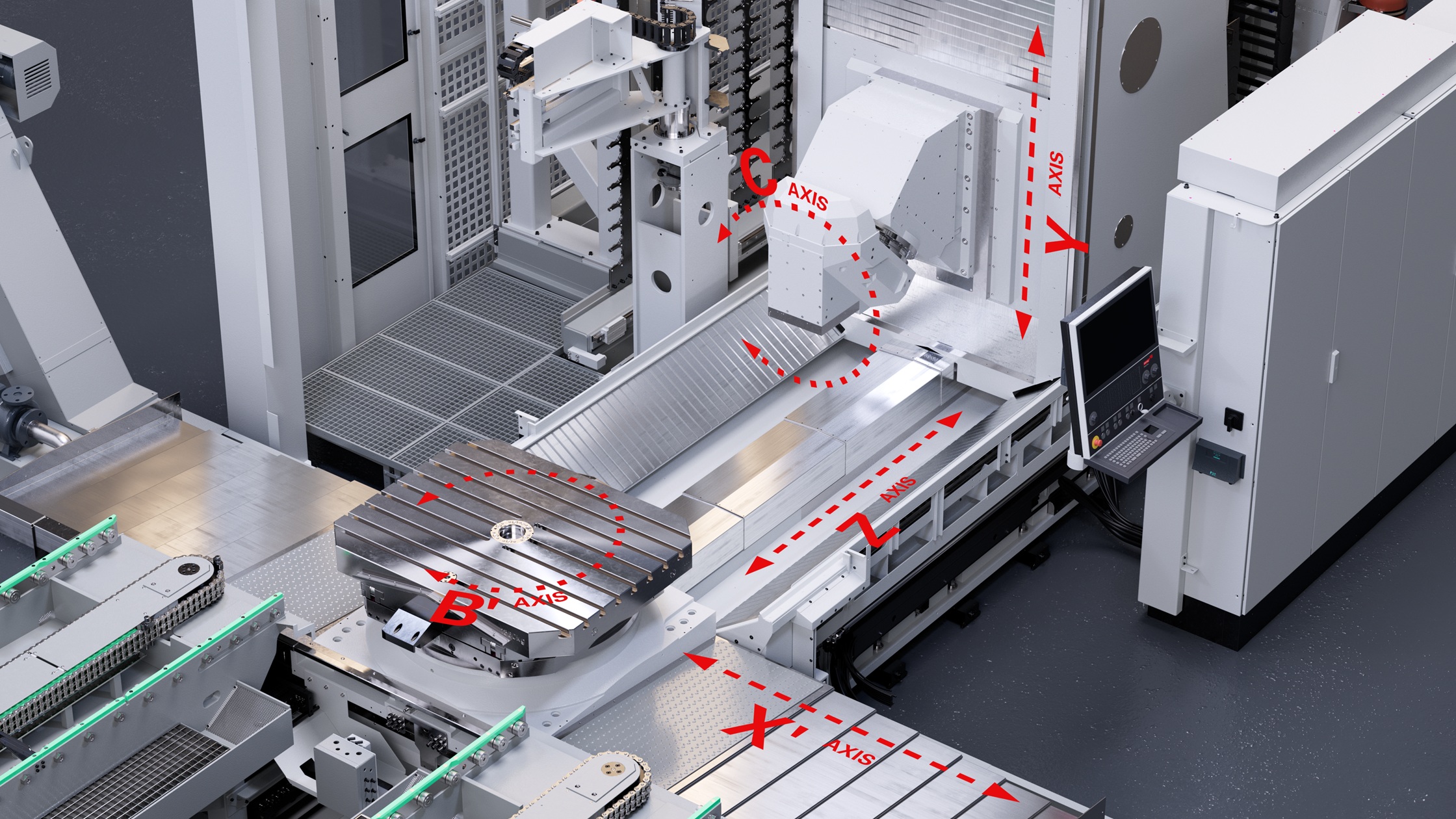

Starrag’s HPMS (High Performance Machining Systems) business unit, which includes the Chemnitz and Rorschacherberg sites, has developed a new large machine construction kit from which new machining centres can be derived. For example, a Heckert large machine presented at the Open House in Chemnitz will replace the successful Heckert HEC Large Athletic series in the future.
The compelling reasons are based on the proven Heckert principles, such as rigidity and precision, which the company continues to hold as the highest priority. The movement sequences remain unchanged, and the advantage of this consistency is that the effort involved in transferring existing technology is limited. Operators of the previous Heckert HEC Athletic series will quickly adapt to the new machine models. Customers can also transfer devices and NC programmes without any issues.
The developers considered the latest technical aspects when redesigning the large Heckert machines. For example, the frame components, such as the beds and columns, were optimised for thermal symmetry. If the ambient temperature changes, the core components expand or contract evenly in all directions. This behaviour is predictable and correctable. The chip fall in the area between the work spindle and the workpiece has also been improved so that hot chips have minimal opportunity to transfer heat to the workpiece or the machine.
An important advantage of the new machines is the improved productivity. The decisive factor here is an increase in the diameter of the ball screws from 63 to 80mm. A further stiffening of the structural components complements this. As a result, users can now achieve even higher cutting values, increase chip volumes and ultimately reduce machining times. The machine has also become faster. Instead of a 40m/min rapid traverse rate, it now enables 50m/min, reducing non-productive times.
The approximately 20% smaller footprint is another compelling argument in light of high floor space costs. This is primarily due to the repositioning of an energy chain, which enables the chip conveyor to be integrated further into the machine. Additional detailed improvements include structural changes that allow for a payload of 20 tonnes, thereby opening up new part families and customer groups. The Starrag developers also redesigned the energy console at the rear of the machine, consolidating all maintenance-relevant elements in one location.
