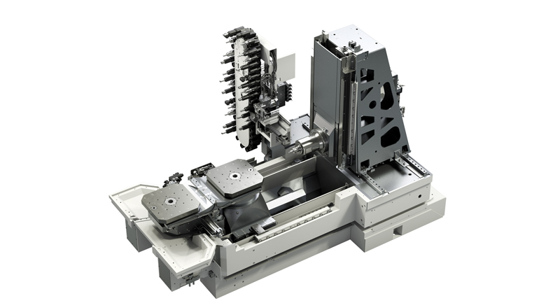

Many aspects of Starrag’s well-proven machine construction principles are applied to the machines which share a common platform – including a mineral bed for optimum temperature and vibration resistance, linear guideways and a centralised swarf conveyor, as well as unified and easily accessible coolant and lubricant systems – leading to minimal downtime and therefore high levels of reliability.

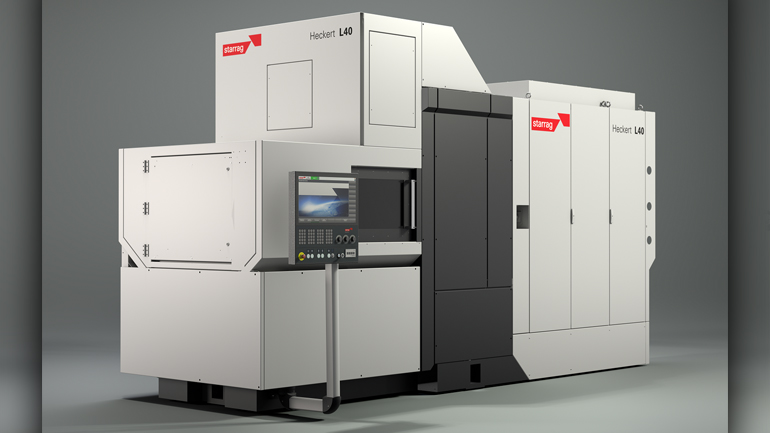

Heckert L40, L50, L55 – with X, Y and Z axes travels of 560 mm by 550 mm by 680 mm (L40) and 700 mm by 550 mm by 780 mm (L50 and L55), able to accommodate workpiece heights up to 600 mm and loads of 600 kgs (L40) and 800 kgs (L50 and L55). The up to 20,000 revs/min spindle offers torque values of up to 453 Nm.

The new linear models – including the L40, above – boast productivity gains over twin-spindle competitors because traditional twin-spindle machines usually only achieve productivity levels that equate to 1.5 spindles, due to inefficiencies and the consequences of losing two spindles when the machine stops
