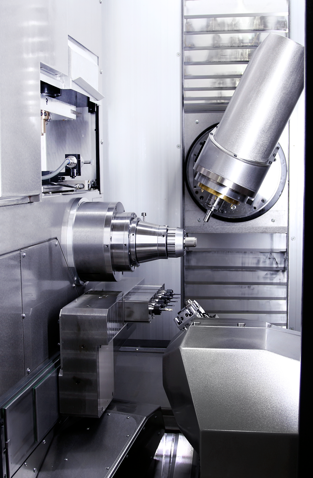

“Personally, I knew about Bumotec machining centres because a few customers were already equipped with their technology. I convinced our Operational Director, Daniel Fernandes, who was not accustomed to this mindset, that it was the right solution to work 24/7 without interruptions by just loading bars and producing finished parts. Today, he has changed his mind and only wants to work this way, believing that it is the most efficient and productive production solution. When the decision was made to invest, we contacted Tornos Iberica, the Bumotec agent in Spain and Portugal. We discussed our project and then visited Starrag Vuadens, the home of Bumotec in Switzerland, becoming the first Portuguese company equipped with a Bumotec s181, the most complex dual working station 9-axis machining centre from Bumotec,” Bruno continues.
“The decision to invest in the Bumotec s181 was made based on two parameters. First, the efficiency of the machine is enhanced by the counter spindle operating in hidden time, which allows us to reduce production time by 40%. Despite being one of the most complex machining centres in the Bumotec range, it offers incredible possibilities for making production as cost-effective and stable as possible. This capability is supported by the bar feeder, which operates autonomously 24/7, including on weekends.”

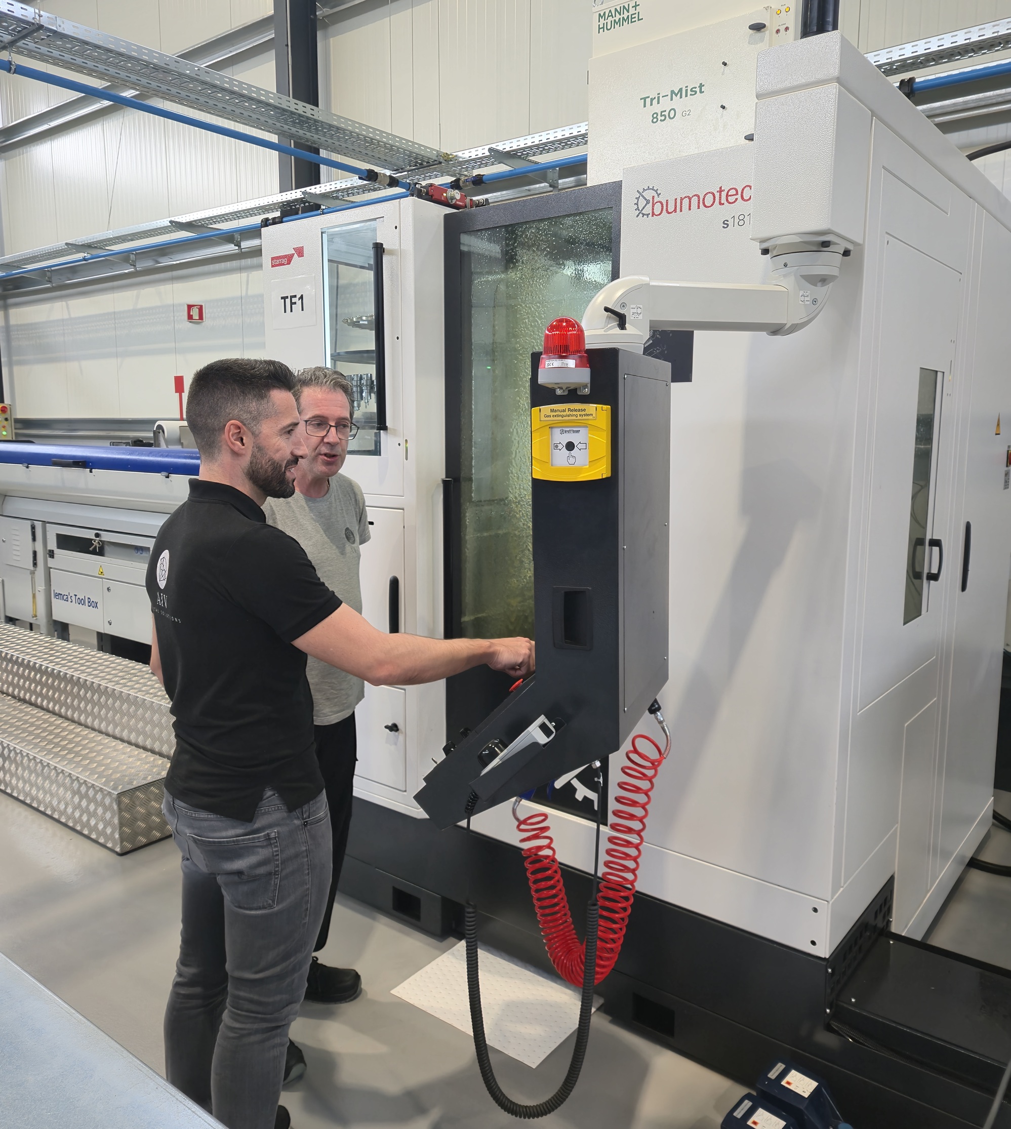

“Additionally, we conducted machine tests with various raw materials, including cobalt, stainless steel, titanium, and brass. The results were impressive, and the cutting tool’s lifespan has increased significantly. Since acquiring the Bumotec, we are still on a learning curve to understand the full benefits of the machine and how far we can push the limits on tool life.”
Discussing the morning routine, Daniel Fernandes continues: “The daily routine is quite simple. When we arrive in the morning, we inspect the parts produced at night, then check the tools and clean the machining area. Fortunately, we have spare tools in the tool magazine in case of breakage at night. This ensures the machine will automatically control and replace the tools, if necessary, without manual intervention. Finally, we add some bars to the bar feeder, and we launch the production again for the day. We do a check before leaving for the night, and we repeat the routine again the following morning.”

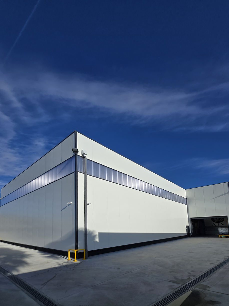

Looking to the future, AIV CEO Bruno Correia concludes: “My vision for the next 5 years is to be a leading precision machining subcontractor in Portugal before reaching the same status in Europe. Our strategy is to diversify in the MedTech industry and defence segments with connectors while expanding in the luxury goods world. Simultaneously, we are enhancing the galvanic process of anodising to provide a complete solution on raw materials as well.”
“We have added a new building extension for our machining division and we have space available to welcome a new Bumotec machine in the future when the business reaches a crucial point.”
