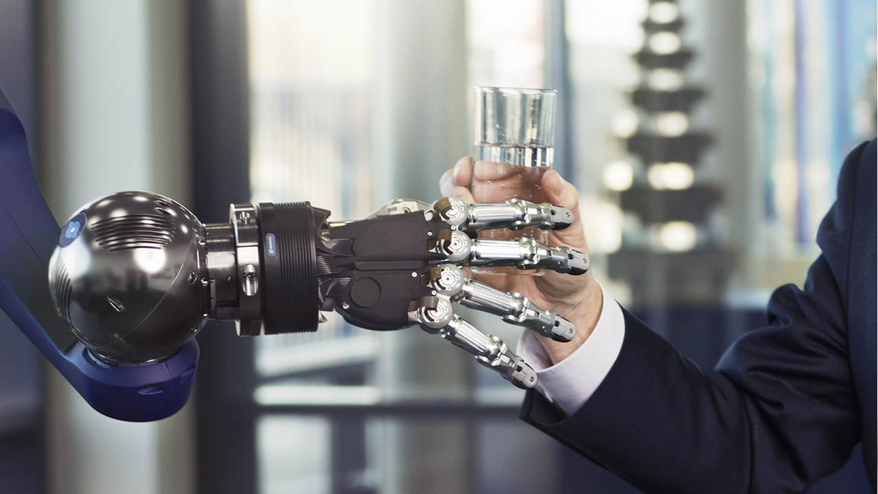

Whereas grippers were previously designed for industrial automation based on robustness, longevity, and performance, with gripping hands, the focus is on the aspect of flexibility of motion. The closer humans and robots work together, the greater the relevance of humanoid 5-fingered hands will be. "In extreme cases, humans and service robots will share one and the same workstation, including all tools and auxiliary equipment," explains Dr. Martin May, Head of Research/Advanced Technologies at SCHUNK. For this reason SCHUNK already had the SVH 5-finger hand certified by the DGUV as the world's first gripper for collaborative operation in 2017. Its five fingers can carry out all kinds of gripping operations with the help of a total of nine drives. What is more, numerous gestures can be performed, thereby facilitating visual communication between humans and the service robot and increasing acceptance for its use in human environments.

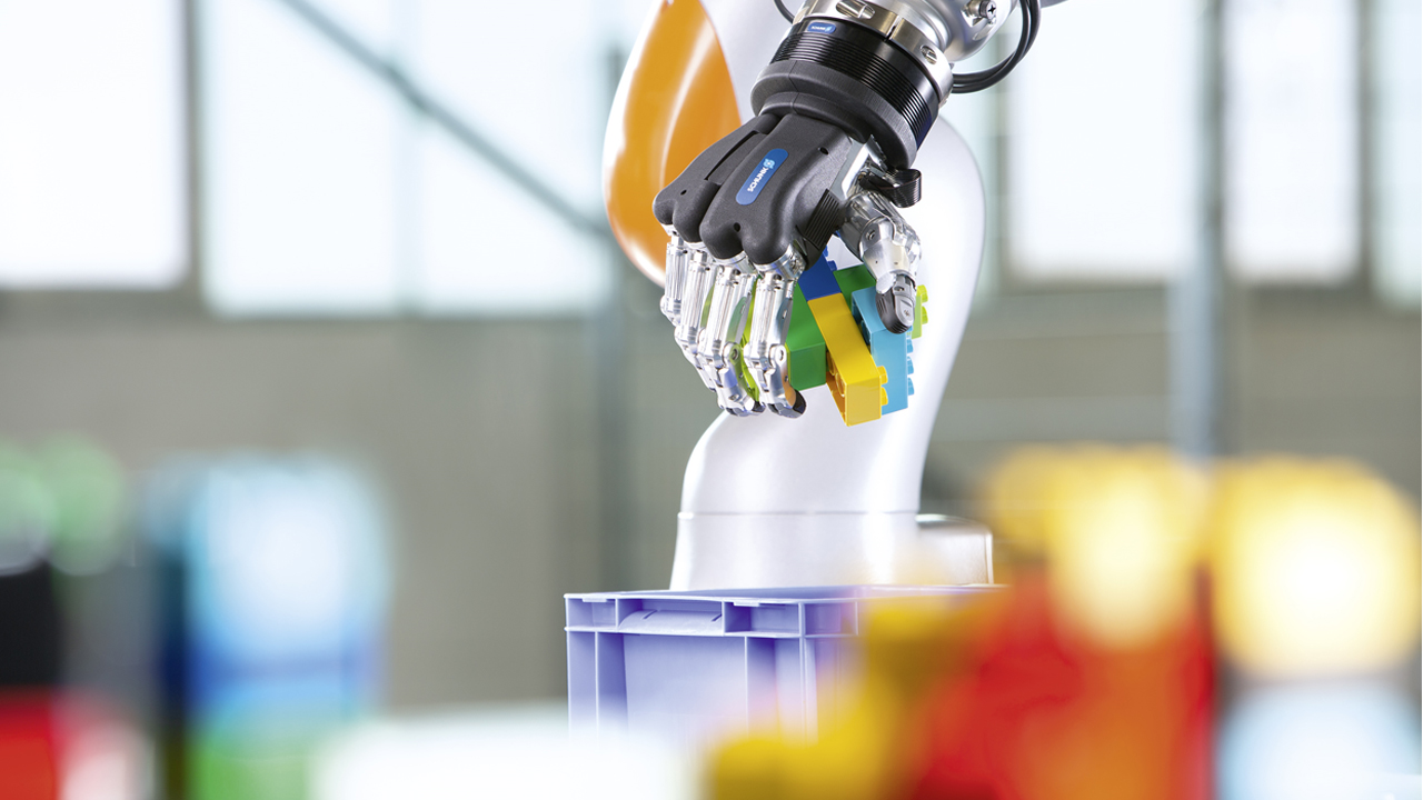

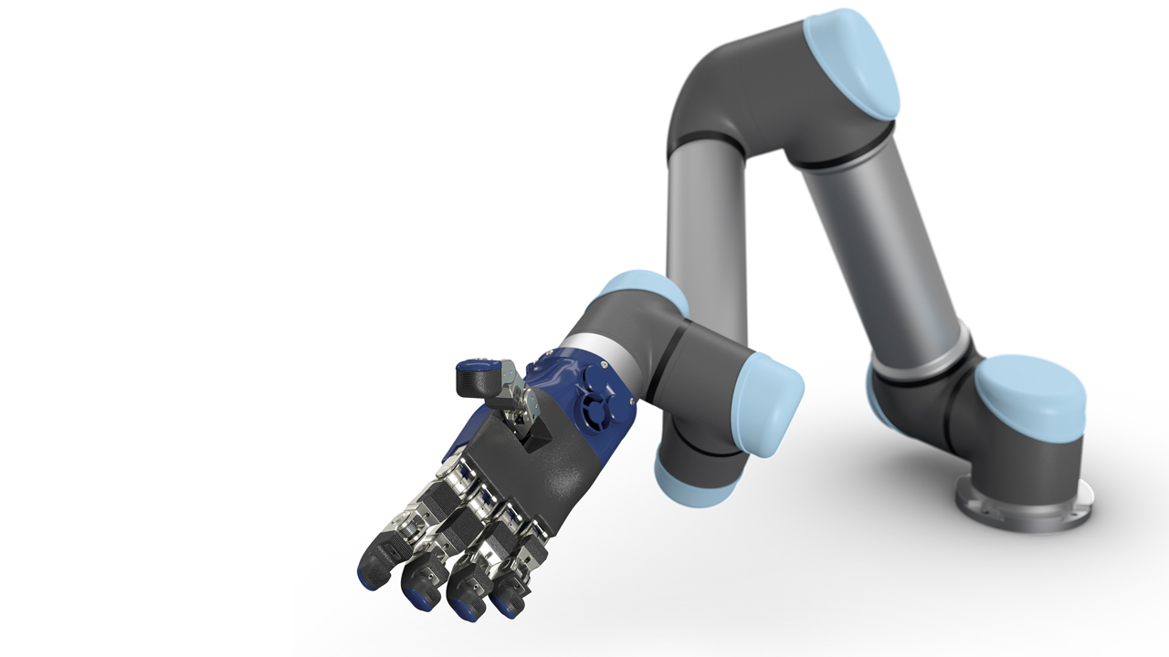

In line with the relevant application, SCHUNK has various gripping hands within its portfolio, starting from a 2-finger hand reduced to the basic functions of gripping for service robotics, to the industry-compliant 3-finger hand SCHUNK SDH and the complex SCHUNK SVH 5-finger hand. The latest model, the SCHUNK SIH is likewise equipped with five fingers and with a structure similar to humans. However, it differs from the SVH fundamentally in terms of drive and kinematics. Whereas the SVH, which is driven via nine motors, complies with the typical aspects of a precision working robot hand, the SIH, which is equipped with five motors and actuated via pull cables is much more based on its human counterpart with its veins and muscles. Three of its fingers can be moved independently of one another and the two smallest in turn move together as a team. As a result, the SIH can be deployed more flexibly than other gripping hands with pull cable mechanisms that are available on the market, and at the same time it is more robust and lower in price. According to Martin May, particularly this latter aspect was a key requirement for the research project, for particularly when it comes to service robotics applications in domestic environments, strict management of costs is a must if they are to be successful on the market. In order to attain the goal of affordable, simple-to-operate 5-finger hands for versatile applications, SCHUNK makes use of experience from bionics as well as the latest motor and electronics concepts. Using intelligent gripper control, a wide range of gripping projects can be realized via a simple-to-operate interface without having to program these precisely.
