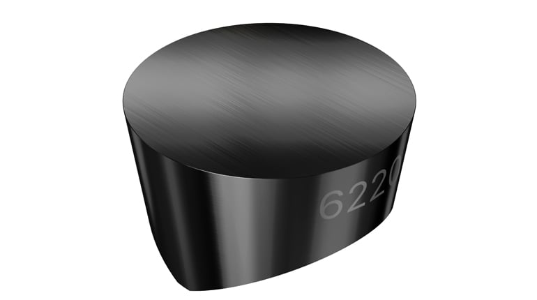

Cutting tool and tooling system specialist Sandvik Coromant is introducing two new ceramic insert grades that are capable of performing high-speed, high-security turning operations on components made from demanding HRSA (heat resistant super alloy) materials. The CC6220 and CC6230 ceramic grades have been developed to machine demanding materials where whisker ceramics and SiAlONs fall short. Their ability to handle higher cutting speeds contributes to reduced cost per component, while inherent machining security ensures that quality is not compromised to help manufacturers produce high quality parts, time after time.

One of the most common applications to benefit is expected to be the turning of turbine discs. In a customer example machining a low-pressure turbine (LPT) disc made from Rene material (42-45 HRc) as part of the intermediate stage machining process, a CC6220 RPGX insert was deployed to perform pocketing and CC6230 RPGX inserts for rough-turning operation at cutting speeds as high as 400 m/min (1380 sfm). The process achieved a metal removal rate (MRR) of 80 cm3/min (5 inch3/min).
