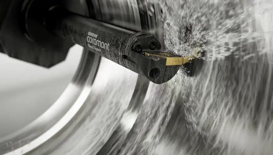

Sandvik Coromant, a global leader in cutting tools and tooling systems, has introduced an expanded range of its next-generation Silent Tools turning adaptors, enhancing vibration-damping performance for internal turning operations. The update adds new sizes and configurations, including adaptors with Coromant Capto and HSK-T couplings, alongside the launch of Tailor Made customisation options for greater process optimisation.
Åke Axner, Global Product Manager at Sandvik Coromant, said:
“These upgraded adaptors enable safer, faster, and more productive machining at long overhangs. Tailor Made customisation meets specific customer needs and helps optimise cutting processes for improved performance.”
Key features and benefits include:
  • Expanded offering: 75 new Coromant Capto adaptors (32–100mm diameter) and 6 new HSK-T adaptors (32–60mm diameter) added to the portfolio, now totaling 187 tools across cylindrical, Coromant Capto, and HSK-T variants.
  • Advanced vibration damping: The upgraded Silent Tools feature a sophisticated damper body precisely machine-assembled and calibrated for optimal frequency tuning, replacing the earlier manual adjustment process.
  • Consistent, reliable performance: The enhanced damping mechanism ensures stable vibration control across various length-to-diameter ratios, boosting machining repeatability and reliability during long-overhang internal turning.
  • Broader industrial applicability: Ideal for internal turning, parting, grooving, and threading in sectors such as aerospace, power generation, oil and gas, general engineering, and machine tool manufacturing.
  • Cost and productivity gains: By reducing vibrations and minimizing interruptions, Silent Tools increase metal removal rates, improve surface finishes, enhance process security, and lower cost per part — contributing to higher profitability and competitiveness.
