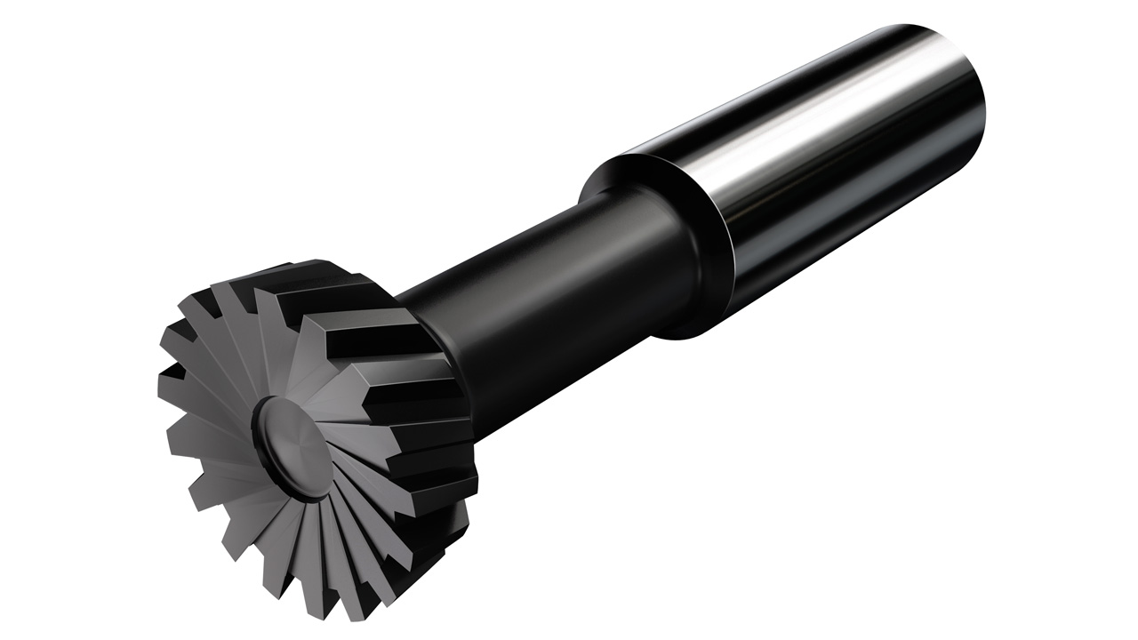

The power skiving solution from Sandvik Coromant comprises solid bore, solid shank and indexable cutters. CoroMill 178S (solid carbide) is for use in applications where high volume, high rpm machining with long tool life is required, while CoroMill 178H (powder metallurgy HSS) is for general use on shoulders or small diameters. These tools offer the highest tool accuracy regarding run-out and pitch compared with indexable tools, providing a better finishing profile of the gear and spline. Reconditioning can typically be performed up to 10 times depending on the quality of the tool.

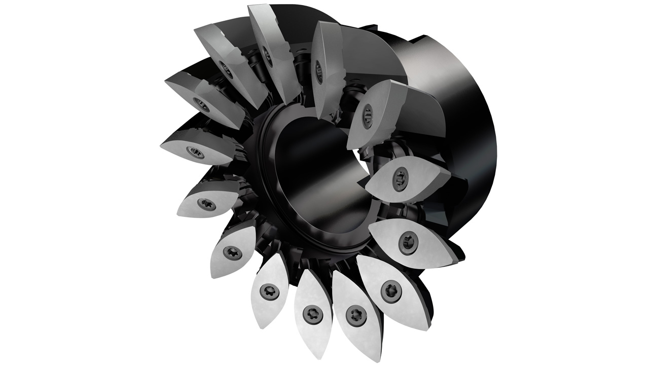

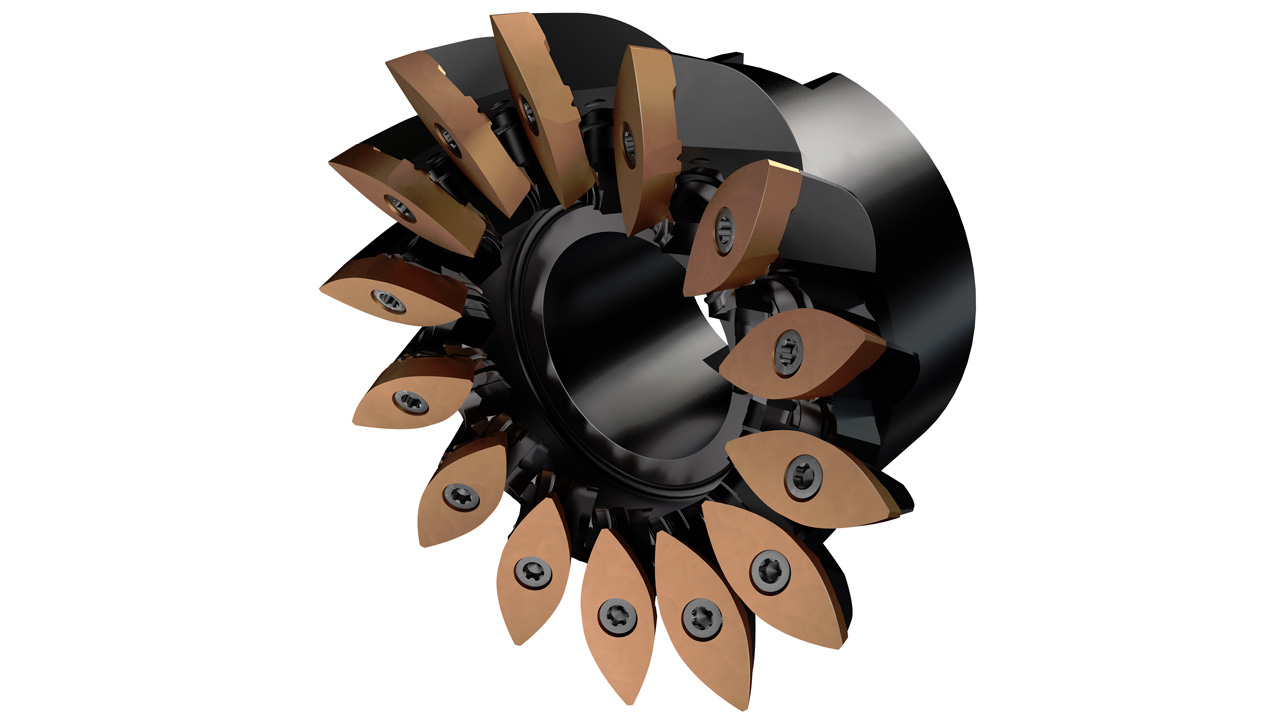

CoroMill 180 indexable cutters are for high-volumes, roughing on large range of gears (module 2-9). Among many notable features is a positive rake angle for light cutting action and the potential for dry machining, which saves on coolant costs and helps to protect the environment.

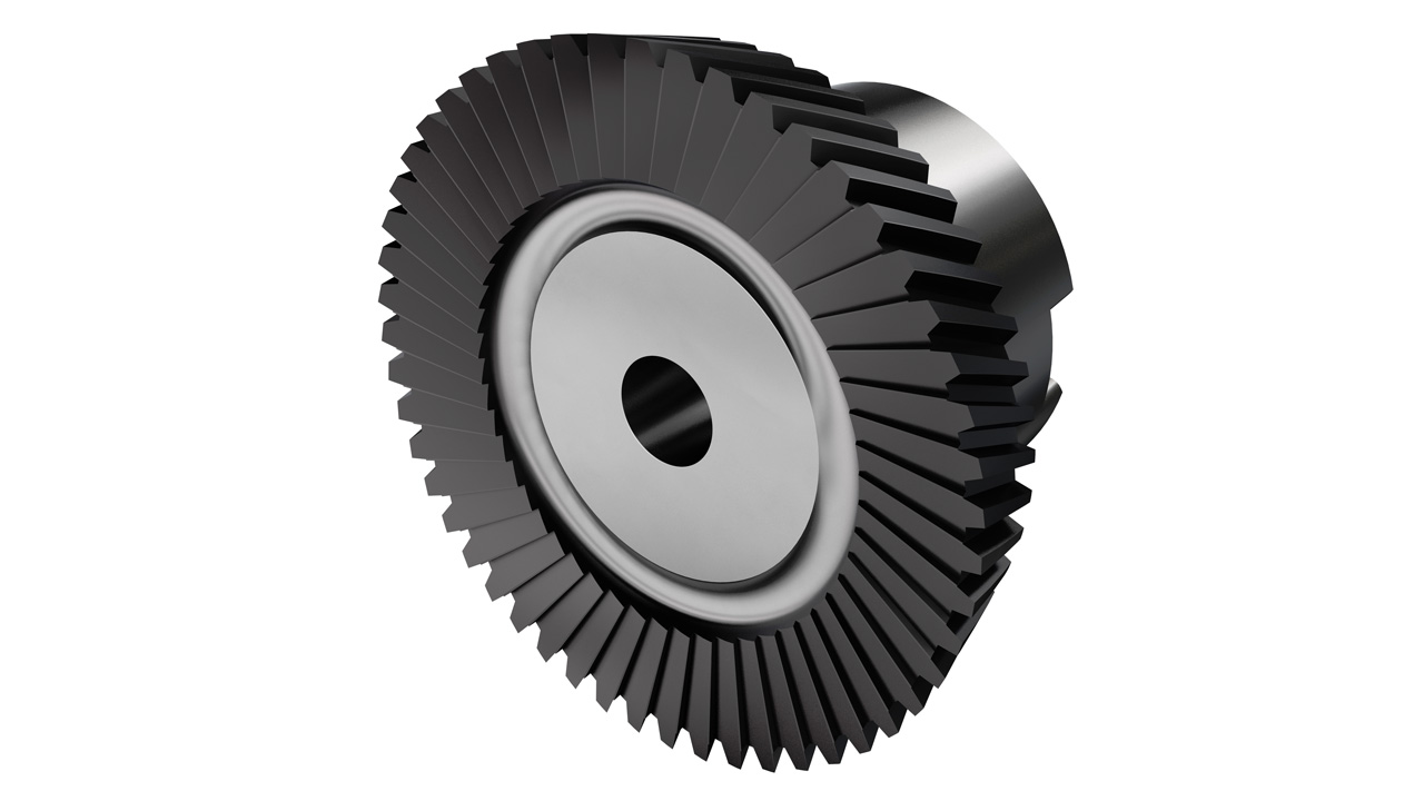

Among those set to benefit most are manufacturers in the automotive industry, as the tools support new developments in hybrid cars, as well as electromobility for cars, trucks, tractors and excavators. Typical applications include internal and external gears and splines – and cylindrical spur and helical gears – for automotive transmissions, as well as a variety of other gears, coupling components, splines, shafts, synchronization rings and CV joint parts.
