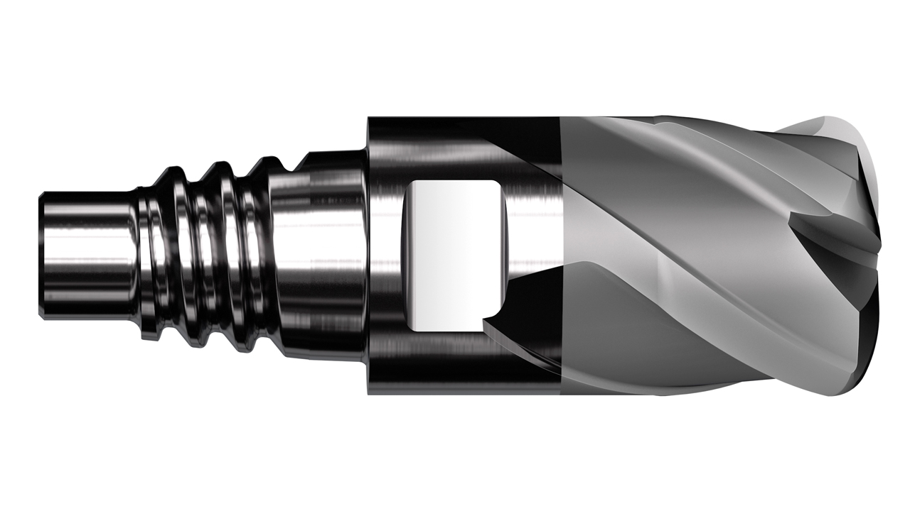

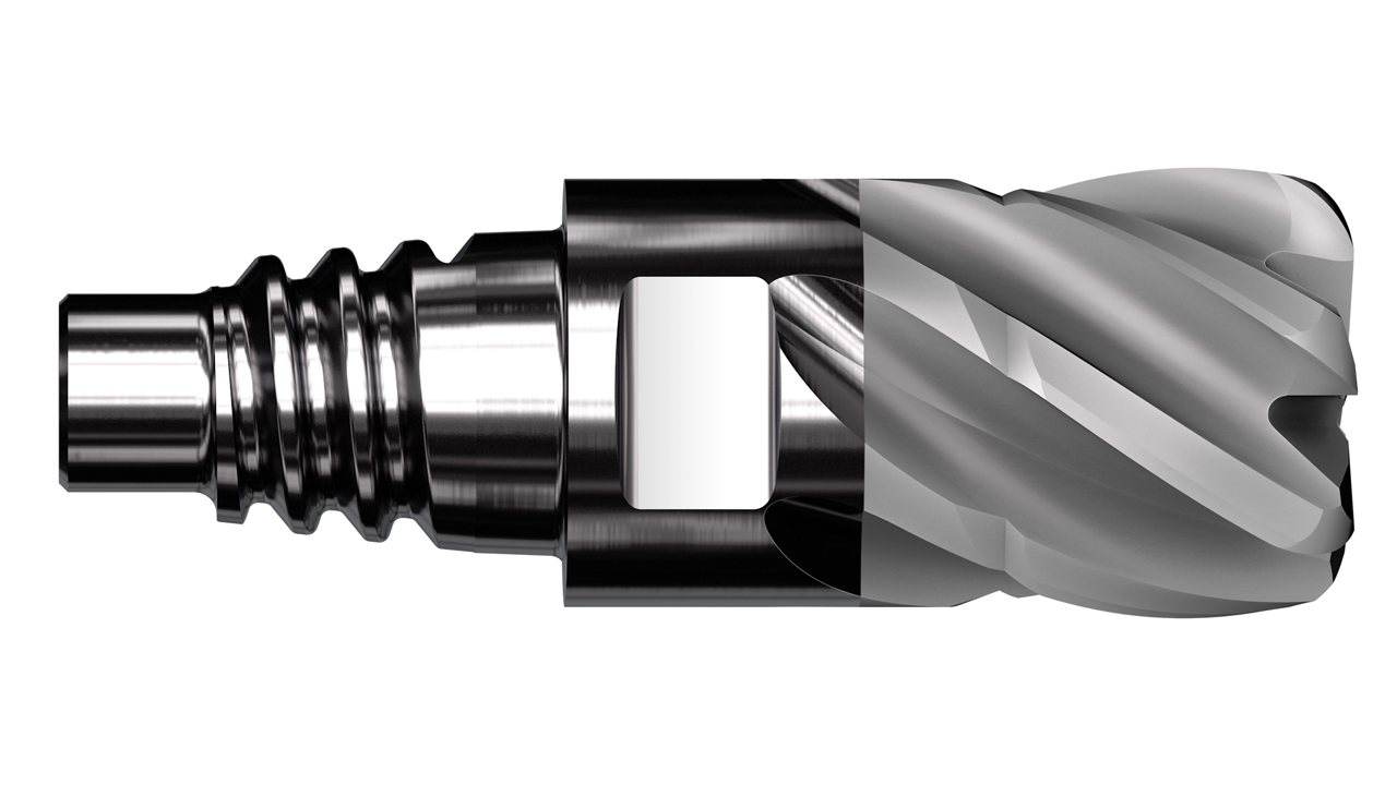

“The ceramic substrate of the latest CoroMill 316 and CoroMill Plura end mills allows for a different cutting process than traditional solid-carbide tools,” explains Tiziana Pro, Global Product Manager Solid End Mills at Sandvik Coromant. “Our unique CC6060 grade is purpose-designed for the superior machining of nickel alloys, and is supported by negative geometry that provides a tough cutting edge.”

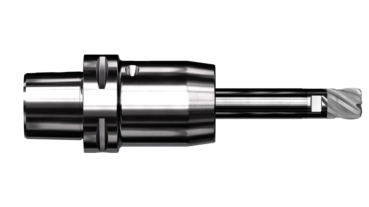

In fact, six-flute geometry delivers highly productive side milling operations, while four-flute geometry boosts face milling in both the CoroMill 316 and CoroMill Plura versions. Choice between the two depends on machine conditions and application. Those seeking solutions to difficult-reach applications, or looking for extra flexibility courtesy of the exchangeable-head system, should opt for CoroMill 316, while engineers requiring superior stability are advised to select CoroMill Plura.

The newly introduced series also includes a ceramic ball-nose version of CoroMill 316 for blisk machining. This profile-milling solution is suitable for semi-finishing operations.
