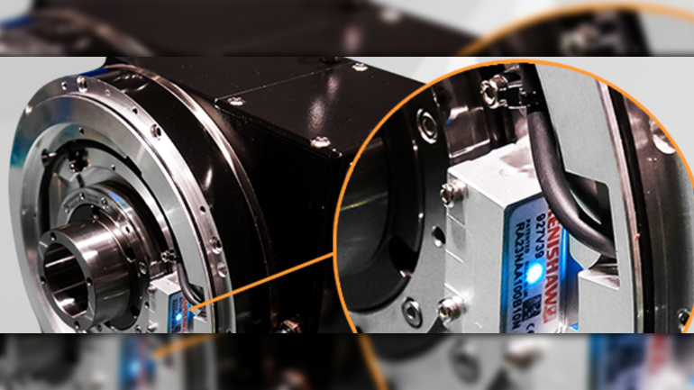

SOLPOWER has been actively developing a number of high-performance direct-drive (DD) rotary tables for the precision machining industry that greatly enhance efficiency and yield. Renishaw's RESOLUTE absolute optical encoders are compatible with a variety of industrial serial protocols and provide high-performance feedback control of the DD mechanism.
DD rotary tables eliminate mechanical linkages, for example as required for traditional worm-drive stages. Benefits of a gearless rotary table include higher speeds (RPM), faster response times, zero backlash, low noise and space saving. This amounts to an overall reduction in processing times and costs for the end-user.

SOLPOWER's SDRT series rotary tables have a single rotational axis and are designed to be compact with a high-torque and high-speed response. When integrated into the SDRT rotary table design, the RESOLUTE RESA absolute rotary encoder series offers 23-bit resolution; positioning accuracy and repeatability after compensation of ±10 arc seconds and ±4 arc seconds, respectively; maximum speeds up to 200 RPM and IP67 protection – sufficient to meet the requirements of the vast majority of precision light machining applications.
Mr Peng continues: “These rotary tables have limited space and so the encoder readhead volume, in particular, needs to be small; ease of installation is another important consideration.
Renishaw's rotary encoder has a unique patented taper mount that effectively reduces installation errors and improves our assembly-time efficiency. Renishaw's support engineers provided training to enable our staff to install the scale.
