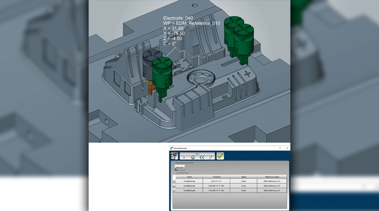

One important new feature introduced in the previous version has been improved even further in hyperMILL® 2018.2: the electrode module, which automatically derives electrodes from the faces to be die-sunk within the component geometry. With the ‘Virtual Electrode’ function, copies of an electrode that has already been created can now be generated in various different positions. These are checked for collisions and can be assigned the technology values of the master electrode or new technology values. During electrode milling, these values are processed accordingly. The reference system and eroding position for each copy are included in the report.
