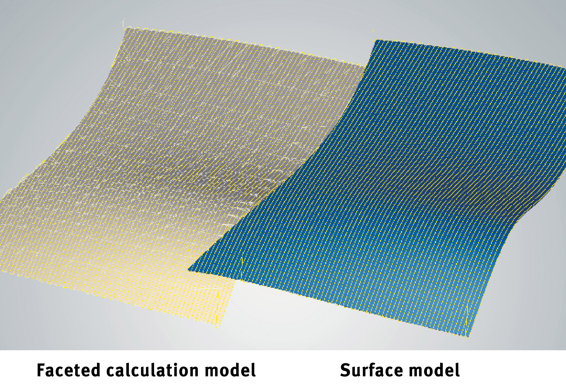

In hyperMILL 2019.2, the hyperCAD-S function ‘Global fitting’ is directly integrated into the CAM strategy in 5-axis tangent machining. With this function, multiple faces can be joined into one face with defined ISO orientation. The principle of using CAD elements for CAM programming is also applied, for example, for automatic face extension. With the automatic face extension, the bounding surfaces are automatically extended during programming to improve the edges of the machined surfaces. This greatly simplifies programming, since these adjustments are made within the CAM strategy, without switching to the CAD environment.

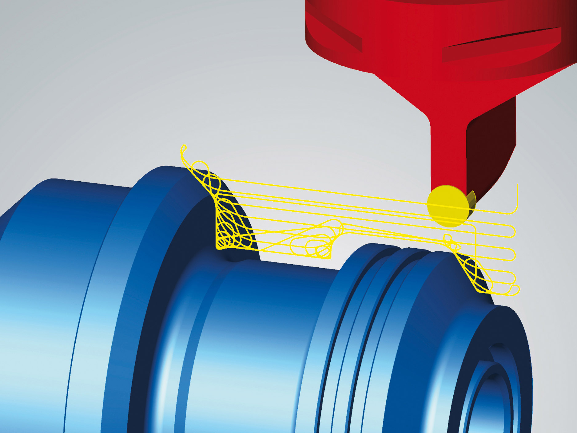

In the last version of hyperMILL MAXX Machining, turn-roughing was implemented with trochoidal toolpaths. Optimised connecting paths and fluent machine movements ensure high-performance machining. This means significantly higher machining values can be driven compared to conventional roughing methods. Version 2019.2 guarantees even greater process reliability for high-performance turning and tool life monitoring makes it possible to restrict the use of a tool by the distance covered, the number of toolpaths, or a time limit. If the defined limit is reached, a retract macro is generated automatically and the job ends.

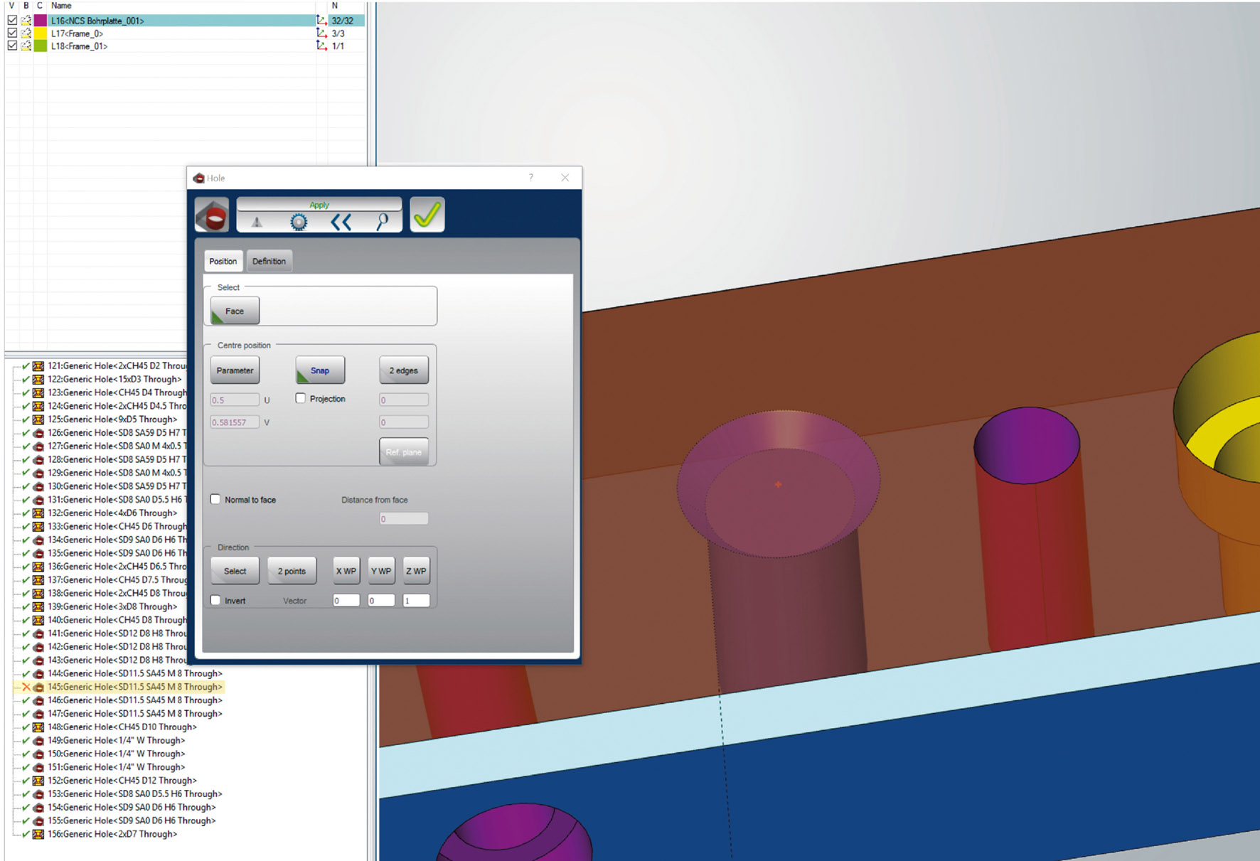

Hole feature linking means that model changes made to CAD features are automatically transferred to hyperMILL. Since design changes in CAD are associatively linked with the CAM system, users can quickly and securely make updates.

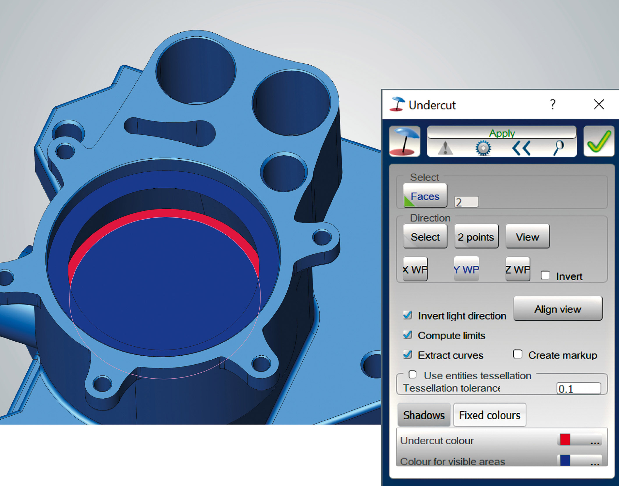

An interesting new function is available for users who work with very large parts with hyperCAD-S. It enables the workpiece mass and center of mass to be calculated with a material definition for solid, mesh and stock models. Another highlight of the CAD portion of the suite is the ‘Undercut’ function, which makes it possible to detect undercut areas on components quickly and reliably. Moreover, the new ‘Local curvature’ analysis function makes it possible to detect curvature radii on components. The minimum curvature radius, which often plays the biggest role, is output immediately. The user can then determine the best possible lead angles or tool radii for machining curved faces.
