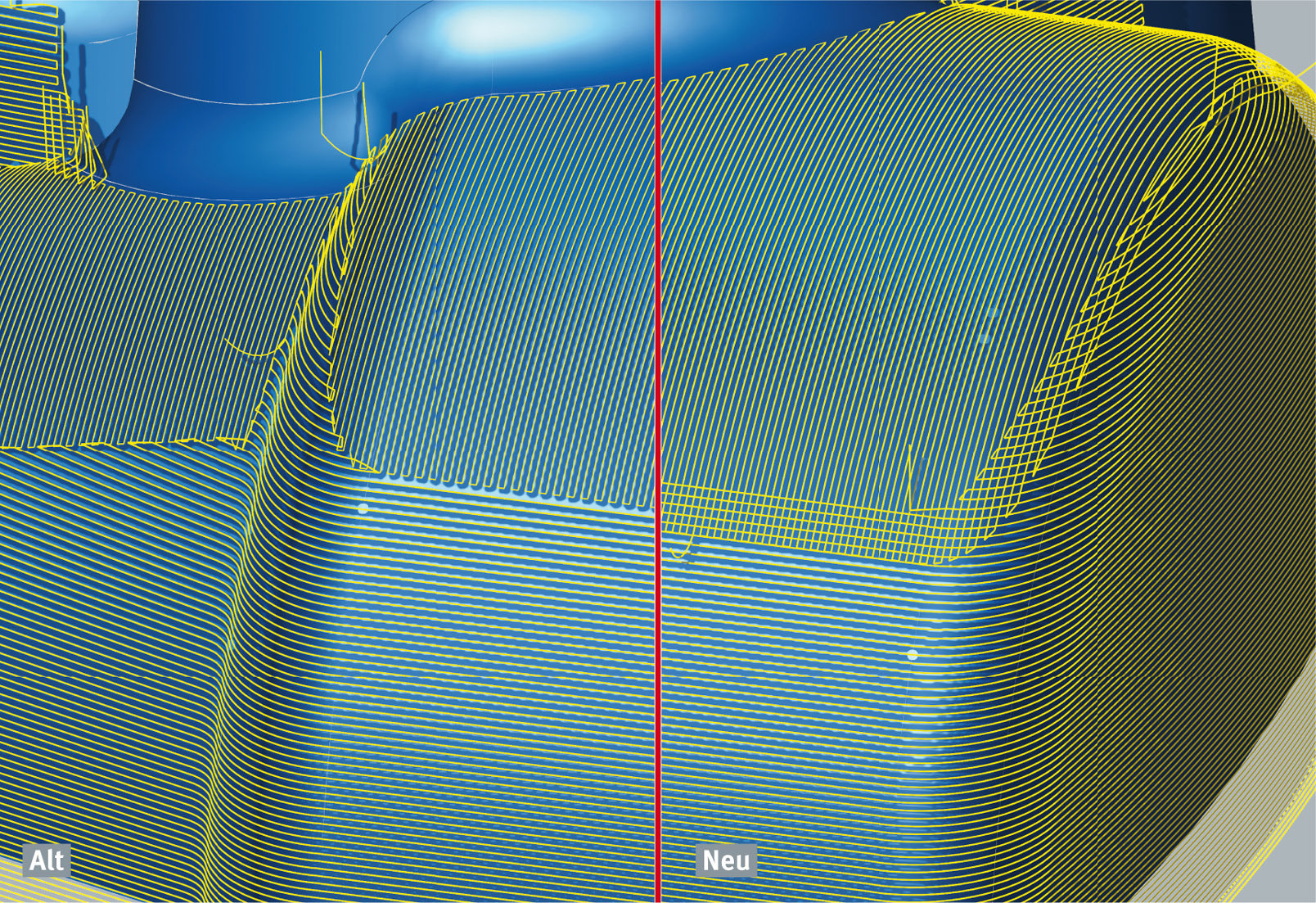

Smooth transitions
Machining marks are often visible at transitions between steep and flat areas, or at the extents of rest machining regions. The new ‘soft overlap’ function in hyperMILL® greatly reduces this effect. The milling tool is briefly lifted to blend the milling paths into one another. This prevents visible transitions from being created and results in better surface quality.

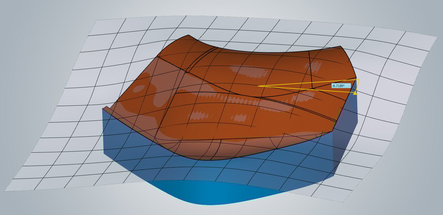

hyperCAD®-S: CAD for CAM users
The CAD module in version 2018.1 of the OPEN MIND CAM suite boasts a particularly time-saving solution: ‘global fitting.’ Global Fitting creates a single cohesive face from a set of multiple faces. Many CAM strategies can then follow the ISO u-v orientation of the surface patch, increasing the application of these CAM strategies.
