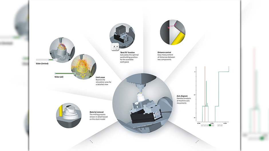

hyperMILL® VIRTUAL Machining Center

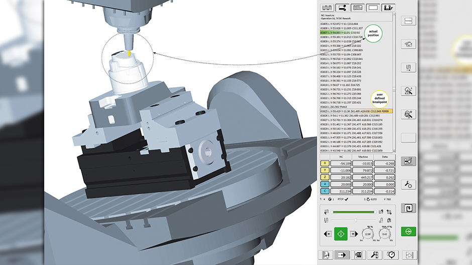

The Machining Center simulation functions assure fully reliable machining, thanks to an NC code-based simulation following the post-processor run. This creates a direct link between the NC program and the postprocessor. Actual machining operations, including transition movements are mapped virtually, thus allowing for a comprehensive simulation. This enables users to generate NC code-based simulations of virtual machine movements that precisely match the machine movements in real life, allowing operators to reliably prevent collisions, among other things.
Machine simulation is carried out with a defined machine model, taking into account the workpiece and tool as well as the tool holder, fixtures and clamps. Axes can be moved manually in the simulation, axis limitations are indicated and limit switch traversals are detected automatically. Individual processing steps can be simulated separately or used as a starting point for the simulation. The simulation checks each movement before the machine lead-in, which means that the hyperMILL® VIRTUAL Machining Center delivers maximum processing safety.
Various analysis functions further enhance safety and bring added transparency to the table by enabling users to thoroughly check machining situations. For instance, the best-fit function allows for reliably checking the machining area. It automatically calculates the optimal workpiece placement based on the workspace available. On the actual shop floor, this will frequently prevent time-consuming adjustments of the machine setup. Axis diagrams deliver key information analysing the traverse movements of the different axes in detail. This helps operators to quickly identify unusual movements and correct them in the machining job before the program is transferred to the machine.

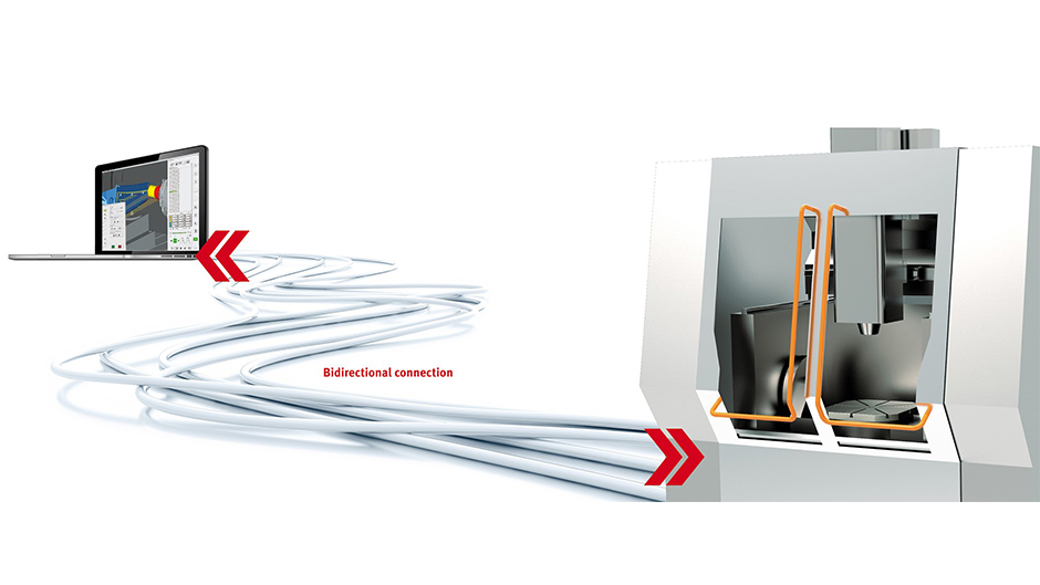

hyperMILL® CONNECTED Machining
hyperMILL® CONNECTED Machining enables networking and synchronisation with the machine. The deep link created by the module provides a means for bi-directional data exchange with the control. This means that users can send data to the machine and execute it there, as well as receive data from the machine. Therefore, the simulation provides actual machining data in real time. This way, the CAM system and machine world are networked in the best possible way.
Before starting the machine, a safety protocol is executed to compare various machining and machine configurations. This includes reading out zero-point definitions, tool data and machine configuration parameters and checking these against the program data in hyperMILL®. The actual machining job will only start if these data sets match and if the collision check did not come up with any issues. As an additional safety feature, the NC programs are loaded directly into the memory of the control system, making it impossible to mix up the programs or access data without authorisation.

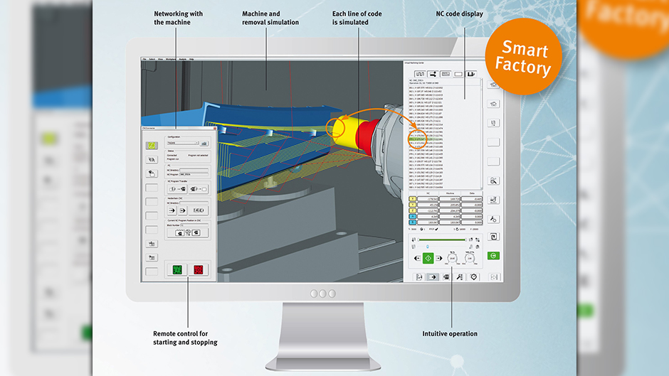

Rapid networking and excellent usability
The intuitive interface of the hyperMILL® VIRTUAL Machining Center is designed to deliver exceptional usability. CAM programmers, machine operators and manufacturing planners will master the new simulation technology very quickly, thanks to a user interface that has the look and feel of a real and familiar machine control system.
The hyperMILL® CONNECTED Machining module seamlessly integrates with the user interface. A single click of the mouse establishes a connection with the machine. Moreover, the integrated remote control feature makes it possible to configure machining parameters via a laptop.
