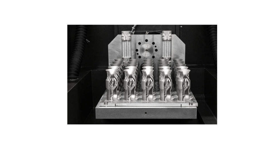

Accommodating parts up to 510mm x 510mm x 510mm (including the base plate) and up to 500kg in weight, the CUT AM 500 uses 0.2mm diameter wire to separate additively manufactured parts from the build platform at a maximum cutting speed of 300 mm2/m.
It delivers ±0.1mm accuracy and surface roughness of less than 6μm. This solution brings together horizontal wire orientation, an integrated basket to carefully catch separated parts and a rotary axis to create a robust process that supports the part, improves part handling, prevents damage to the part, and can be fully automated for increased productivity.
