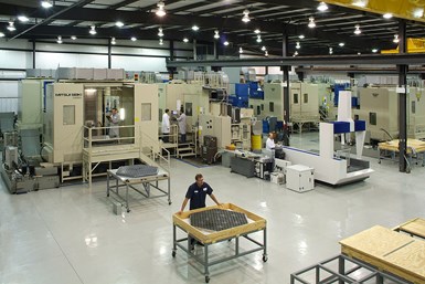

Axsys Technologies of Rocky Hill, Connecticut, won the job of machining the beryllium mirrors in September, 2003, and began delivering them in 2006. The final mirror was delivered for polishing in 2007, 14 years before the telescope launched. The company built a 20,000-foot climate-controlled facility to house the production line for the mirrors and immediately began researching machine tools for the job.
Axsys installed each Mitsui Seiki HMC on a meter-thick concrete pad surrounded by sand to prevent outside vibrations from interfering with machining. The toxic beryllium dust meant each machine to be equipped with dust management systems for worker safety. Photo Credit: Mitsui Seiki

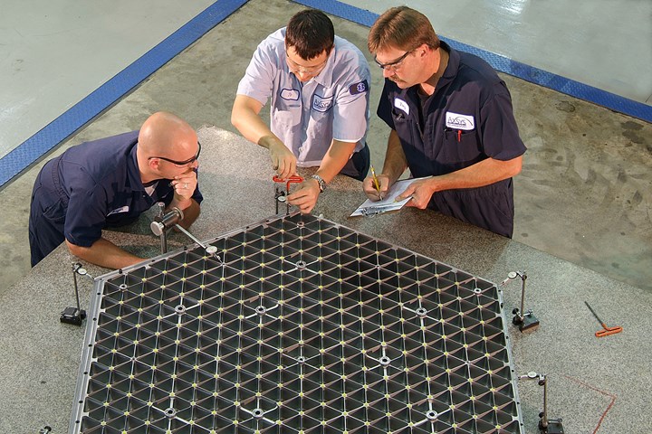

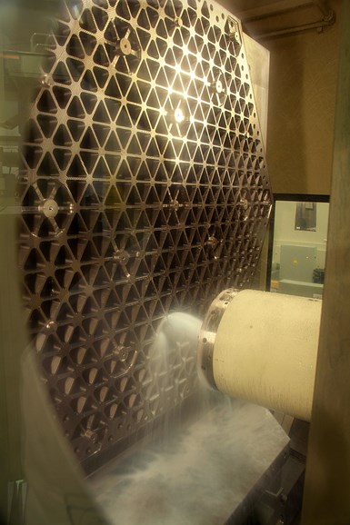

While the beryllium’s thermal stability made it ideal for the mirrors, the material is very expensive (each 750-pound billet cost $500,000), and the dust is a toxic safety hazard for workers. This meant that scrapped parts were unacceptable, and dust management was a necessity. Additionally, the mirrors required heavy machining, removing 670 pounds of material. The back of the mirror, where it would attach to mounts on the telescope, required the machining of 600 pockets with eight different rib structures ranging in thickness from 0.021 to 0.2 inches. On the side with the mirror finish, there was a ± 0.0002-inch tolerance, and there were three different mirror-segment types with different mirror geometries.
The mirrors required the removal of over 600 pounds of material, including the machining of 600 triangular pocket in the back. There are eight different rib structures, with holes drilled at intersections for mounting on the telescope. Photo Credit: Mitsui Seiki

The specific machine the company chose was the Mitsui Seiki HS6A HMC, which was modified to manage dust particles. Additionally, the company slightly reduced the Z-axis from 1,000 to 980 millimeters to accommodate the large billets. Each machine had a 20-ton bed and 11-ton column to reduce vibration and maintain precision. Axsys installed each machine in a concrete pad 1 meter-thick poured into the floor, isolating each pad in a bed of sand to prevent outside vibrations from disturbing the machining.

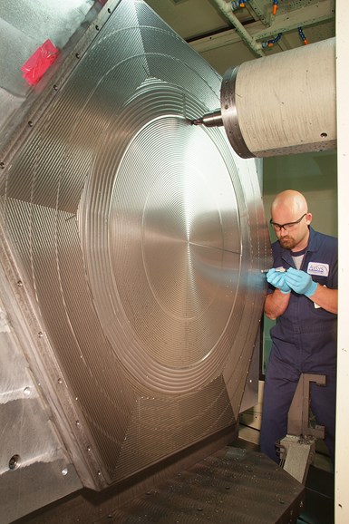

There were three mirror types with different curvatures, each of which was 1.5 meters across. The challenge of maintaining positional accuracy in three dimensions over that area and with a tolerance of 0.0002 inches necessitated a machine tool with Mitsui Seiki’s volumetric accuracy. Photo Credit: Mitsui Seiki
The HS6A had numerous advantages for these parts. First and foremost, it was large enough to accommodate the size of the part. Additionally, the machine is capable of volumetric positioning with an accuracy within a few microns over the entire work envelope. This level of precision is absolutely necessary to produce such large mirrors with distinct curvatures and a tolerance of ±0.0002 inches. Mitsui Seiki has a history of producing machines with exacting volumetric accuracy that enables this level of precision over a large area.
