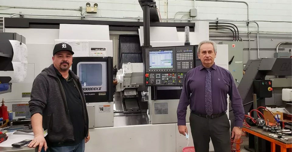

The shop was previously working with an older lathe that was still operating well but was limited on what parts could be produced on it. In summer 2019 the shop purchased an Okuma LB3000 EX II-MYW horizontal lathe from EMEC Machine Tools, Mississauga, Ont.
“We really wanted something that could do multitasking operations and cover a large range of families of our products,” said Glamcevski. “That’s why we chose the Okuma machine. It includes a double spindle so we do not have to use a bar feeder. That eliminates the need for the additional floor space and time of working and maintaining a bar feeder. There are so many different and new features of the machine that we are still learning how to best take advantage of them even today.”
Once the machine was installed, all operators were given as much training as possible. If there is a new feature or capability that the shop wants to use, Glamcevski said that they can easily call on EMEC or Okuma to come in to explain and train.
The shop is currently exploring whether it makes sense to bring in-house some of the part families that are subbed out. To do this, it needs to consider material type, tooling needs and specifications, how to prove out the process, prototyping, program development, and testing of the finished part for quality. If all these can be checked off, then the part can be made in-house. It is a process that they hope will make the shop more efficient while still maintaining the high standard of quality.
“The Okuma machine is perfect for small parts, especially ones that weigh less,” said Georgiev. “Most other machines are producing 18- to 42-in.-dia. parts, but on the Okuma we decided to machine our 10-in.-dia. part family of tensiometers. It is important for us to have this machine available when we need it. In our business, it is not a matter of having a part done in the next 15 minutes; we prioritize quality. One of the harshest environments for parts made of stainless steel and the like is in a steel mill. With nearly 48 per cent of the steel mills in the world using Kelk products, our customers expect longevity and quality from our products. With this machine, we are able to ensure that quality component for the small parts.”
The family of tensiometers produced on the horizontal lathe have unique profiles, especially the ones for steel and aluminum mills and process lines. These parts must be very precise and need to provide high accuracy to the controller of the mill. The Okuma machine allows for the shop to easily produce one of the 40 different profiles, with varying characteristics and outputs, with live tooling and greater programming flexibility. Another family product group that will be produced on the machine is the Accuspeed laser velocimeter. Some of these components need to be machined with very tight tolerances, which can be quite difficult if the part requires many different setups.
“The one thing that we’ve seen gains on with this machine is improved accuracy,” said Glamcevski. “We had an older lathe that was a little worn. The Okuma machine is new and accurate. The learning curve can be a bit of a challenge, especially with live tooling and double spindles, but you are really going to get that with any new machine. Right now I do not think we are using the machine to its full advantage, to be honest, but in time we will be closer to where we want to be in terms of maximizing the machine. There is a reason we manufacture the way we do. We have a process in place that aligns with the founder’s vision of the company, which places quality above all else. The machines we invest in and the way we do things ensure that when we put the Kelk name on our products, we can stand behind them.”
