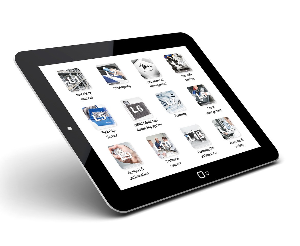

For over a year MAPAL has been offering its ‘Tool Management 4.0’ solution that utilises the open-cloud platform from c-Com GmbH, a wholly owned subsidiary of the MAPAL Group. The processes are digitised and displayed transparently using the c-Com SaaS (Software as a Service) solution. In addition to the benefits of classic tool management, such as 100% tool availability, resource conservation and reduced inventory costs, Tool Management 4.0 opens up completely new potentials for the customer.
Where individual lists with limited access were used in the past, the data is now available to every authorised person with Tool Management 4.0 access. It no longer has to be maintained in different systems, preventing data discontinuity. The individual projects are now being gradually changed over to Tool Management 4.0, depending on the agreement with the customer. The first projects are already in successful operation.
