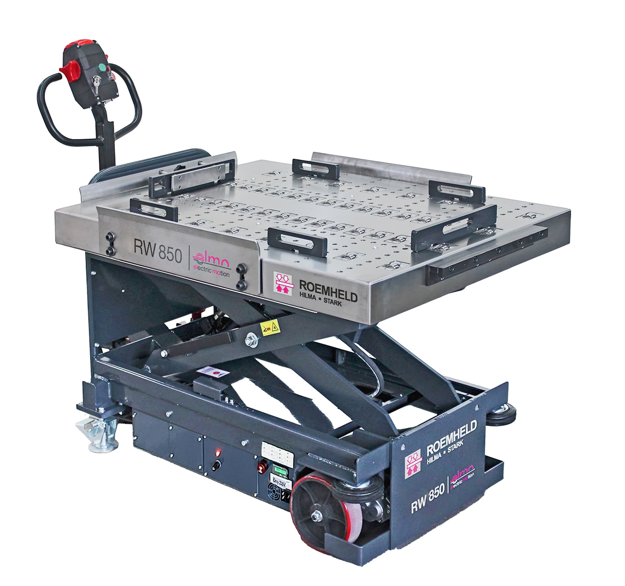

Roemheld will launch the Elmo RW 850, a compact addition to the company’s line of mould and die changing carts, designed for environments where space is at a premium. Unlike larger models in the range, the 850 variant is especially manoeuvrable. With its tight turning radius, it is able to negotiate narrow aisles and cramped production floors that often make changing injection moulds and punching dies arduous or logistically difficult.
Movement of the cart is electrically powered under manual control. What sets the Elmo apart is its integration of ergonomic safety measures and precision control. It features an electro-hydraulically actuated scissor lift with precise height adjustment and a table equipped with hydraulic ball bars, allowing near-frictionless positioning of tools weighing up to 850 kg. For security, the table has protection rails around the periphery and the ball inserts automatically lower during transport, ensuring the tool sits firmly on the table.

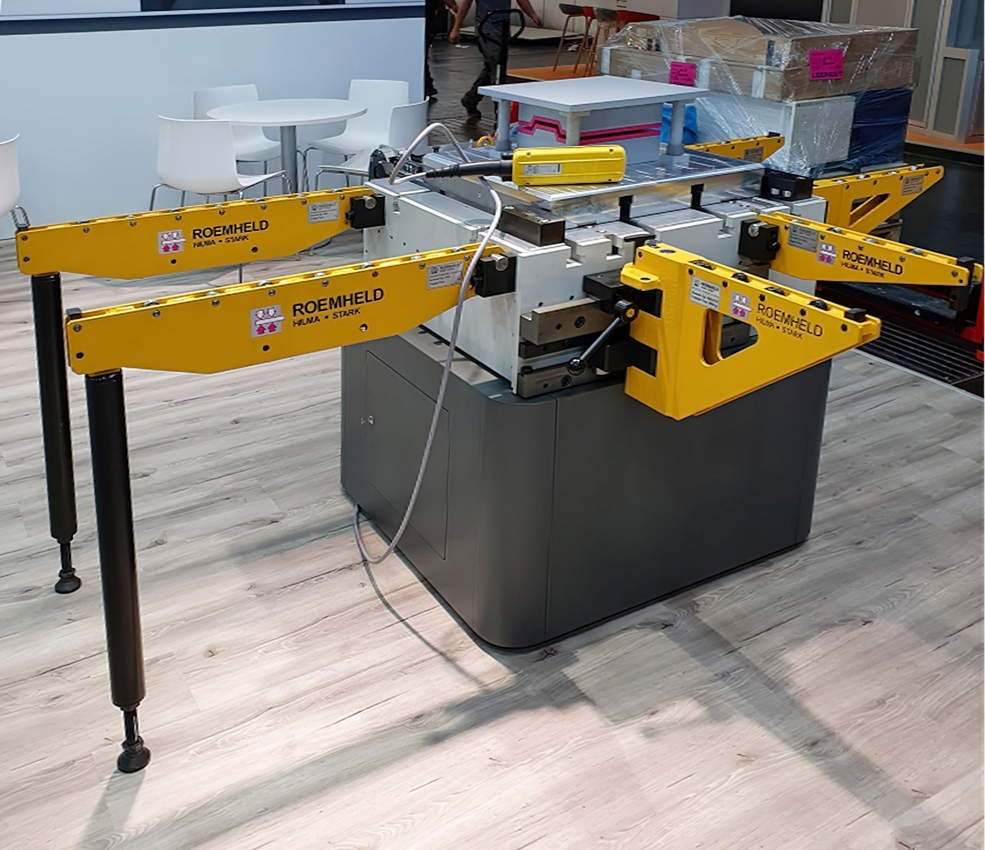

While Roemheld’s RW range is for entry-level mould and die changing, where the operator manually slides the tool onto the machine bed, its QDC (quick die change) range features integrated push-pull chain drives for medium to heavy tools. At the touch of a button, these systems grasp the tool and pull it into position, and push it out again after use, removing the need for physical effort from the operator.
An example from this range will be on the stand in the form of a station that can be loaded ergonomically with a tool from the front or from either side. All QDC systems enable manufacturers to handle smaller batch production more economically, while significantly reducing strain and injury risks.

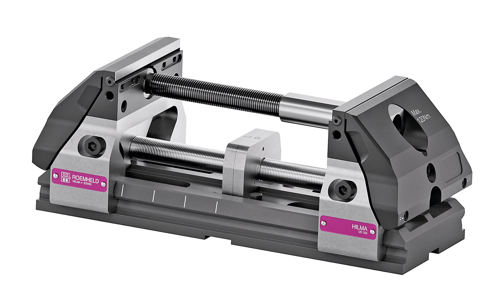

Making another appearance will be the Hilma.UC 125, a mechanically-operated, self-centring machine vice designed for high-precision 3- to 5-axis milling. The modular workholding station features a design that allows easy tool access from all sides, enabling the use of short cutters for increased accuracy.
The system utilises two individual jaws that travel simultaneously toward the centre to clamp workpieces with a force of up to 52 kN. Precision is maintained through a central bearing that ensures every component is located within ± 0.01 mm repeatability, while an active pull-down mechanism prevents the workpiece from lifting once secured.
The universal clamp (UC) is capable of accommodating a variety of prismatic and round geometries. Its modular concept includes numerous jaw options up to 125 mm wide and an opening that can be extended to 600 mm, which is among the largest available on the market.
To prevent base distortion, the vice employs separate tensioning and adjustment spindles so that clamping forces are not applied directly to the base. For mounting flexibility, the Hilma.UC 125 can be secured directly to a machining table or integrated into a zero-point clamping system using optional adapter plates.
