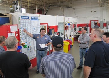

Today, a walking tour of Micron’s shop areas reveals all of the classic hallmarks of a company well along the lean journey. These include shadowboards for hand tools; posted checklists for setup procedures, machine maintenance and housekeeping items; standardized work guidelines; and several kanban stations.
However, Micron’s approach to lean is not entirely conventional. As a job shop/contract manufacturer, the organization has adopted its own interpretation and customized implementation of lean principles.
To summarize how Mr. Preston and Mr. Vermeesch explain it, Micron’s style of lean manufacturing is characterized by an emphasis on the importance of keeping things visual and reducing variability. By “visual,” they mean keeping vital details about daily production and routine procedures available at a glance. Individually and as a group, employees can easily see what needs to be done at that moment. For example, a dry-marker scheduling board is located in a central point in the shop near the hallway to the engineering offices and conference room. This board is updated in the morning before the daily “huddle” in which machinists, schedulers and engineers review jobs in progress, jobs next in line and other action items. The huddle (usually a 5- to 10-minute session held first thing every morning) is an opportunity for the team to share suggestions, advice, concerns, warnings and any other matters that benefit from positive, collective thinking.
The term visual, however, does not mean the shop does not rely on its computer network for communication and digital applications such as scheduling and shop control with its ERP software from JobBoss. “We use software tools where the automation and processing power make sense,” Mr. Vermeesch says. “Visual representations serve as a backup to digitally processed information available online.”
A number of other marker boards and notification stations are maintained throughout the shop, with several of the most important on the walls around the table in the conference room.
