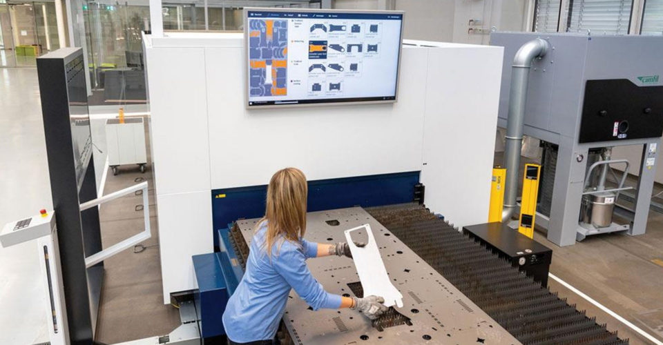

As an alternative to such an approach, TRUMPF has introduced a sorting guide system. Basically, the system comprises a camera on an arm at the back of the machine connected to a monitor that shows the operator the parts on the sheet. The system colour-codes the parts on the monitor to indicate which parts need to be kitted together.
“Using this, you can reliably remove parts and kit them as the system tells you to do so,” said Brett Thompson, sales engineer for TruLaser at TRUMPF Inc. “Even if you remove multiple parts at a time, it will indicate that they have been removed. And because all parts are highlighted based on what kit they are meant to be grouped with, it is easy to see on-screen if a part is missing because it has fallen out of the nest or is tilted in such a way that it might not otherwise be noticed.”
