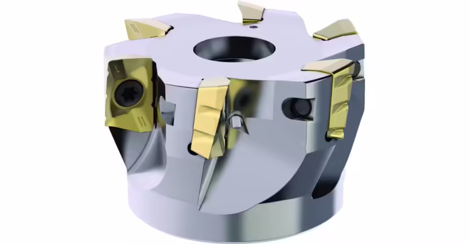

Seco Tools has launched the Turbo 12 and 18 chip splitter inserts, designed to enhance the performance of their Turbo cutters in both square shoulder and helical milling applications. These new inserts, available in five distinct grades, are engineered to reduce common machining challenges such as chatter, vibration, and excessive stress on cutting tools and equipment.
The Turbo 12 and 18 inserts feature innovative grooves on both cutting edges that effectively reduce chip size, which in turn lowers cutting forces. This functionality allows for higher cutting data and greater depth of cut without compromising the efficiency of the operation. By minimizing the size of the chips produced, these inserts mitigate the risk of chip jamming, thus improving process security and enabling more effective machining of deep pockets.
In addition to these performance improvements, the new chip splitter inserts also combat the chatter often encountered in long-reach applications. This results in longer tool life and improved surface finishes, making them an ideal choice for shops looking to optimize their milling processes and achieve better results with reduced downtime.
With their ability to handle demanding applications, the Turbo 12 and 18 chip splitter inserts from Seco are poised to provide manufacturers with reliable, efficient solutions for a wide range of milling operations, ensuring consistent, high-quality results.
