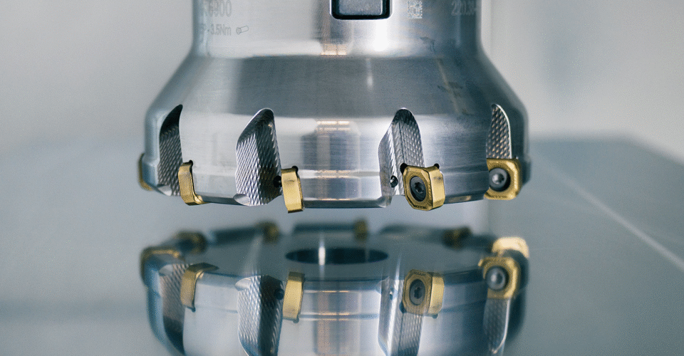

Seco Tools has unveiled its latest innovation in precision machining — the .38 Finishing Face Mill / SNFX1204 system — designed to deliver superior surface finishing with exceptional flexibility and control. The system features three distinct cutter variants: fixed pocket, hybrid, and adjustable, each tailored to meet varying requirements for accuracy, surface quality, and ease of use across different machining environments.
Developed for high-precision surface finishing, the .38 Finishing Face Mill system reflects Seco’s commitment to simplicity, performance, and adaptability. It offers manufacturers a complete solution for a range of finishing tasks, from cost-efficient general applications to ultra-precise surface machining in demanding industries. The system’s engineering excellence lies in its ability to balance operator convenience with technical precision, allowing manufacturers to achieve consistent, repeatable results with minimal setup time.
The system supports two types of inserts — one with an 88-degree lead angle and another with a 27-degree lead angle — providing flexibility for a wide range of milling operations. The 88-degree insert is designed for near-wall machining and applications that require precision close to component edges, while the 27-degree insert enables high-feed milling for open surfaces, improving productivity without compromising finish quality.
The Fixed Pocket Cutter (R220.38-….-SN-..SA) is ideal for operators seeking a reliable, setup-free tool. Its tilted screw design ensures optimal insert self-centering and delivers excellent runout accuracy between 4 and 15 microns. This makes it a practical and cost-efficient option for workshops aiming to reduce operator dependency and training time while maintaining consistent performance across shifts.
The Hybrid Cutter (R220.38-….-SN-..CSA) merges the simplicity of fixed pockets with the precision of adjustable ones, giving users the flexibility to adapt to varying surface finish requirements. In its standard configuration, it operates as a fixed pocket tool, while the adjustable cassettes can act as wiper inserts for improved finishing. This design strikes an ideal balance between versatility and control, ensuring enhanced surface results without introducing unnecessary setup complexity.
For applications that demand the highest levels of precision, the Adjustable Cutter (R220.38-….-SN-..HSA) provides full fine-tuning capability. It achieves near-perfect runout — as low as 0 to 2 microns — allowing users to meet the most stringent surface finish specifications. This variant is particularly suited for industries such as aerospace, die and mold, and high-performance automotive manufacturing, where flawless surface integrity is critical.
Overall, Seco’s .38 Finishing Face Mill system redefines what manufacturers can expect from a face milling tool. By combining ease of operation, flexibility in configuration, and superior surface precision, the system offers a complete solution for modern machining environments seeking efficiency without sacrificing quality.
