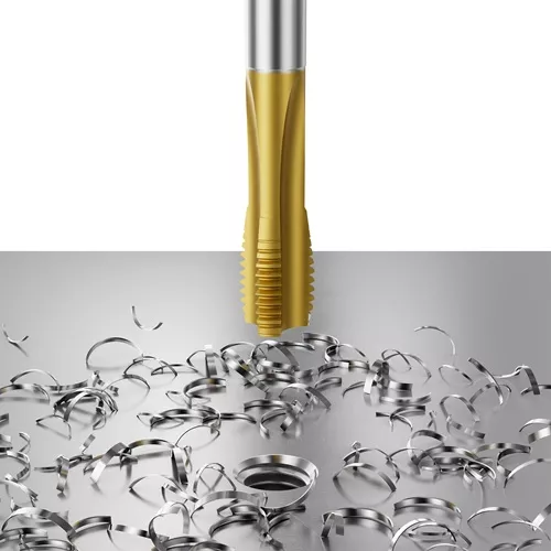

Sandvik Coromant has unveiled the CoroTap 100 with -PM geometry, a new generation of high-performance straight flute cut taps engineered specifically for ISO P materials. Designed to deliver uninterrupted precision threading, this tool family addresses common challenges in chip control and surface finish quality, helping manufacturers achieve smoother, more efficient production.
The CoroTap 100 -PM geometry features a refined chip-breaking design that effectively manages chip formation and evacuation during the tapping process. This innovation eliminates the need for manual chip removal, minimizing production interruptions and tool damage risks. The result is a more stable threading operation that enhances tool life, consistency, and overall productivity.
A key aspect of this tool’s engineering lies in its internal coolant capability. The design allows for efficient chip evacuation and ensures clean, high-quality surface finishes, particularly in blind holes where chip accumulation is a concern. For through-hole applications, Sandvik Coromant recommends using external coolant through collets or nozzles to maintain optimal cutting conditions and extend tool performance.
