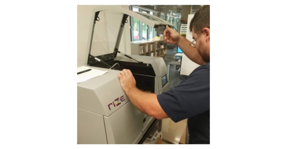

The Rize One 3D printer is so easy to learn and use, Andrew and NHF’s CNC users are running their Rize One 3D printer 24/7 in their office, producing an average of two parts per day for a variety of functional applications.
“I put Rize One right next to my desk, so I can use it all the time,” said Andrew Black, Engineering Manager at NHF. “It’s so easy, anyone can use it.”
