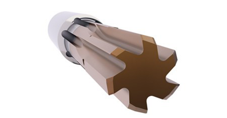

Seco Tools unveils its latest innovation, the Nanojet solid-carbide reamers, designed to revolutionize chip control through a unique through-coolant outlet for optimal chip evacuation. With this cutting-edge design, Seco aims to eliminate costly scrapped parts, chip jamming, and edge damage, ultimately enhancing safety, part quality, and tool longevity.
Addressing both blind and through bores, the Nanojet reamers from Seco offer unparalleled chip control and application stability. Engineered with a specialized design, these innovative tools deliver a precise stream of lubrication directly to the cutting zone, ensuring optimal chip evacuation and prolonging tool life. By maintaining cutting speeds and enhancing part quality, Seco’s Nanojet solid-carbide reamers contribute to overall production stability.
This versatile range of multi-flute reamers is available in eight grades and over 10 geometries, offering flexibility to meet diverse machining needs. Additionally, custom sizes and tolerances are available, ensuring compatibility with any precision toolholder. With tolerances ranging from 10 µm to 15 µm and surface finishes from Ra 0.2 µm to Ra 1.2 µm, these reamers uphold stringent quality standards. Seco meticulously inspects each Nanojet solid-carbide reamer, documenting its measured diameter to ensure consistent performance.
Seco’s Nanojet solid-carbide reamers are readily available in stock sizes and can be customized to diameters as small as 0.057″ (1.461 mm). Through the Seco MyDesign online tool configurator, shops can easily obtain customized tools while benefiting from the stability, reliability, and availability akin to commodity products.
