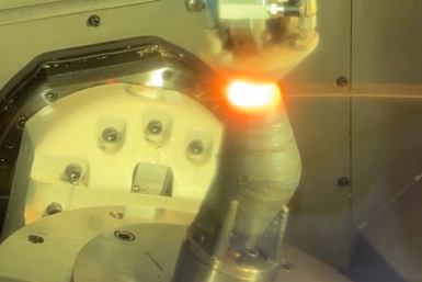

The term “hybrid” denotes a machine tool that goes beyond traditional capabilities, often integrating additive manufacturing (AM) with subtractive machining in a single unit. Though not yet pervasive in standard job shops, the hybrid machine tool presents a niche technology with diverse applications across various industries.
From afar, the hybrid machine appears remarkably versatile, allowing for both AM and machining in a single cycle. However, closer inspection reveals challenges, particularly in achieving process balance. Despite this, recent developments have expanded the machine’s utility.
One significant limitation is process imbalance, where one set of capabilities remains idle while another is in use, potentially impacting efficiency. Yet, applications like cladding and repair showcase the hybrid’s efficiency by balancing additive and machining times within a shared cycle.
Another consideration is the unfamiliarity of laser metal deposition and powder metal use in hybrid machines, posing a learning curve for many shops. However, the introduction of wire-fed deposition systems has simplified metal stock handling.
