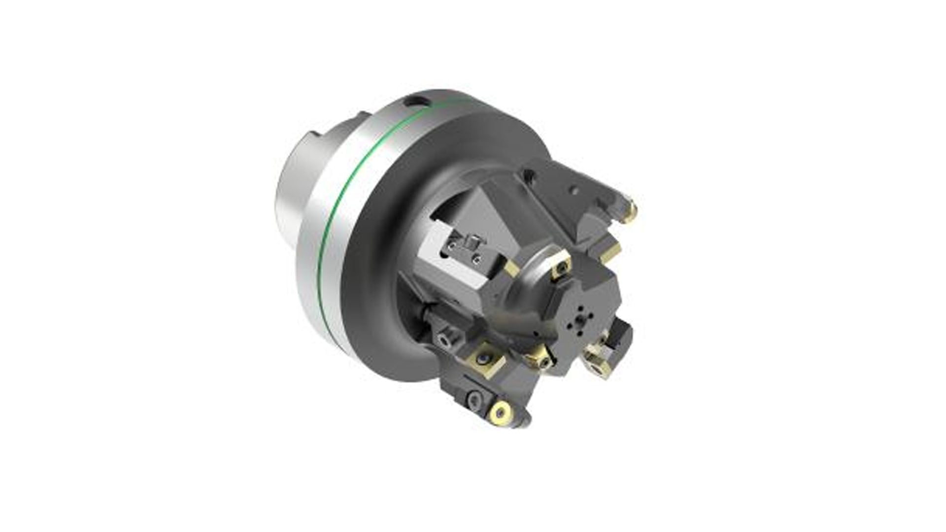

1. Complex boring tool with ISO indexable inserts
It is necessary to machine the V band on every turbocharger. Along with the material properties, an interrupted cut is often a challenge here during pre-machining. MAPAL relies on a complex boring tool with ISO indexable inserts to pre-machine the V band as well as to pre-machine the internal contour of the turbine. The tool therefore machines internally and externally simultaneously. Multiple steps are machined. The tool operates counter-clockwise to transport the chips out of the component and to prevent damage to the internal contour of the turbine.Machining example:
Material: 1.4837| Cooling: MQL | Diameter: 49; 70.5; 73; 90 mm; chamfer 10° | Cutting speed: 70 m/min | Feed: 0.4 mm | Tool life: 75 parts
