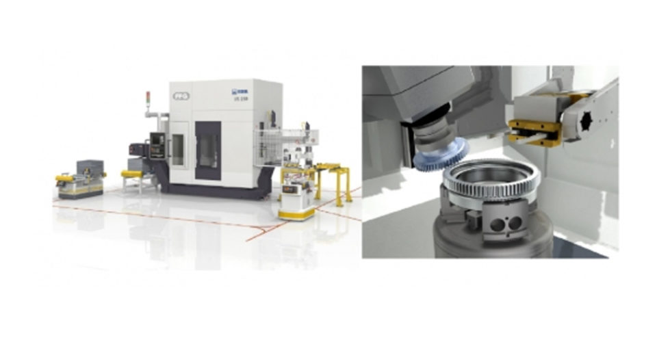

The gear skiving machine MODUL VS 250 complements the successful product range of gear hobbing machines with the “Power Skiving” technology. The process and production advantages described above are primarily aimed at suppliers and production plants in the automotive industry, regardless of the drive concept with combustion engine or e-drive. However, the machine with its tool magazine is also suitable for more complex workpiece assortments in small and medium volume production.
The 30 kW main spindle of the VS 250 allows a tool speed of 8,000 rpm, the workpiece spindle offers a maximum speed of 4,000 rpm. The tool magazine, already included in the basic equipment, has 6 pockets for tools with an HSK 100 interface.
  • Maximum producible module m = 6
  • Maximum workpiece diameter = 250 mm
  • Automation through integrated loading gantry or external robot
  • Possibility of mirrored design for integration into existing production lines or when replacing existing machines
