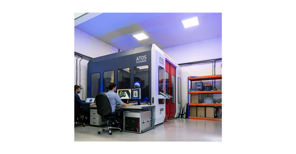

To meet the standard in Nadcap AC7130/4, Physical Digital has undertaken business and process improvements, aligned their 3D measurement service with aerospace requirements and invested heavily in the latest equipment by introducing, for example, an ATOS ScanBox automated inspection cell and a high-resolution ATOS Triple Scan sensor.
Daniel Lainchbury, Engineering Manager from Physical Digital, regards GOM as a great partner of measurement in the gas turbine industry. “Nadcap has a high standard on accuracy, traceability and repeatability, and GOM’s system is almost the only system that can be compliant to the standard,” he said. GOM’s automated system ATOS ScanBox has played a key role for Physical Digital to win the accreditation since customers can get very stable, repeatable measurements for statistical data analysis.
