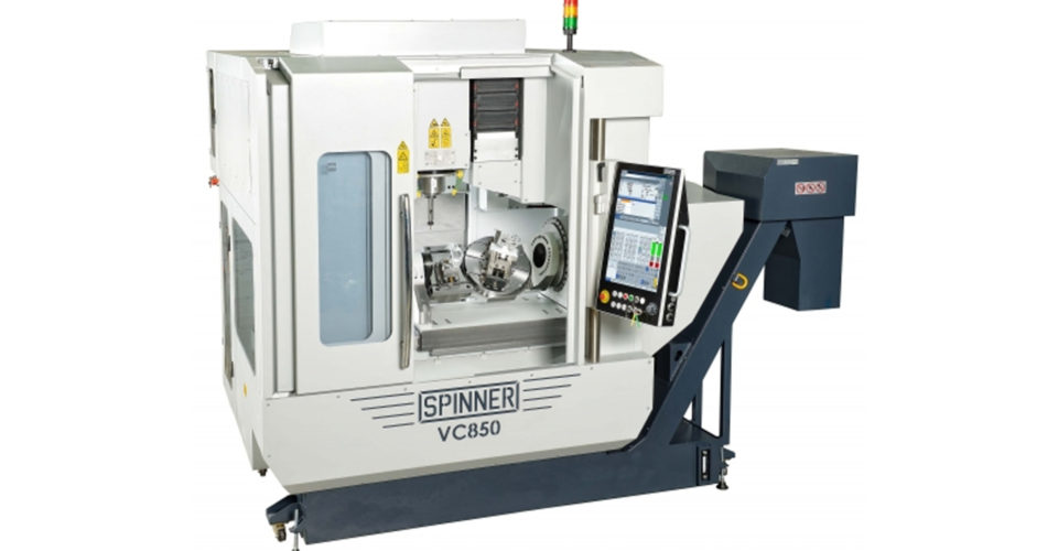

Featuring a generous working volume of 815 x 510 x 510 mm in a small 2.5 x 1.8 metre footprint on the shop floor, the new VC850-5A is the latest prismatic metalcutting machine to be launched by German manufacturer Spinner Werkzeugmaschinenfabrik, whose factory is located near Munich. The 5-axis, vertical-spindle machining centre, which is configured with a +110 / -5 degree swivelling trunnion carrying the rotary table, is available in the UK and Ireland through sole sales and service agent Whitehouse Machine Tools, Kenilworth.
Managing director Tim Whitehouse commented, “This is a top-end machine with robust rotary axes, which are normally the weak point in 5-axis machining. They are driven by a new planetary gear train and are fitted with absolute rotary scales instead of incremental encoder feedback.
“We are also impressed by the additional clamping plate beside the table that allows Op20 as well as Op10 to be programmed into a single cycle for one-hit machining. The option of a rotary hydraulic supply for automatic workpiece clamping is a further benefit, as it introduces the possibility of automation for long periods of unattended production.”
The 5-tonne machine has an FEM-optimised, cast construction that provides a high level of rigidity and vibration damping for elevated cutting performance and high standards of surface finish on machined components up to 200 kg. Further advantages are that tool life is extended and accuracy of machining is enhanced.
Part of the reason for the machine’s compactness is the patented method for protecting the saddle’s Y-axis guideway from swarf and coolant ingress using a single wiper system, eliminating the need for a telescopic cover. The depth of the machine is consequently shorter, leading to a 30 per cent reduction in the area needed for installation. The X-axis guideway also has a single wiper, allowing the table to move to the extremes to simplify automated loading and unloading from the sides.
Powerful, high-speed spindle options are 12,000 rpm SK40 / BT40 or 18,000 rpm HSK63, both rated at approximately 18 kW and offering 86 and 57 Nm of torque respectively. They are served by a 32-pocket tool magazine, although a 48-station version is available. Rapid traverse in all linear axes is 40 m/min to minimise non-cutting times.
High pressure coolant delivery at 22 or 70 bar may be specified to assist chipbreaking when cutting difficult alloys and to encourage swarf evacuation, which is in any case assisted by two spiral augers feeding the chip conveyor.
Further choices are in-cycle workpiece and tool measurement, mist extraction, various tooling packages, and linear scales to replace the large-diameter ballscrews in the orthogonal axes, providing absolute positional feedback to match that of the rotary axes.
