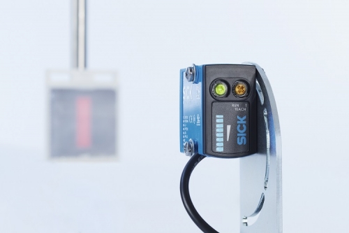

The RAY10 and RAY26 Reflex Array sensors can detect slices only a few millimeters high. Flat objects are reliably detected despite conveyor vibrations The RAY10 and RAY26 Reflex Array sensors are effective detection solutions for objects as fine as a letter
RAY10 and RAY26 are the names of the new SICK Reflex Array product families. The sensors work with a 2D light strip that allows them to reliably detect flat objects despite possible vibrations of the conveyor. This saves you up to 50% of the time and installation costs associated with photoelectric barrier solutions. The compact case of the RAY10 and the high performance of the RAY26 make it possible to respond to a broad spectrum of application including the detection of objects with a thickness of between 3 and 10 millimeters. They offer great mounting flexibility for all applications with integration constraints. In the CEP centers and distribution centers, the RAY10 and RAY26 proved to be reliable detection solutions,
The 2D light beam of the RAY10 and RAY26 is also perfectly suited to the detection of pallets of different heights, the detection of perforated objects and the detection of flat objects in front of weighing or labeling systems in intra-logistics. Indeed, the use of a standard photoelectric sensor with a round light beam causes multiple switching for these critical objects.
RAY10: Particularly compact light band photocell for edge detection
The RAY10 Reflex Array sensor is a space-saving solution designed for use in a limited mounting space. Installation is greatly facilitated by the quality of the light beam and the integrated alignment aid. With a detection height of 25 millimeters, the RAY10 detects objects with a minimum height of 5 millimeters, with a response time of only 0.5 ms. This means that the sensor provides reliable detection even at high speeds. Thus the production rate is guaranteed. This makes it an ideal solution in terms of value for money in this format.
RAY26: Optimum and reliable performance, even for the finest objects with varying thicknesses.
The RAY26 sensor operates at a detection height of 55 millimeters and, depending on the sensor version, can detect objects between 3 and 10 millimeters in height. Thanks to the selection of the object size and the removal function of the conveyor belt, the sensor settings can be adapted quickly and flexibly to the objects to be detected and the environment (conveyor belt) via the IO Link during commissioning and operation. This significantly reduces time-consuming local manual intervention and maximizes the availability and productivity of the process and installation. The integration of the RAY26 sensor is also facilitated by the quality of the PinPoint LED. In the end, thanks to its features,
