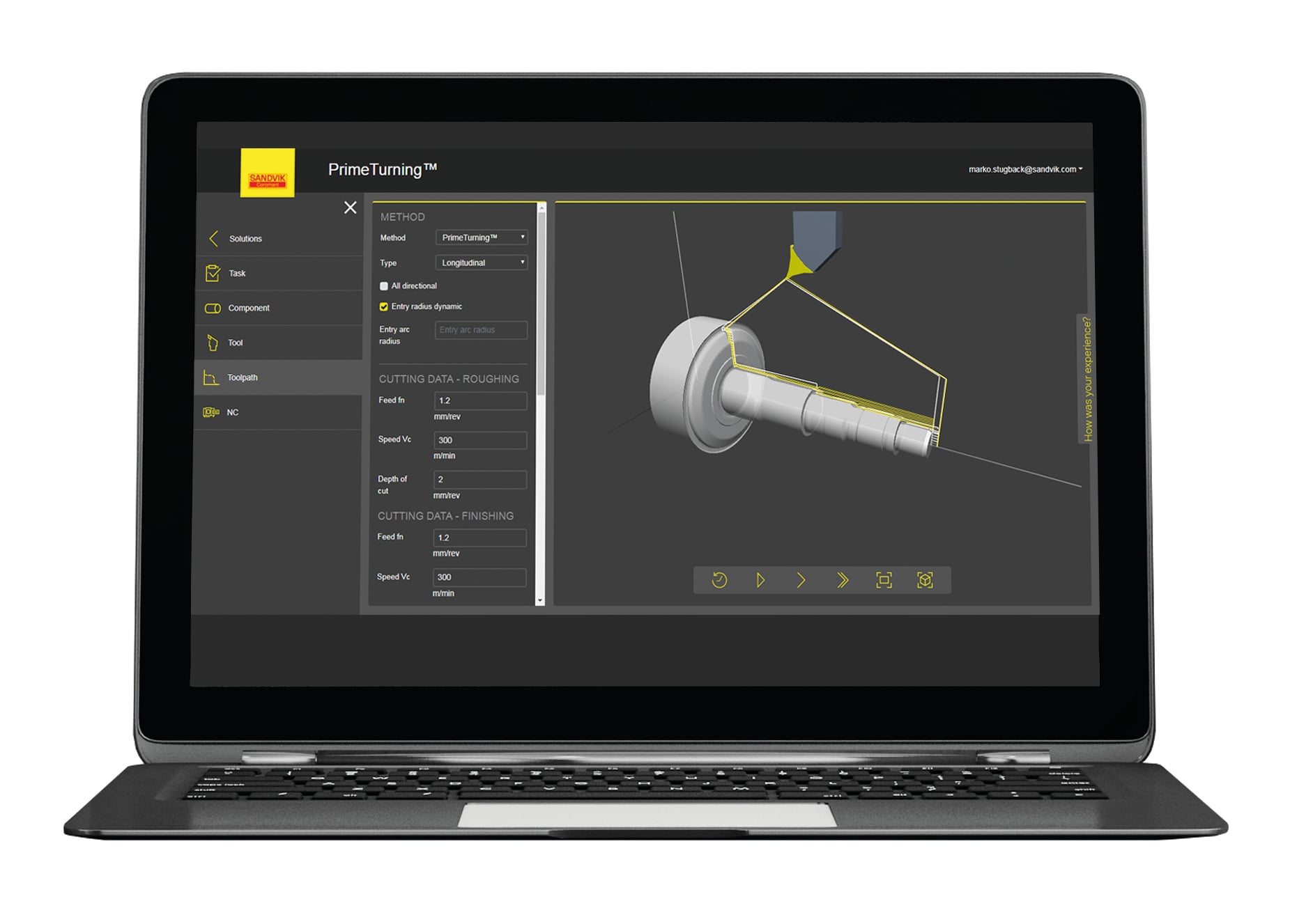

A key new feature is an improved and intuitive interface for machinists who don’t have CAM software with PrimeTurning™ support or those doing shopfloor programming, with the option of operating on desktops or mobile devices. The user is able to generate NC code in few quick and easy steps. After the user specifies the operation, machine parameters, workpiece details and material information, the software automatically recommends the right tools to use along with the cutting data. The operator can simply use the suggested solution or alter parameters to get customised results.
Before creating the final NC code, the PrimeTurning™ tool path software enables the user to run a simulation to verify no collisions and change any parameters as required, then generate a new program within seconds and run another simulation until the user is satisfied enough to produce the correct code. The software enables the user to stop anywhere they like in the process, running a simulation block by block or going back into the code if preferred.
